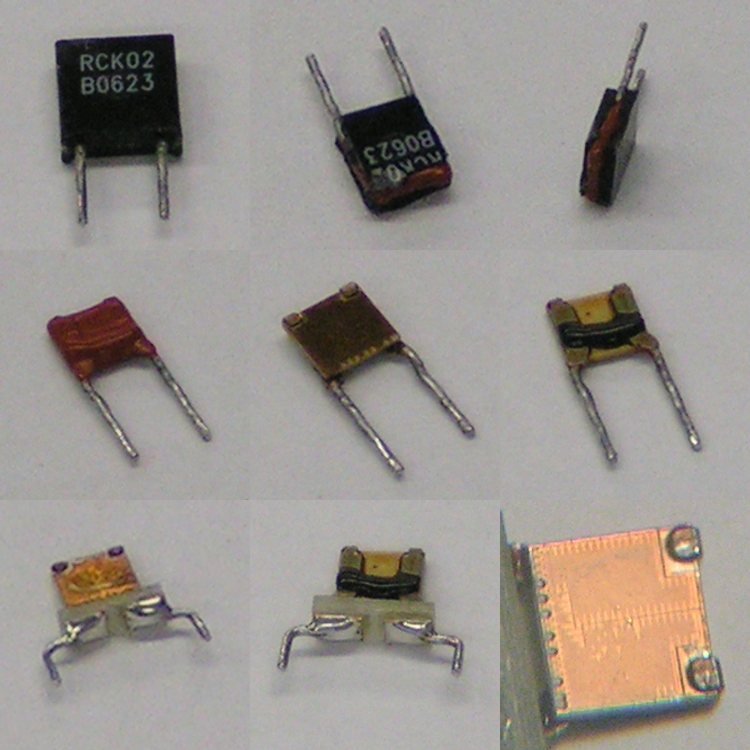

This doesn't mean it can't be improved further. Just yesterday I decided to remove the housings of some S102 bulk metal foil resistors, after reading some reviews of so called naked bulk metal foil resistors (bulk metal foil resistive element without housing).
I added a picture showing this step-by step dismantling of a Vishay S102.
1) The original S102 bulk metal foil resistor
2) Sides carefully cut away using a pair of sharp side cutters.
3) Side view, showing the resistive element inside.
4) Black housing removed, the brown protective coating is probably silicone rubber.
5) Protective coating removed (peals off very easily).
6) Rear view, the black line is glue, stabilizing the wires.
7) Small CNC milled PCB soldered to the resistive element for better stabilization.
8) Rear view.
9) Close-up of the resistive element. It consists of a maze of thin traces, forming multiple mobius loops (non inductive). The small dark spots on the left are the links evaporated by a laser, required for close tolerance tuning. Each link short-circuits a specific resistance value, when evaporated, this resistor value is added in series with the main resistor. By evaporating specific links, fine tuning up to 0.01% can be achieved. The two large darker spots on the right are the connections between wires and foil.
All parts are non-magnetic, verified this with a strong magnet, this is also desirable for Audiophile resistors.
I didn't expect any improvement at all, it's just a housing...... Well first listening tests suggested that I replaced the bulk metal foils with completely different, superior sounding resistors.
My best guess is that this might be caused by thermal issues.
