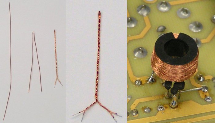

I think that I have already seen yours Cu resistors in this thread, but I can't remember how they are actually build. So, could you (once again) explain how to build them with all the math (and images, if there is any), thank you?
post #1954
Attached photographs, left mobius loop construction, center, twin non-inductive resistor (two mobius loops twisted together), right a practical twin non-inductive resistor used in the DI4T. Bobbins are available from Farnell.
Is that your order of preference for I/V resistor type?
No they are just in alphabetical order.
I am very pleased with the modified S102 resistors (housing removed and the black glue trace at the back of the resistive element interrupted). The Vishay VMF475-VSH1 resistors, supplied by Percy Audio are also very good performers, these seem to have a yellow epoxy coating.

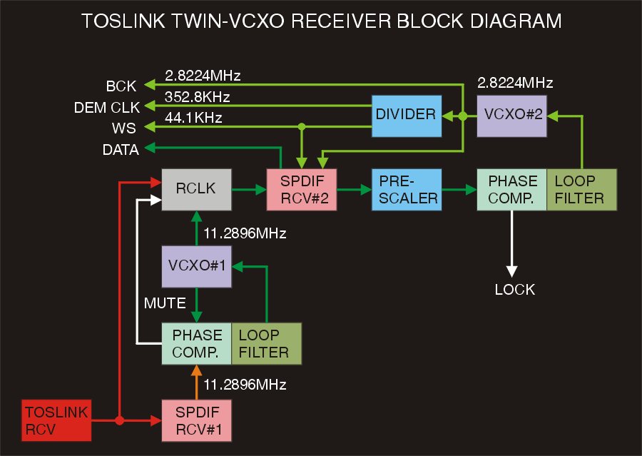

This doesn't happen when using the AE module, and disabling volume control (check box in iTunes). The AE module provides consistent better sound quality when compared to my iMac on-board USB and mini-Toslink interfaces. It also matches the sound quality from my reference CD player with Toslink output.
The connected DI4T uses an advanced jitter blocking system, the Toslink twin-VCXO receiver. I added a block diagram of this system. When testing USB sources I use a USB to Toslink converter, based on a PCM2706.
There are no audible differences when connecting sources with different jitter amplitude and spectrum. It makes no difference if I use a 1 meter interlink or a 10 meter clear plastic interlink. Sound quality doesn't even change when I add an optical repeater and extend the clear-plastic interlink to 20 meters.
