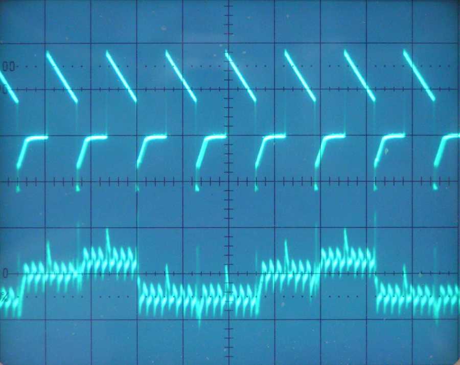

Hi Sandor,
One more thing, the DEM clock signal oscillogram shows significant amplitude jitter, this could indicate a crosstalk or power supply issue.
The DEM clock amplitude should be constant with only very small amplitude fluctuations.
I attached an oscillogram showing the DEM clock, and the active divider output (decoupling capacitor removed), observe the HF noise that needs to be filtered out by these decoupling caps.
The steps are the tolerances between passive dividers that need to be averaged. On the oscillogram two are closely matched, the remaining two are not. Note that BCK (2.8224 MHz) is present at the active divider outputs as well.
The presence of this step signal indicates that the DEM clock is functional, and the TDA1541A internal shift-registers receive a valid DEM clock signal.
ecdesign,
thank you very much.
I have tested the DC supply at pin 9 of the 74LS161: about 4,6 V. Supply is provided by a TL431 shunt regulator programmed to output 5V, so voltage drop across the series resistor is too high.
I'll also try series resistor at DEM clock output and at spdif receiver output, as you suggest.
Decoupling caps are very small SMD polypropylene 100nF 16V. On pins 13 and 18 the SMD cap is paralleled with a small 1uF 20V polyester cap. All caps are directly soldered under the pins with the shortest possible route to AGND.
What is the best pin to test the active divider output?
Is it worthy to substitutute the 74LS161 with the suggested 74HC161?
I will report after modding.
Best regards.
Paul

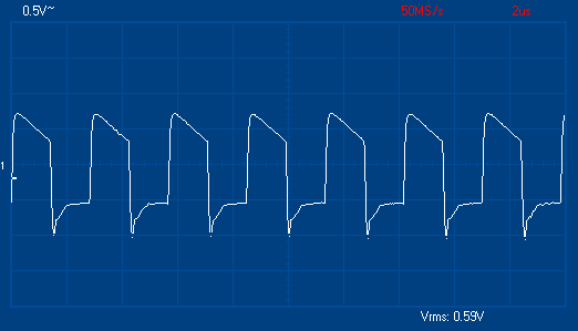

On DEM reclocking again
Hello,
I have now dedicated a single shunt regulator (TL431) to the supply of the 74LS161 (no HC found yet...). But I have found that the amplitude jitter was due to a too low level of the signal injected into pin 16 of the TDA1541A. Previously the signal was tapped from a 680 ohm (at +5V) /330 ohm divider. Now I have substituted the 330 ohm resistor with a 820 ohm one. Now the signal seems OK. Please look at the attached image. Listening response is also positive. Sound is clean as without the DEM reclocking, but with a better focus.
Ecdesign's DEM reclocker is very simple but very effective.
Paul
P.S. The DEM clock has now an amplitude of 1.8 Vpp - 0.6 Vrms. Is this enough to drive the internal oscillator of the TDA1541A?

Hi Sandor,
680 / 330 Ohm should provide approx. 1.63 Vpp @ 5V
680 / 820 Ohm should provide approx. 2.73 Vpp @ 5V
If your measurement (1.8 Vpp) is correct, your 74LS164 only outputs approx. 3.3 Vpp, this is the typical "1" output voltage level noted in the 74LS164 datasheet. The 74HC164 should be able to provide output voltages close to VCC.
1.8 Vpp is enough to drive (overrule) the internal DEM clock oscillator. Correct DEM clock operation can be verified by disconnecting one of the active divider decoupling capacitors, and check if there is a step pattern visible that runs in sync with the DEM clock (post #2021).

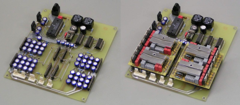

Hi MGH,
bugs? No, the DI4T prototype performs much better than expected.
The main problem is lack of time. I have a lot of other projects to complete, so the time I can spend on DAC development is limited.
The DI4T uses existing DA1541A, DI8PS, TUBEDIF and TUBEPS modules, some had to be modified slightly. The new modules are the DI4 mainboard, and the optional SPDIF cleaner. I attached some photographs of the new DI4 mainboard.
The mains filters aren't placed on the wrong PCB, they are required for both, passive LC power supply and loop filter.
The local electrolytic capacitor clusters are used to provide peak currents to the DAC modules, preventing long power supply paths.
The complicated timing chain is gone, only two chips are required now. The third chip is for both WS & DEM clock generation. Both phase comparator and pre-scaler chips are mounted underneath the CS8412 socket for shortest possible connections.The 4 UHS clock buffers are mounted on the solder side.
The resistors and wire links, placed on turned pin sockets aren't for experimenting. I put them there to minimize crosstalk.
The low-jitter VCXO master clock is placed on a small PCB. There is no reclocker, the VCXO directly feeds the DAC chips through two UHS clock buffers. The master clock is placed close to the DAC chips, in order to minimize timing jitter.
I still have to add one 5-way connector for the optional SPDIF cleaner module, and partially re-route the PCB for the CS8416.
