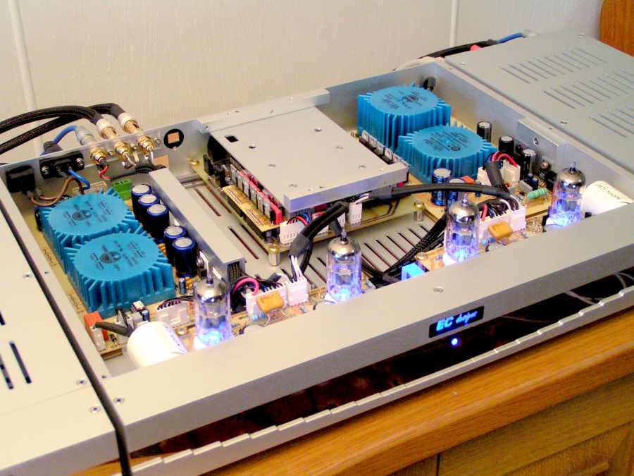

Hi MGH,
I used 8 x TDA1541A with the new design, 4 x interpolation produced a more fluent realistic sound.
No I didn't cut the DI8 mainboard in half. I just left-out 6 modules (4 x DA1541A, and 2 x IVDIF), and performed some PCB modding. So it's possible to build a DI4T using existing PCBs.
This weekend I designed a DI4 mainboard as well, PCB lay-out is basically ready. the PCB measures 5.27" (134 mm) x 6.26" (159 mm).
The DI4 mainboard will contain the following:
- 5V power supplies with LC filters (54mH / 0.1F).
- 4 x DA1541A module.
- Local power supply decoupling capacitor banks for DA1541A modules (48 electr. caps in total).
- Both TOSLINK & SPDIF receiver modules.
- VCXO.
- 4 x clock buffer
- DEM clock generation.
- WS generation.
- MCLK prescaler.
- Phase discriminator.
- Loop filter with integrated LC filter (54mH / 0.022F) for VCXO.
- Timing circuit (4 x interpolation).
- VCXO lock indicator circuit.
The DI4 mainboard only requires -10, -20, and +10V (one 8-way connector)
TOSLINK receiver is integrated on the PCB, no extra connectors
Output for LED indicators (one 4-way connector)
DAC current outputs for L, NL, R and NR (two 3-way connectors).
Now the the following PCBs would be required to build the new DI4T:
1 x DI4MAIN.
4 x DA1541A.
1 x DI8PS.
1 x TUBEPS.
2 x TUBEDIF.

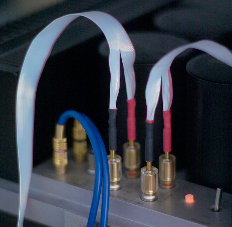

Hi -ecdesigns-,
Sorry for the very late reply: Post #1981.
Thanks for your explanations and advices.
I've been busy at work and only had time to improve some of my DIY interconnects. I have to upgrade all my internal hookup wires to Litz type. Perhaps I'd also use it for power supply duties...

Hi maxlorenz,
I can start listening to all my CD recordings again .... The DI4 main board is ready, and it sounds pretty good, much better than the DI4T prototype setup.
I attached a photograph of my DI8M reference DAC that has been converted into a DI4T. It's running on cryogenic treated tubes as well.
The DI4 main board contains all circuits listed in post #1982, and measures only 5.27" (134 mm) x 6.26" (159 mm).
I use TOSLINK exclusively now, the TOSLINK receiver is soldered directly to the DI4 main board. There is a lot more space in the DI8M housing now. The copper wire passive I/V resistors are soldered directly to the input tube socket. The DAC currents are transported through Van Damme OFC studio patch cable.
Clock distribution path on the DI4T module is very short now, 4 UHS clock buffers are used. Both master clock and clock buffers run on a clean power supply (comparable to a battery supply). Passive low-pass filters are used to isolate both VCXO and clock buffers from (power supply) noise.
Interference with other signals is minimized by using wire bridges / resistors that extend approx. 5mm above the PCB surface, and by keeping interference signals as far away from the BCK signal as possible. I even used an attenuator after the TOSLINK receiver to reduce crosstalk.
BCK is a clean square wave with 50% duty cycle, no reclocking is used. The blue LED on the front panel now indicates VCXO lock.
I use Audyn plus coupling caps with silvered mica bypass. The output attenuator is now gone, if my calculations are correct, output impedance of the twin cathode follower (ECC82) is approx. (rp/(mu+1))/2 = (7700/(17+1))/2 = 214 Ohms.

maxlorenz said:I feel amazed that wire is so important
Me too.
Don't look at the cinch...
Speaker cable is a ribbon with 42 x solid silverplated wire in teflon.
maxlorenz said:I bet your DIY I/V resistor would sound stellar with OCC copper.
Manganin ?
Interlinks & passive I/V resistors
Hi Bernhard,
The use of silver-plated copper wire only makes sense for HF applications where the skin effect occurs. When used for demanding (LF) audio applications, pure silver wire should be used.
Speaker interlinks have to pass both large (peak) ac currents, and low level currents at the same time. It's important to prevent large (peak) ac currents to mask the low level currents. Noise increases with increased (ac) current, this basically means that resolution is reduced (masking of low level ac currents) as current increases.
On the other hand, the (active) volume control masks resolution at low volume settings. So basically it's quite difficult to achieve high resolution at all.
One effective way to reduce the masking of low level currents, is splitting-up the high (peak) current in multiple smaller currents, using multiple insulated wires. Both current and noise in each wire will now be significantly reduced, so low level details can surface.
Other problem is the (alternating) magnetic field that is generated around each separate wire. If problems occur here, resolution might still be reduced as a result of local electromagnetic field fluctuations between the multiple wires. It seems best to have one (alternating) magnetic field among all wires. This can be achieved with litz wire (wires twisted together).
So I use litz wire for interlinks exclusively, not because of the better HF properties, or lower DC resistance, but because of the ability of these interlinks to preserve low level detail.
