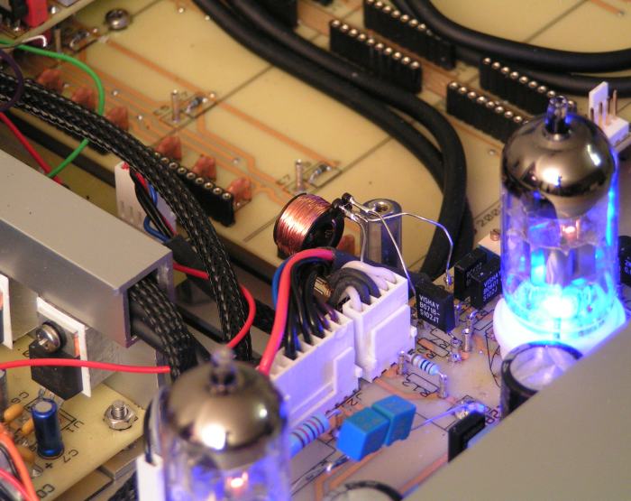

Hi folks.
I'd just like to share my findings on replacing Rref on a 1543.
I also put a 0,1uf BG-NX in parallel to Rref as mentioned by Doede.
DDDAC stock was a 120R type per 12 DACs.
I now replaced it with one 60R Econistor 0.01% from Rhopoints
for 24Dacs.
A bit of background: all my stacked DACs (2*12) are connected pin-by-pin via one single silver-wire to improve the signal path of multiple soldering joints from top to bottom of the tower.
My outputs are also taken off the middle of the towers with silver wires to get a close to symmetric wiring, when connecting the different DAC boards.
Otherwise, using the standard DDDAC connections, from the top of one tower to the other towers I/V-resistor you'd face almost 6- 7inches difference and 15 soldering joints.
The new Rref and my I/V-Rs are now directly connected to my star ground.
Now what happend: To make it short - A lot. 😀 Definetly more compared to replacing the Riken against the Econistors as I/V-R.
The sound improved in all aspects again. Most impressive were the
sudden added 3dimensionality, dynamics and resolution. A grand piano sounds even more realistic now. And so on - And so on.
It seems that the Rrefs have been a kind of bottleneck all the time.
But it's obvious, isn't it - It's the current for I/V-R which runs through these Rrefs.
I just can recommend to all the DDDACers ( or 1543DACers) around here. Place your order today! This was just a 5 pound tweak. 😉
"100% sound quality" is quite a relative term, isn't it. 😉 The race goes on.
It's fun to be around here folks!
Cheers

Rref:
Dear John, what if we connect a small inductor in series with Rref instead of a cap in parallel?
TeddyReg:
Putting a TeddyReg on DDDAC's Tower made the same kind of improvement in sound that it made on DI16 DAC circuit: softer, more elegant, more extended and refined. The LT1085 based Te ddyReg fell from 8,45 to 7,6V though...I'll play with some R to improve it. I can't say I hear something bad from this.
I'll try to add a TeddyReg for the 15V output section of the DI16 this week, plus a secret tweak 😉
M
TeddyReg:
M

Hi maxlorenz,
Yes this might work. You could also try a JFET constant current source instead of a reference current resistor (DDDAC). However, I got best results wit VREF pins unconnected, using a clean external 2.5V reference voltage.
The Teddyreg caused a voltage drop, this makes it difficult to say if the improvement was caused by a voltage drop or reduced ripple current, or perhaps both.
Perhaps the voltage drop could be reduced by using a MOSFET or JFET to drive the transistor, or just use a suitable N-channel power MOSFET. The transistor puts a load on the filter, it results in a voltage drop at the output of the filter, this then reflects at the Teddyreg output.
Before drawing conclusions, also make sure the USB interface (still) provides bit-perfect playback. My iMac is no longer capable of providing bit-perfect playback (USB & TOSLINK) after recent software updates. This illustrates how critical computer-based digital audio playback is.
I am now using TOSLINK with the Apple airport express module instead.
It does provide bit-perfect playback because it uses fixed dedicated hardware to generate the SPDIF stream, and receives data with full error correction from the server (no real-time audio stream). TOSLINK also provides perfect galvanic insulation.

Well this is diyAudio, why not make your own copper wire resistors like I did?
You need some thin lacquered copper wire, and a coil former. I used laquered copper wire from a relay with 230V coil voltage.
I posted it before, but here is how to make a NON-inductive copper wire resistor:
Calculate the total length you need (Ohms/meter + desired resistor value). Next cut the copper wire to calculated length, plus some extra for tolerances. Then fold the wire at the half of the length, carefully twist it together (hand drill), then carefully detach it from the hand drill and release the tension (otherwise the wires get curled-up, and you can start all over again). Then wind it on a coil former. Now shorten the wires to achieve exact resistor value. Finally solder the wires to the pins on the coil former.
The attached photograph shows a twin non-inductive copper wire resistor (2 x 39R). It's a twin mobius loop, wound on a standard coil former. It took 2 x 17 meters of thin copper wire to construct it. The center connection is common (GND).
The TDA1541A output currents were transported to the I/V resistors (placed close to the input tube), using Van-Damme OFC studio patch cable.
