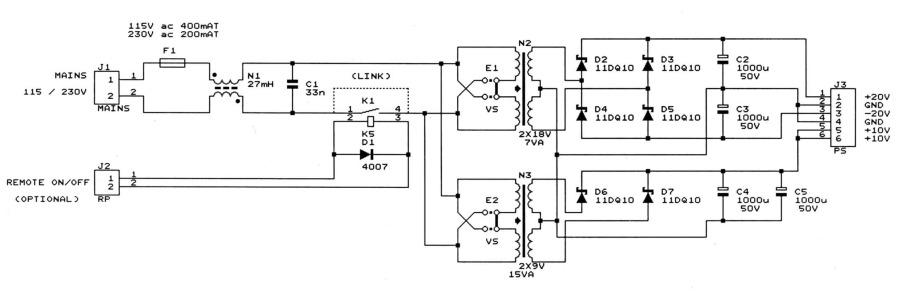

Dear -ecdesigns-,
While I admire your intellectual restlessness 🙂 I must declare that I am in mood different from the digital tweaker, now.
In fact I am so delighted by the music I'm getting through my modded DI16 that I only want to build non-digital stuff 😀 ...some amps, my last horn speakers and some DIY interconnects (same as yours but with OCC (mono-crystal ) copper, of which I must be the only fan), this year...
(BTW, did you gave up with your research about current sources to tame thermal memory on silicon chips???)
Having said that, and as an exercise, how would this configuration work?
DI16: two groups of 8 TDA1543 DACs; 4.6V or 5V supplies; passive I/V; 500mV balanced output--> summing and amplifying opamp-> Rout, without attenuation.
I/V R=> 0.5V/8*0.0022= 28.4R Moebious loop type resistor, ideally OCC copper 😀 , if I ever realize how ***** it is constructed
(same type of calculation for 8*3 or 8*4 DACs)
The tough part: (at least for me)
If I understood well, Ref pin not connected to ground through Rref but connected to a Voltage reference like LM336 (+2.5V)?. One LM336 per DAC group? (10mA max)
Good! Less parts, less money involved.

Hi maxlorenz,
My aim is to design and build the ultimate (NOS) DAC, this proves to be an extremely difficult task, but I am determined to achieve it.
Current sources can only pull the OP-amp output stage in class A (higher bias current), this would theoretically reduce crossover distortion only.
The most crucial part of any (OP) amp is the differential input stage, and I can't tweak that.
Audio OP-amps have so many issues, that it's better to use discrete circuits for High-End audio applications instead. The major advantage of using discrete JFET or tube amplifiers is increased resolution. Note that I am no longer aiming for vanishing low THD, as this has nothing to do with resolution nor dynamic performance.
It might work better than expected, but it's best to use 4 x interpolation (4 x TDA1543 placed in the upper row).
I/V resistor value : 4 x 110R (leave TDA1543 outputs in parallel).
Diff. stage resistor values: 1K96 / 22K
Diff. stage capacitors : 100pF (use from Op-amp I/V).
This should provide approx. 2V rms output amplitude. The attenuator can now be left out.
For best performance, discrete JFET (borbely audio) or tube differential amplifiers are required.
It's best to use only 4 selected TDA1543 chips that have lowest bit errors. I had good results with TDA1543 chips made in Taiwan.

-ecdesigns-:
I was wondering if you could send the (simple) schematic for the di16ps. I e-mailed you about it from your website. Also, the picture on the first page of the manual shows 2x15 transformer and the documentation calls for a 2x18. Can you clarify this point?
DI16 power supply schematics
Hi luvdunhill,
Use the value indicated in the documentation (2 x 18V), the picture is only for illustration.
I attached DI16 power supply schematics.
Both E1 & E2 are used for mains voltage selection. The thick line on the schematics indicates 230V setting (both primary windings in series). For 115V, leave-out the connection indicated by the thick line, and use the connections indicated by the two dashed lines. This puts both primary windings in parallel.
Hi luvdunhill,
