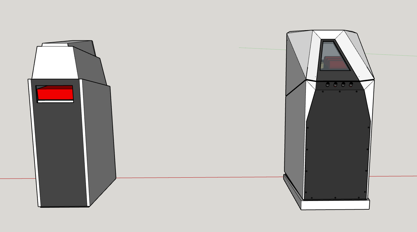

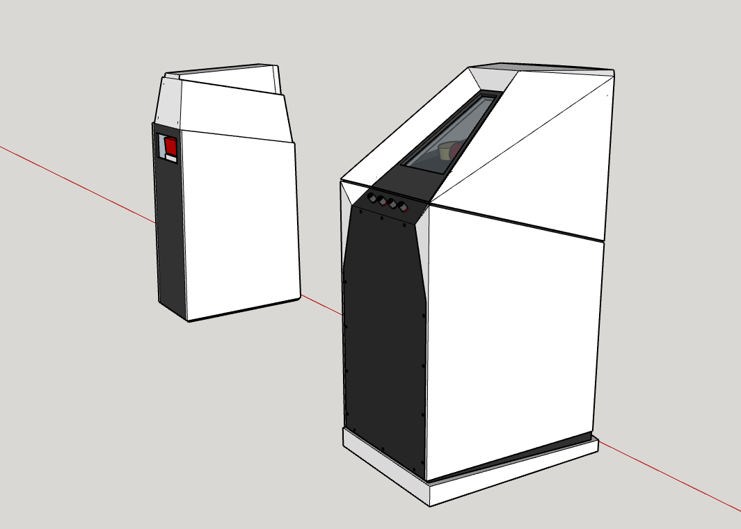

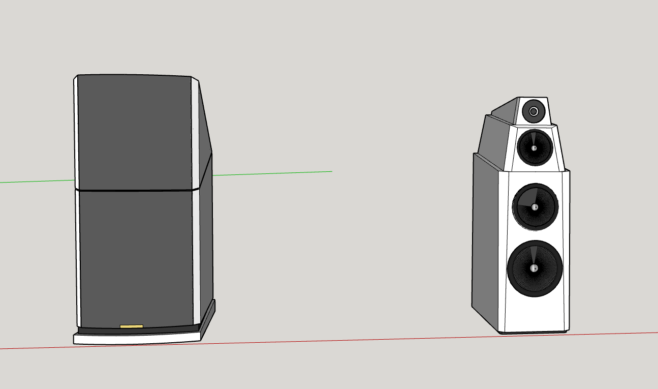

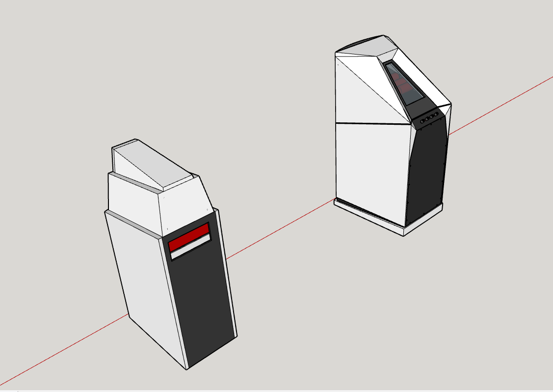

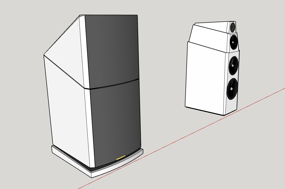

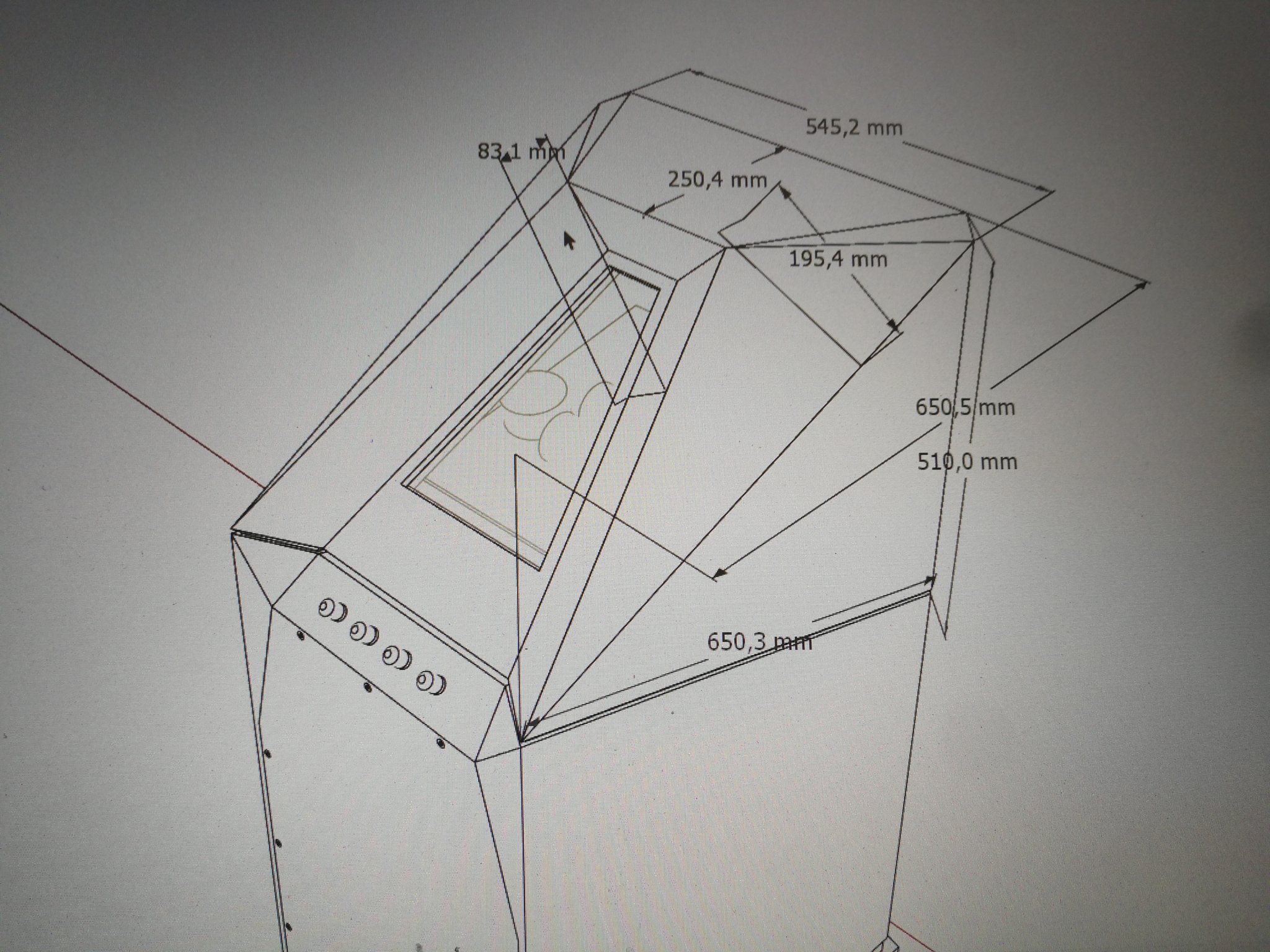

comparing my next4 to the upcoming TL2 in the virtual world.
It is big, but quite balanced. Are you still doing the veneer?
I like the grille that makes it seem "at rest" and soft on the eye. The next4 is way more busy for the eye, calling way more attention to itself with it's shape and driver units.
Hard to put to words, but I actually prefer the balanced look of that big (and no doubt potent) speaker. 🙂 I love the slight round shape of the foot and grille. That seals it for me.
Wesayso, I am happy you wrote what you wrote. I think all in all a big step forward in terms of visual. and I bet Sonic as well... Although the Next4 is mighty capable as well. I wish I had both of them side by side when the're finnished. Funny that the Next4 seems so rough... in the real world it turned out be quite handsome. That's just yet another indication that the TL2 will stunning!
About the veneer. I think the amount of work will be overwhelming so I'm considering it only hald hearted. maybe thou instead of the black surfaces 🙄 I think I'll be smarter when I'll get there.

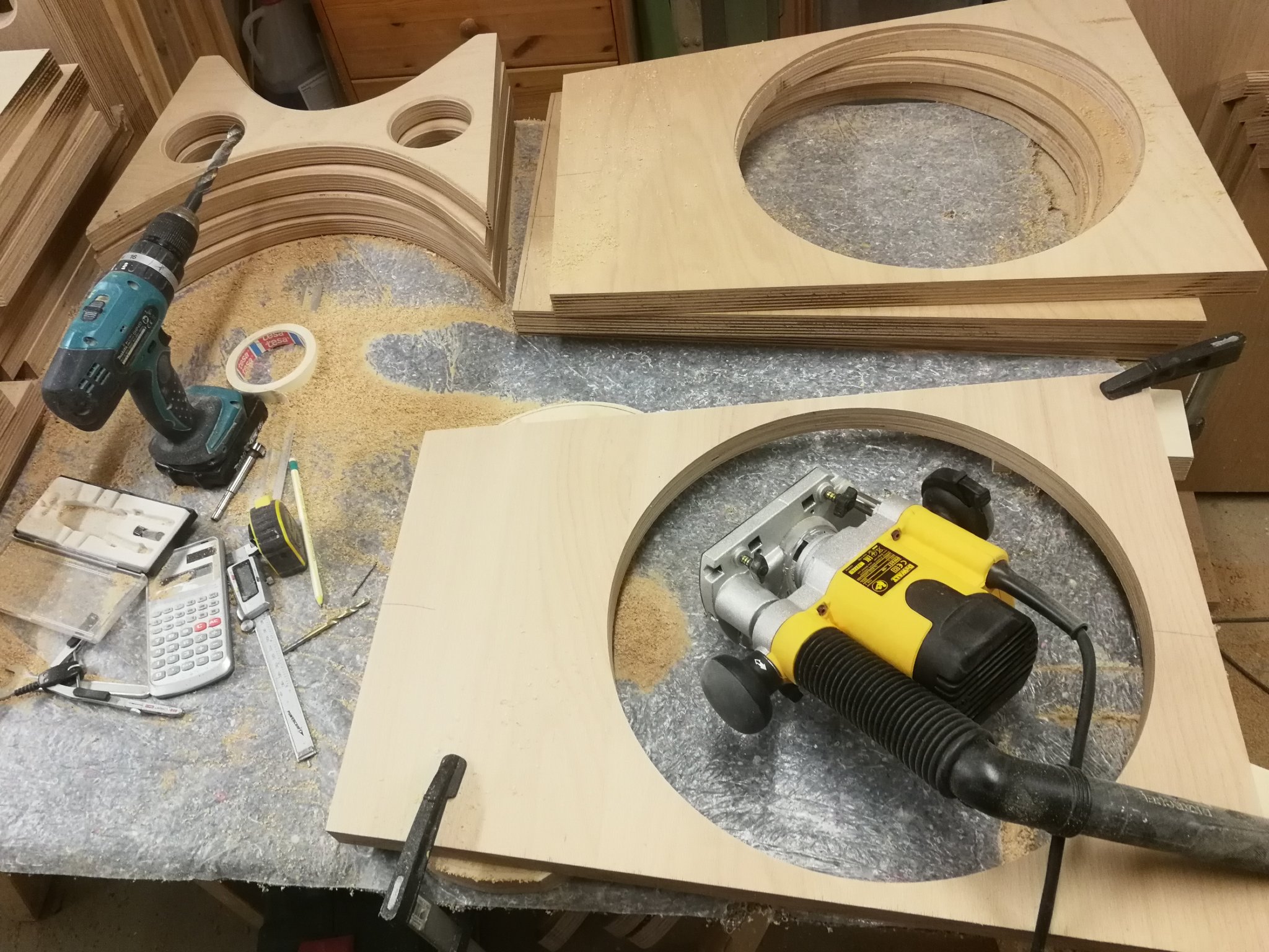

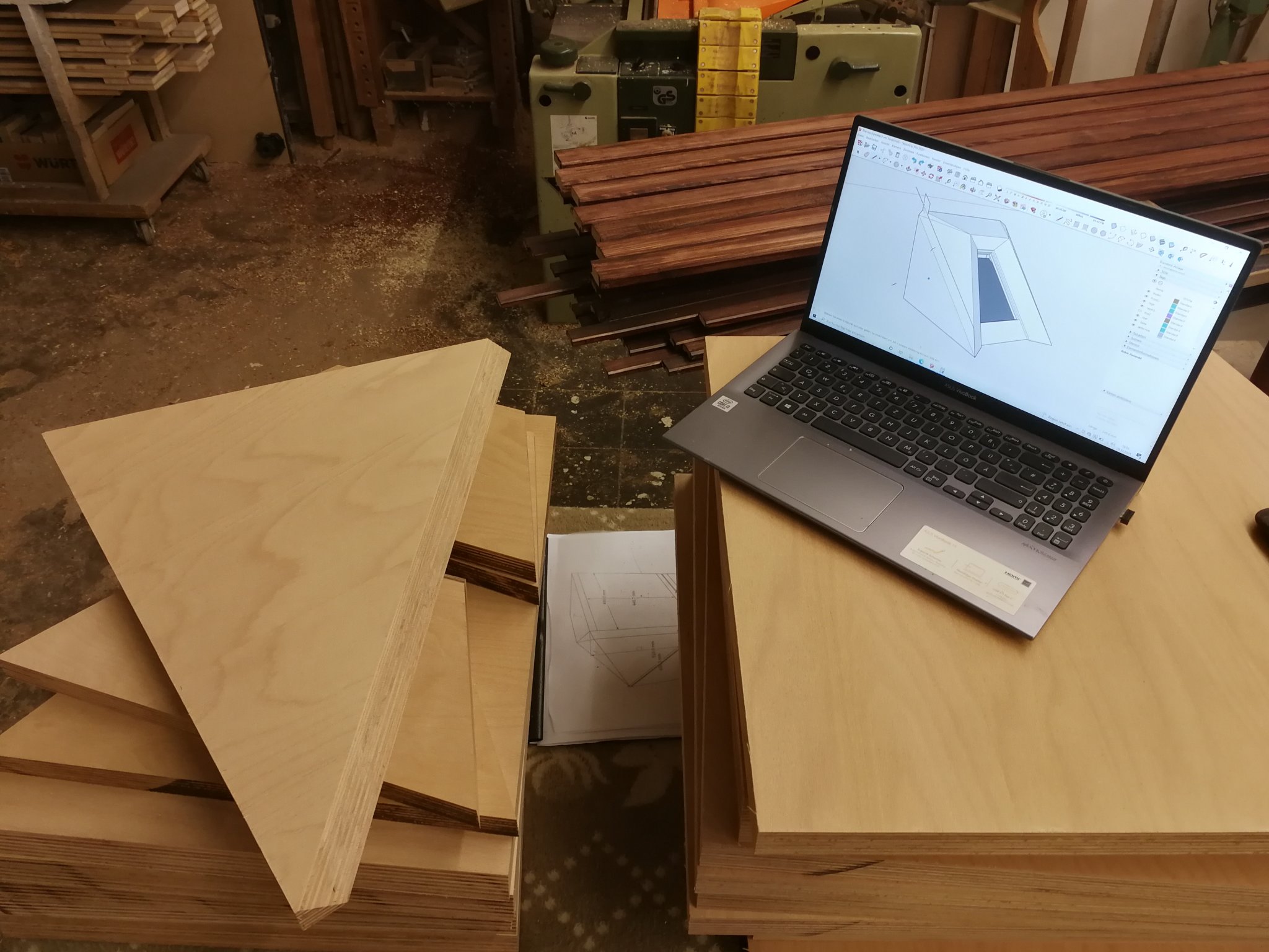

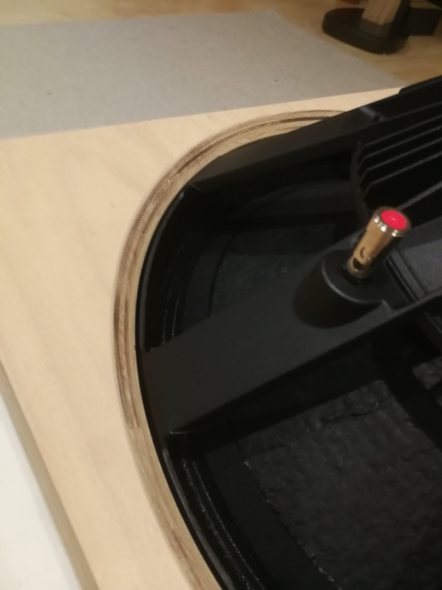

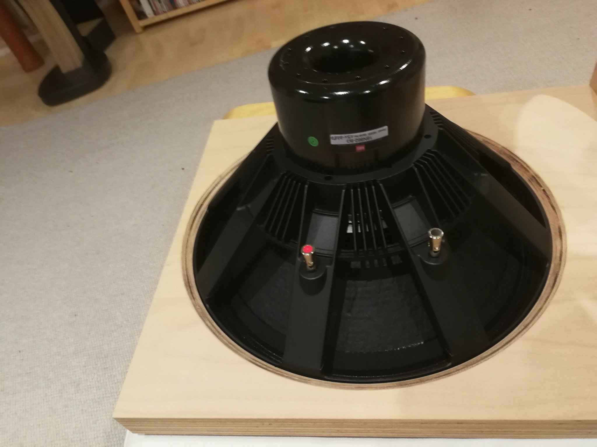

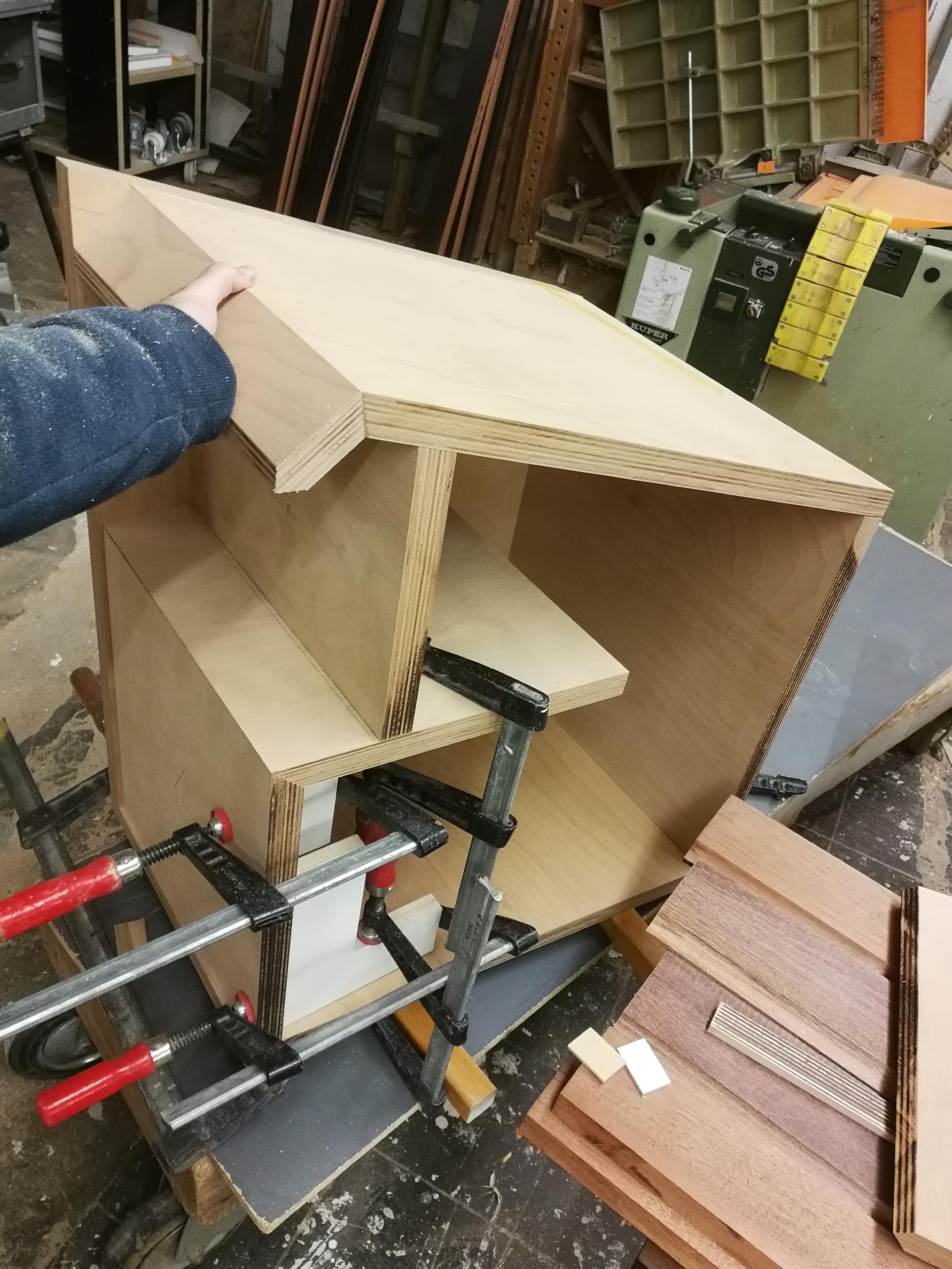

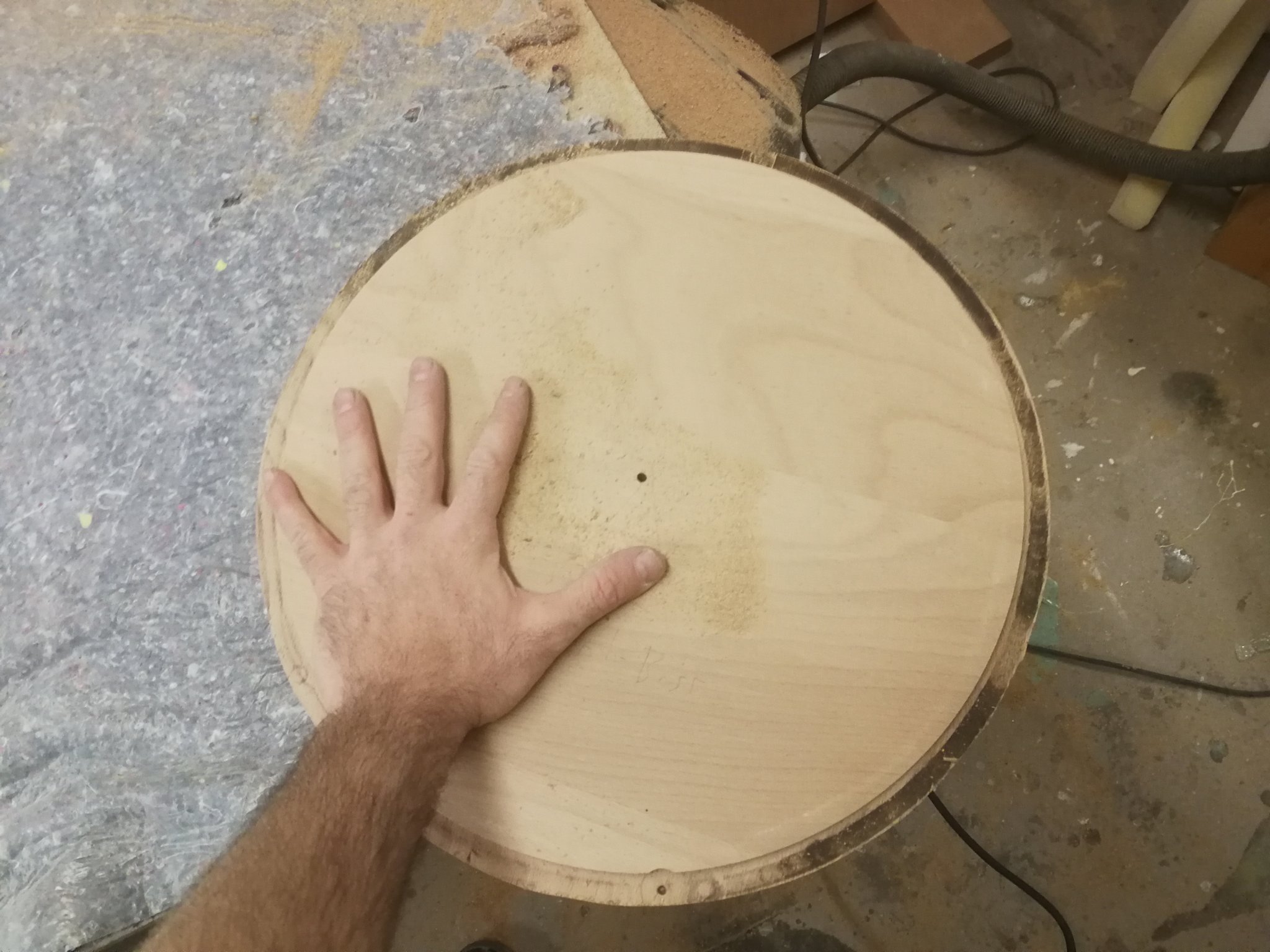

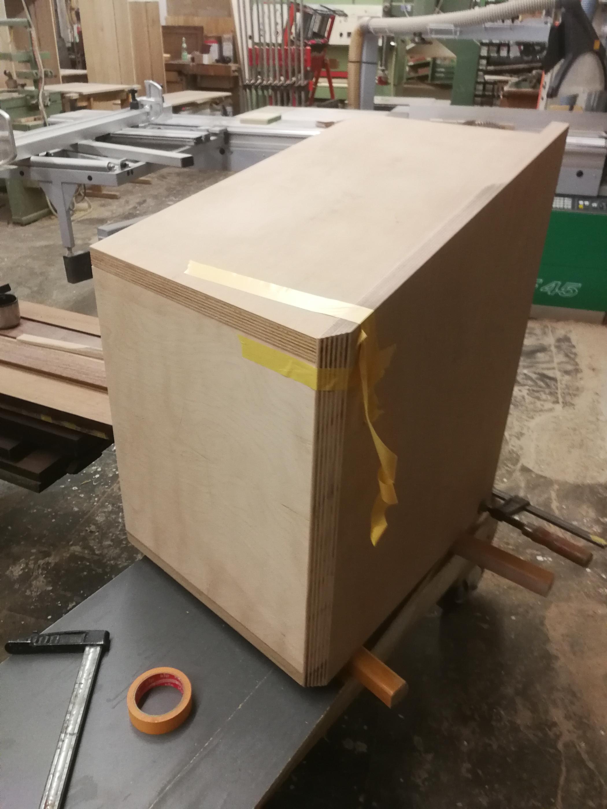

Finally starting to cut sheets of beech plywood, 30mm thick. Every cut is a small operation since the cabinet is also narrower at the back at an angle of 5 degrees... So a lot of time goes on accuracy.
In my books, beech plywood is the best you can get (after panzerholz that is 🙂) better then birch which is also a great material. Only problem is cost, here in Germany it is about 45-60€per square metre.
