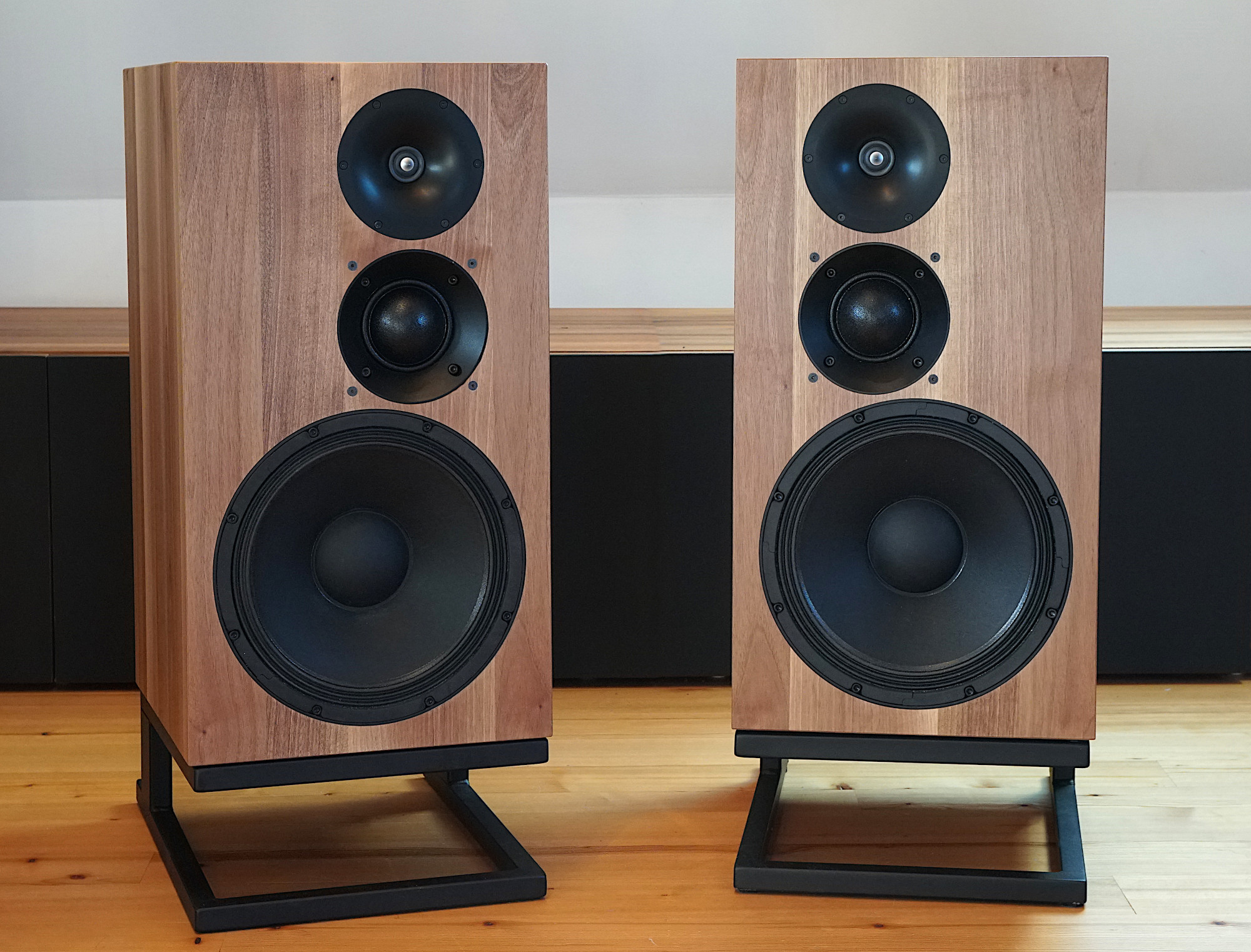

I think the aesthetic is a bit over-done (..not fond of the glossy look and especially the painted waveguide), but here is another:

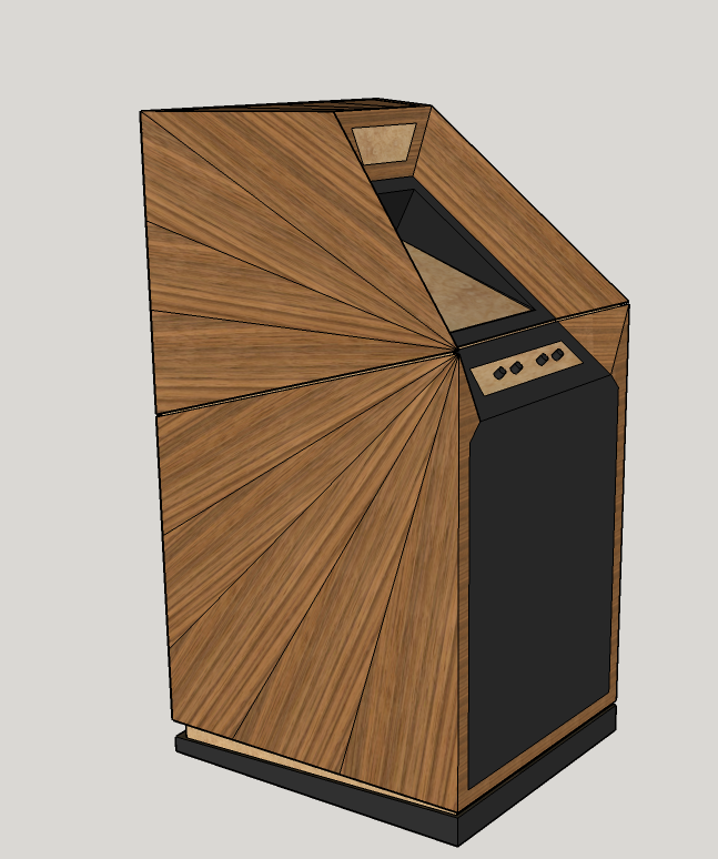

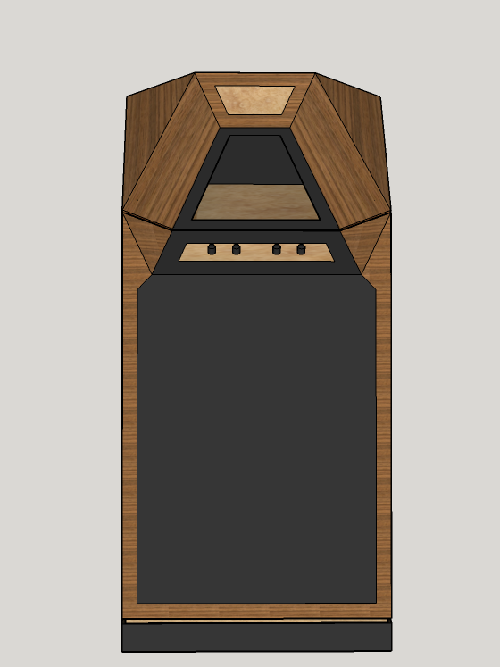

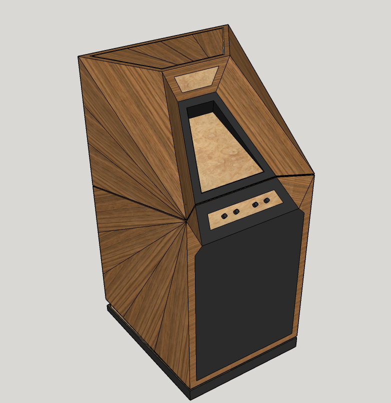

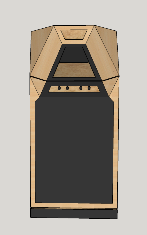

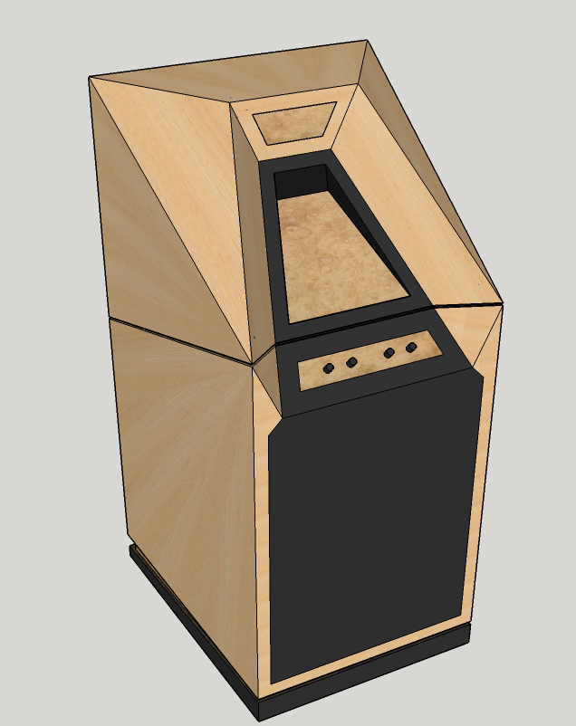

The front is so difficult (no clue how to make it pretty) that I kind of deserted it while sketching... finding myself concentrating much more on the rear. Which is turning out nicely. a combination of Wilson audio and well something else.
I am thinking of using Makassar veneer but I'm open for suggestions!

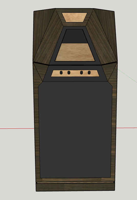

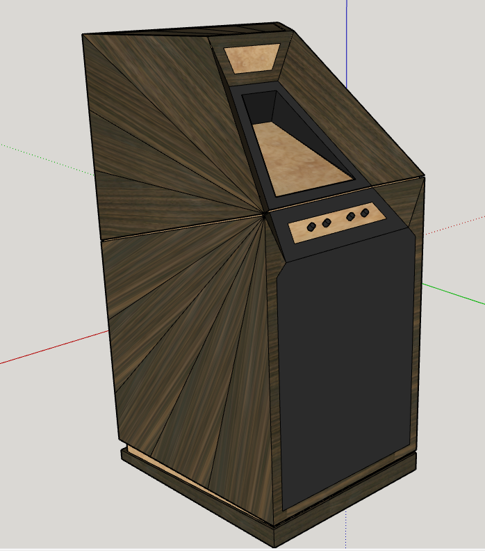

And in Walnut Veneer. the middle triangle Kammer would be for the crossover components. probably covered with glass. Spending so much on caps and then hide them inside? nope. Either show them, or hang them on the Christmas tree.

Hi, Makassar is my favorite kind of wood in the your example but i must admit i'm biased as a Warwick's bass owner ( they mainly used wenge for their neck and sometimes body).
And overall i prefer darker wood.

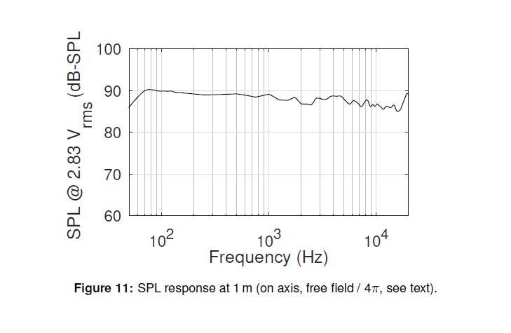

I’m having a real hard time with this one trying to make the industrial “PA” style touring box (albeit, crafted of nice wood and finish) that TG designed to be an easy on the eyes box. It’s just too stout and big visually for me. He has so many other designs, are you really that married to this one? IMO, Mbrennwa’s OSMC looks better and has just as good of performance if not better. Plus, crossover plans are free. Proportions are just more eye pleasing. I hate the name though.
TG’s TLS-1:
Vs.
Mbrennwa’s OSMC:
I think there is some “golden rectangle” effect here that makes the LS-1 look less pleasing. With a grille maybe it’s less of an issue but a home statement speaker should look good with plain drivers exposed.

Tony Gee's Galactica seems more of a challenge to a woodworker to me. And looks a lot better. Even his box-like Calpamos has more charm. Alexander Gresler is working on or has finished his Kaventsmann, I'm pretty sure that design will perform very well and has better looks. But you'll have to contact him for details, he has restricted access to the design.

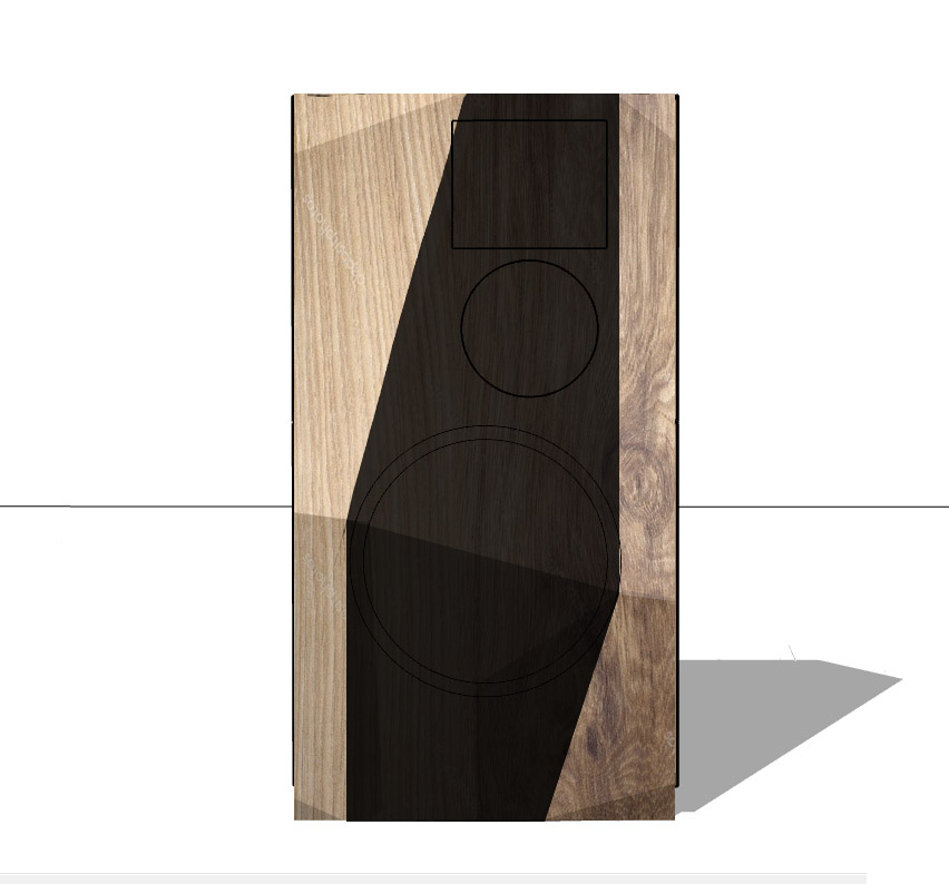

one more quick sketch.
i would divide the huge front panel vertically to make it less "impressive".
i would handle the rectangular front as a graphic design.
the "polygons" in my sketch could be very very slight bevels, but visible due to different reflection of light. and of course the grille, as the main graphic element...
i would furthermore not stick to a strict symmetrical design, following the asymmetrical driver layout.
just my two architect's pennies.

Hello guys, thanks for writing. Mark, the Answer for your question is No. Here are my main points for going for the TL1:
- I have spent the last 6 years listening to Troels design... I had the Amish, Flex, Cnomk2, Cno2.5, and the Next4. All excellent speaker, regardless of price.
So, naturally I have developed a certain trust to his designs. I have Followed Tony's work through the years but haven't tried yet anything of his designs. The Andromeda is for me out of the question...
-After 5 years of using Seas Nextel drivers I need a change. The obvious route for me was to build the CNO4 CNO-4 but I decided that it is time for a different cup of coffee all together.
That's why the concept of high efficiency (relativ), Paper cones (my favorite) and similar design concept of the Living Voice vox (amazing speaker) sounds like an excellent choice. His best Speaker in his opinion to date? that's enough of a reason for me!
-Cones: Optics!....... But as we see. there are some creative minds in this forum. I am sure we can tackle this slight (big) obstacle. Moreover tastes differ... My wife want the brightest veneer possible. I tend to Walnut, Krivium Likes Makassar. Can't please everyone!
-Let's not forget the Price! I bought the drivers second hand, almost all of them. and one could go for the less pricy crossover option. So for about 4-5k you get an insane speaker.

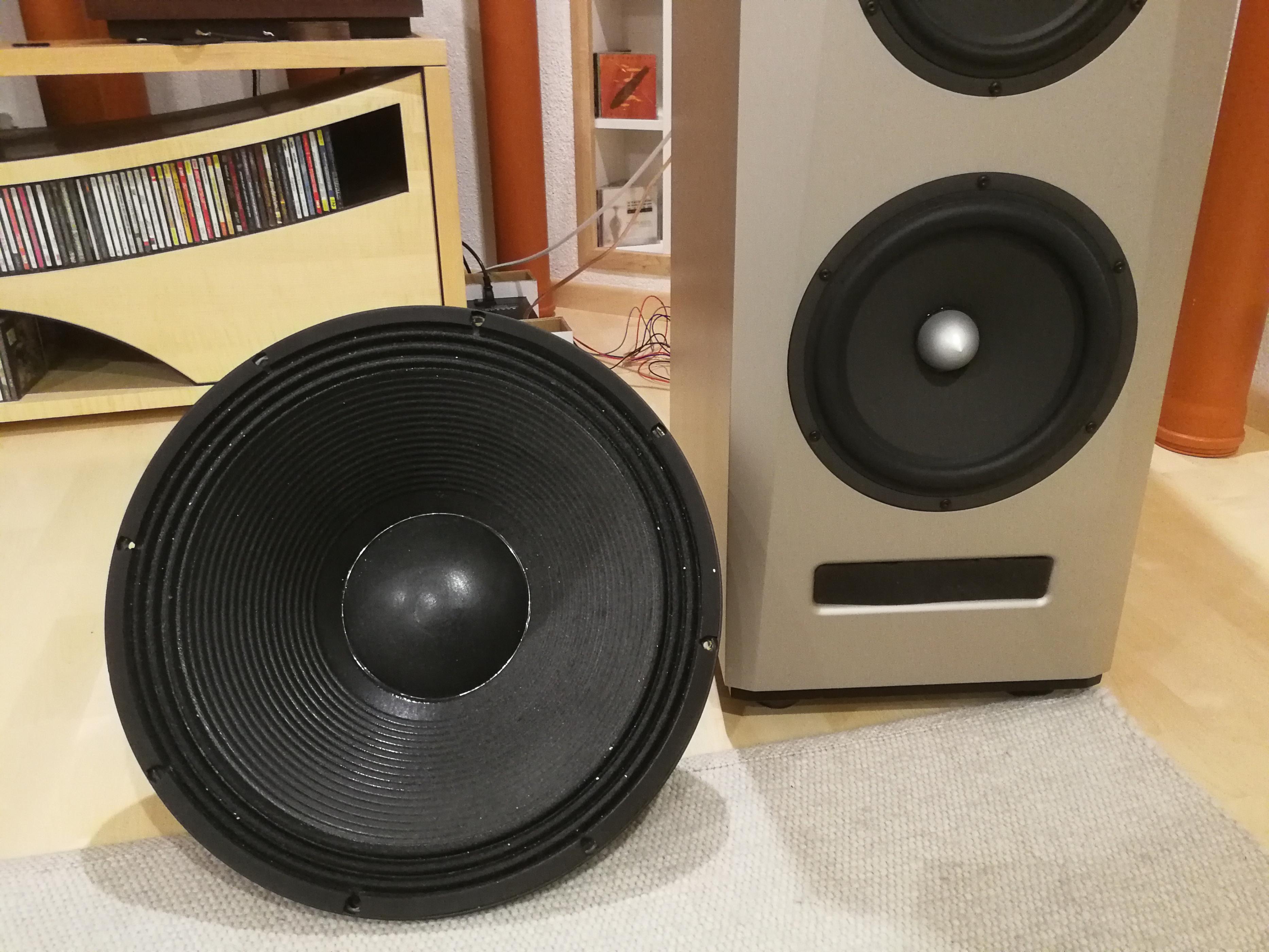

-last but not least, if your still not a believer check the next picture 😀 comparing the what seems big to me 10inch seas Nextel to the mighty 18inch BMS. Holy F##QK!
