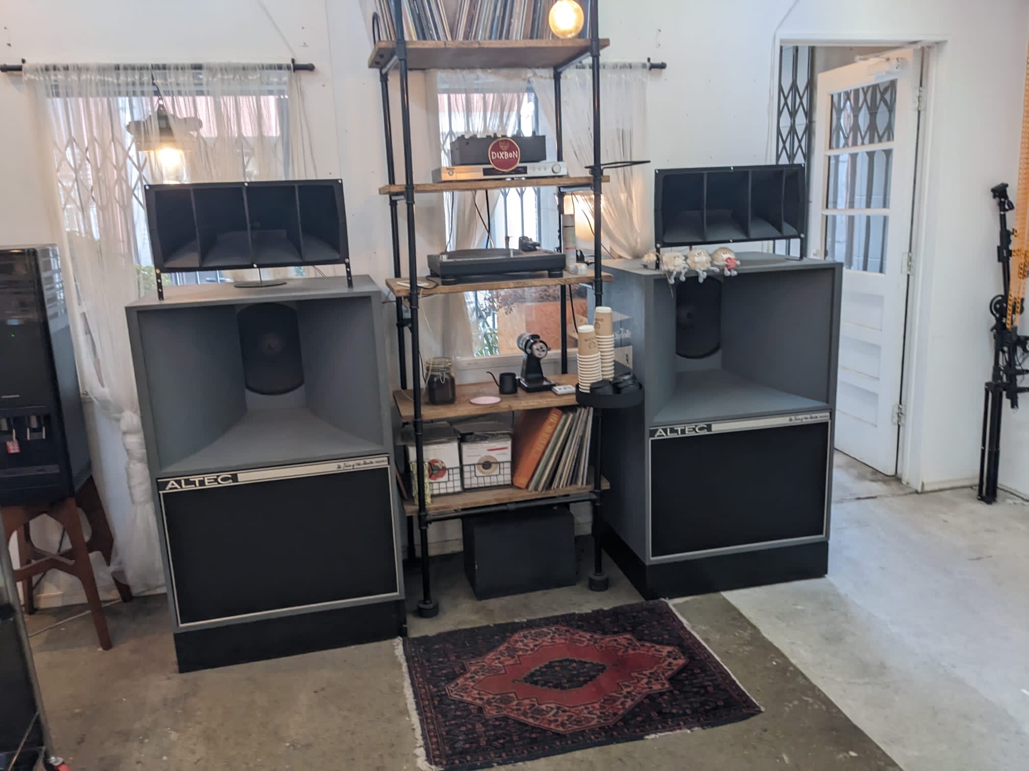

BTW, look what a friend just found sitting there in a tattoo shop in Japan, how cool is that!View attachment 1158782View attachment 1158781
Those are the speakers that I have, connected to my home theater rig. Although my Arcam has eight channels, I only use two. It is more than enough. Although, I do fantasize about adding some other speakers for surround sound. The SOT A7s throw a very nice enveloping sound field all by themselves.
At one time, I did have the horns mounted to the top. I took the time to be sure that I time aligned the drivers. My wife did not appreciate the Frankenstein look. They are currently flipped with the horn inside the air hole.
What is nice, is that I have them connected by an inter-connect to my main system. When I upgrade my main system, the sound of the theaters also benefit from that upgrade.
Inside, they are all original, including the quarter inch phono jacks.
One of these days I would like to rebuild the cross over, although I have no idea of how to do that.
Could you imagine if I connected the SOT A7 and the TL2 in the same room? Ha, ha, ha ha ha ha ha. (evil laugh.)
Because both systems are connected, I can play the same music on both systems at the same time. When no one is at home, I turn up the SOT in the other room, on the same floor, to energize the whole house, and it works kind of like a subwoofer to my main system.😎

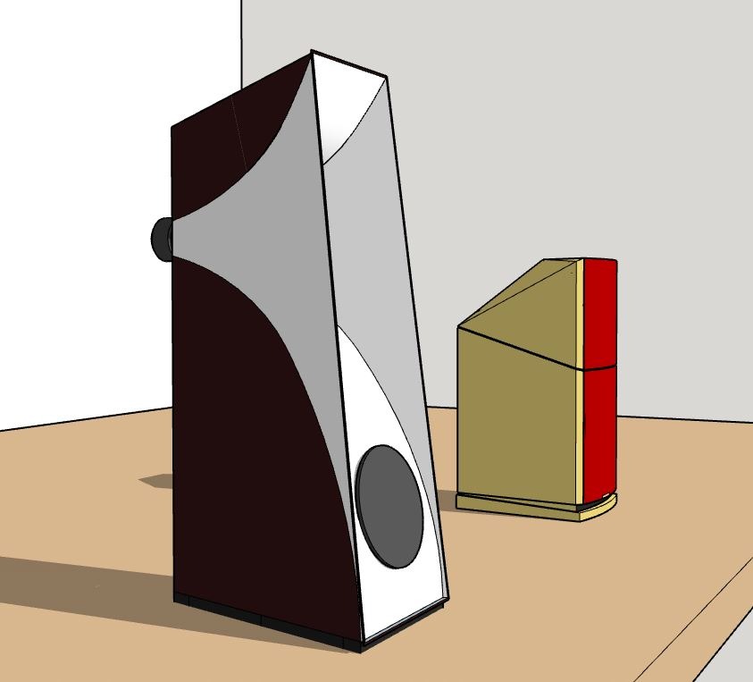

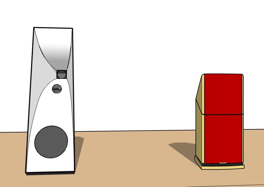

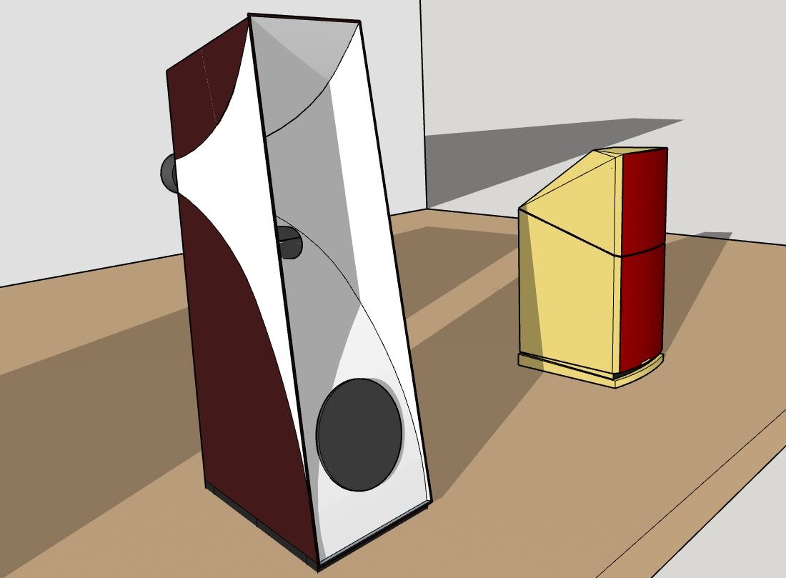

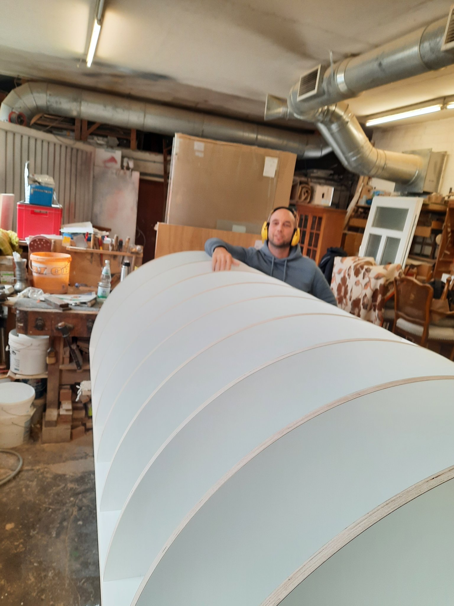

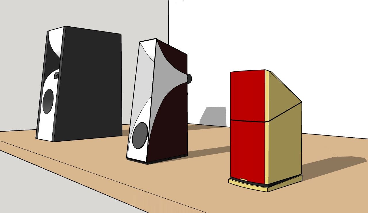

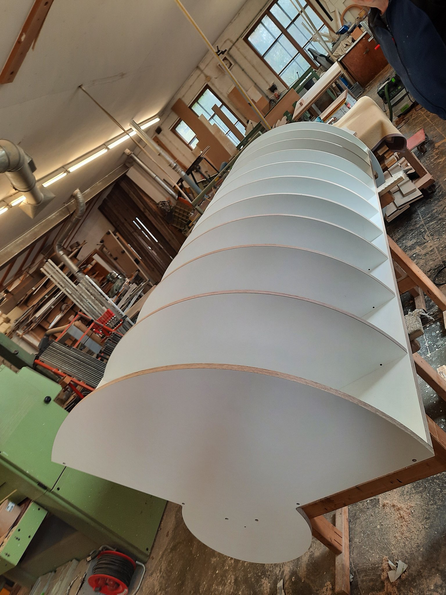

Meanwhile I was being absolutely obsessed with this new loudspeaker form that stuck in my head since the Mahler concert.
I've been working a bit more on it... Looks promising I think.
Would it work?
Looks a lot like the those guys- One of best of show in munich- Forgot the name

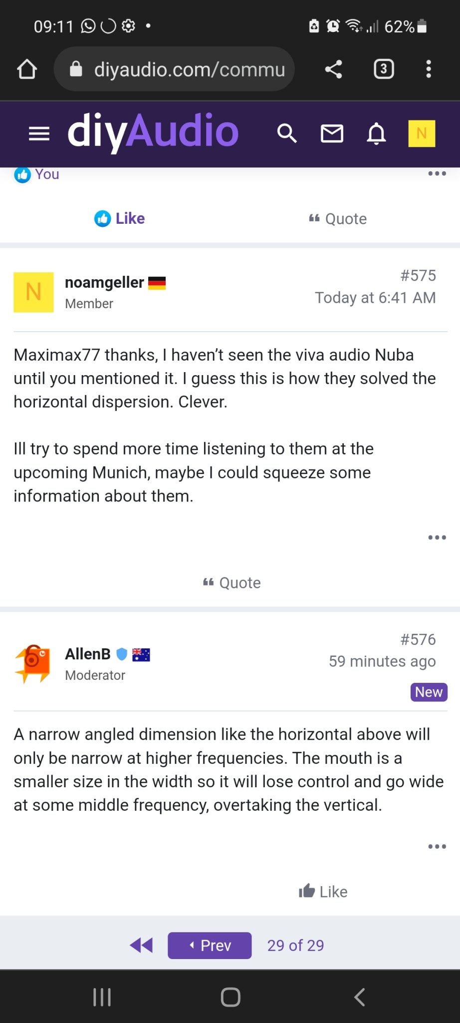

Maximax77 thanks, I haven’t seen the viva audio Nuba until you mentioned it. I guess this is how they solved the horizontal dispersion. Clever.
Ill try to spend more time listening to them at the upcoming Munich, maybe I could squeeze some information about them.
A narrow angled dimension like the horizontal above will only be narrow at higher frequencies. The mouth is a smaller size in the width so it will lose control and go wide at some middle frequency, overtaking the vertical.

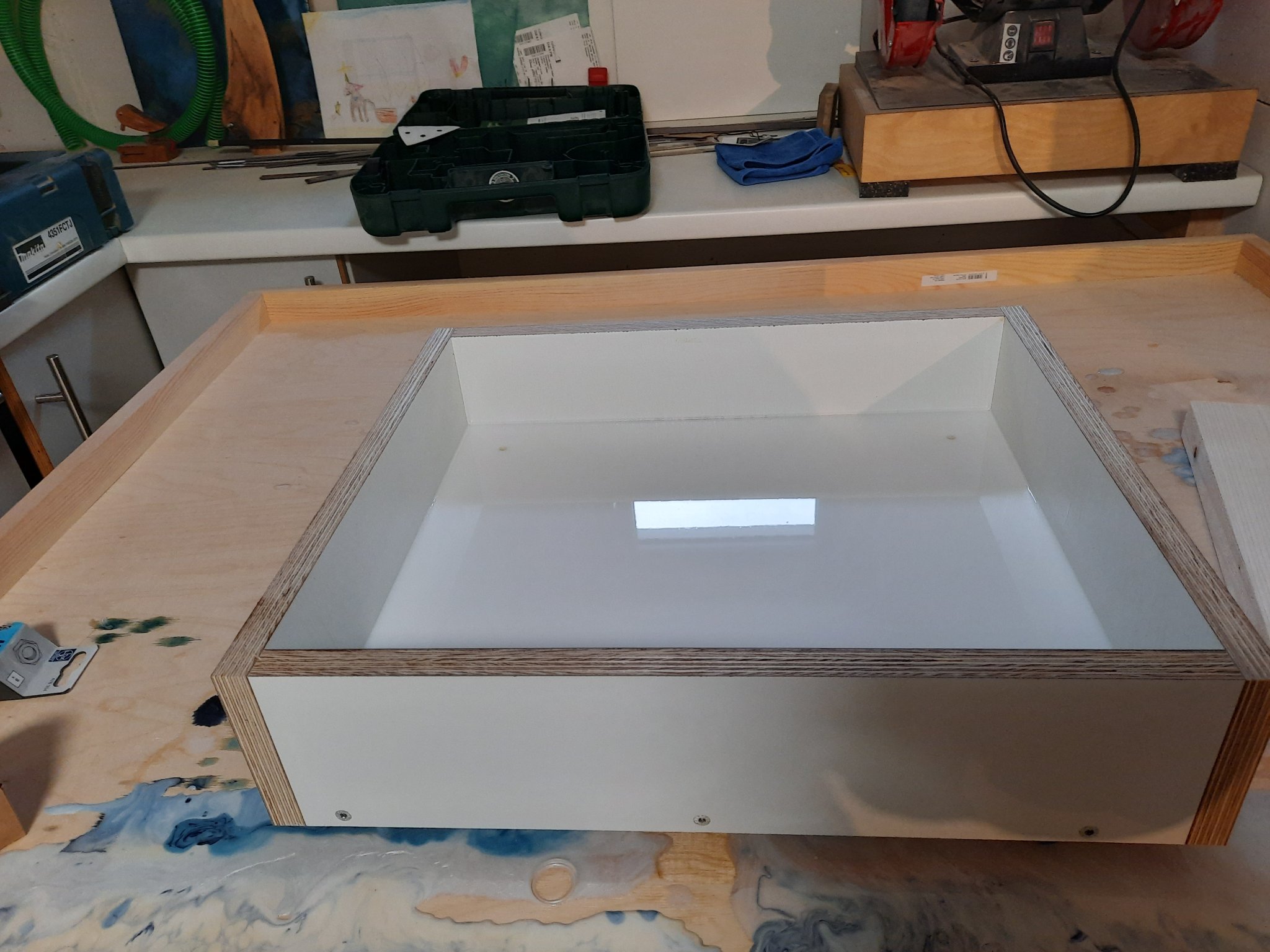

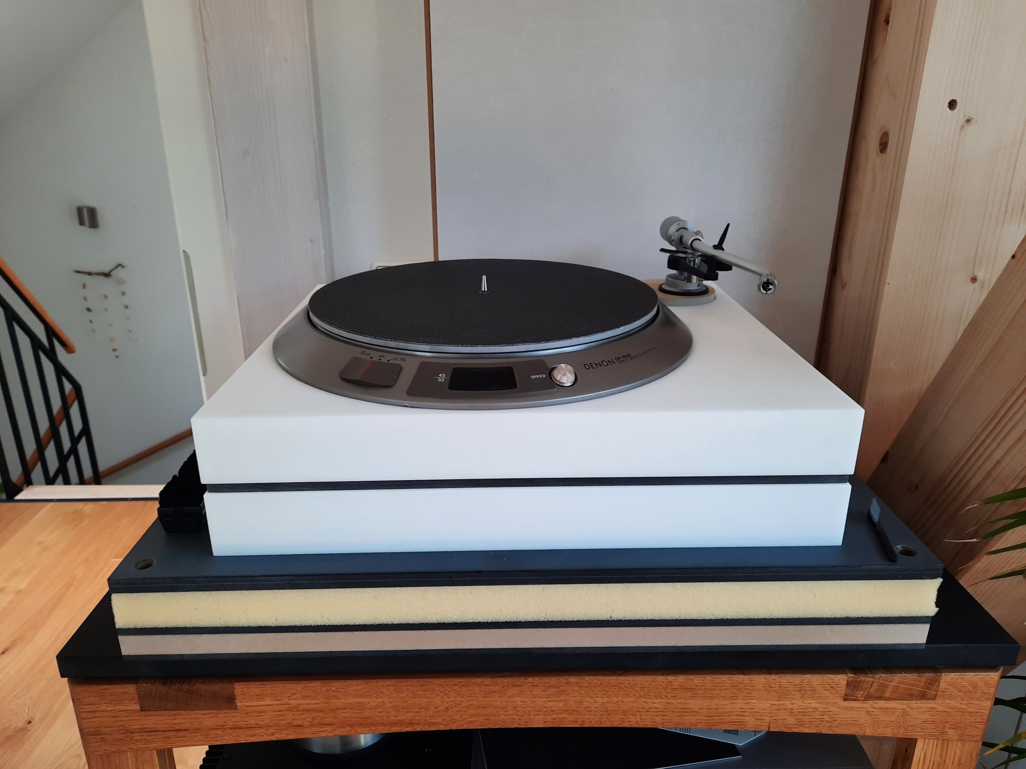

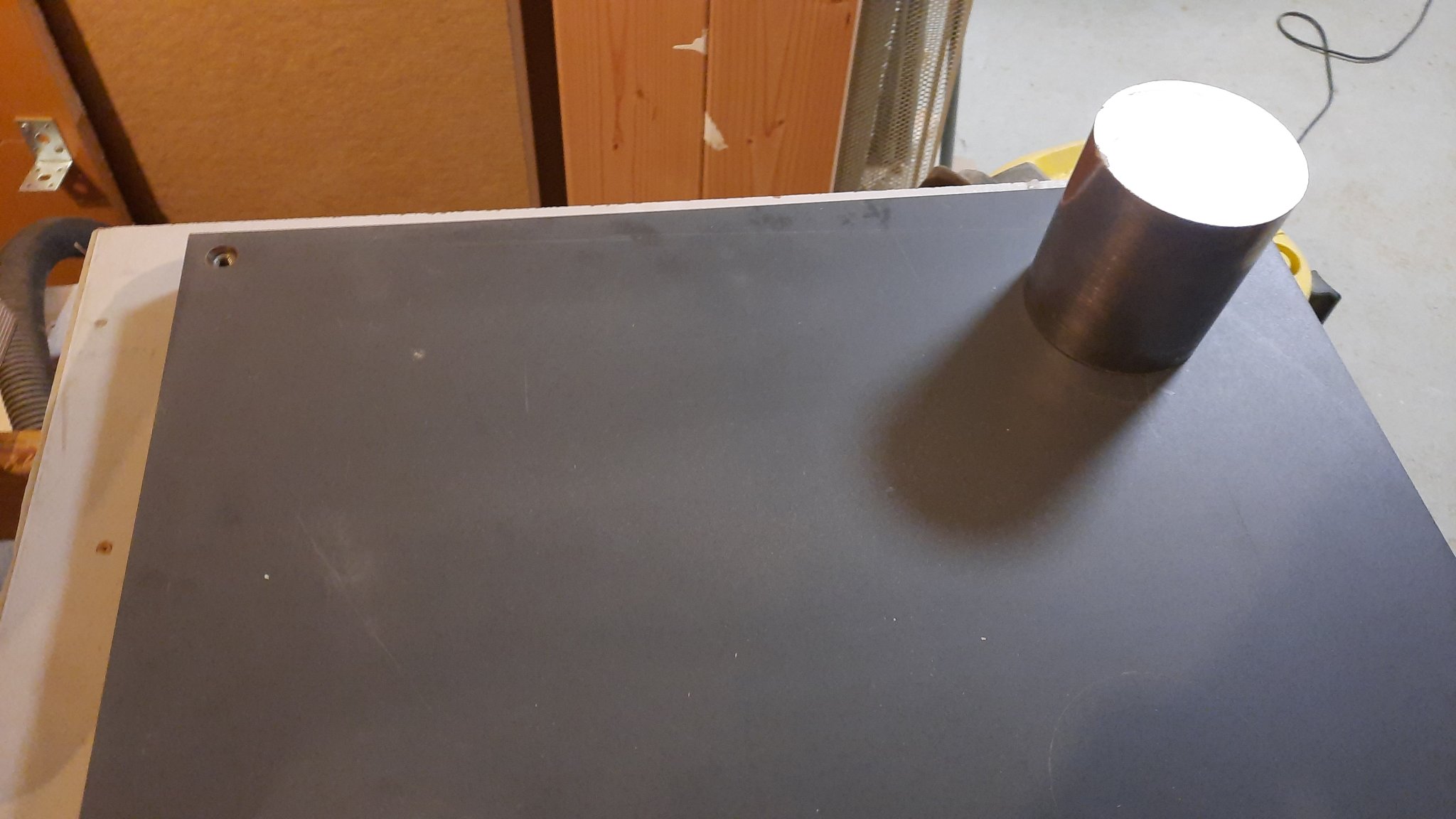

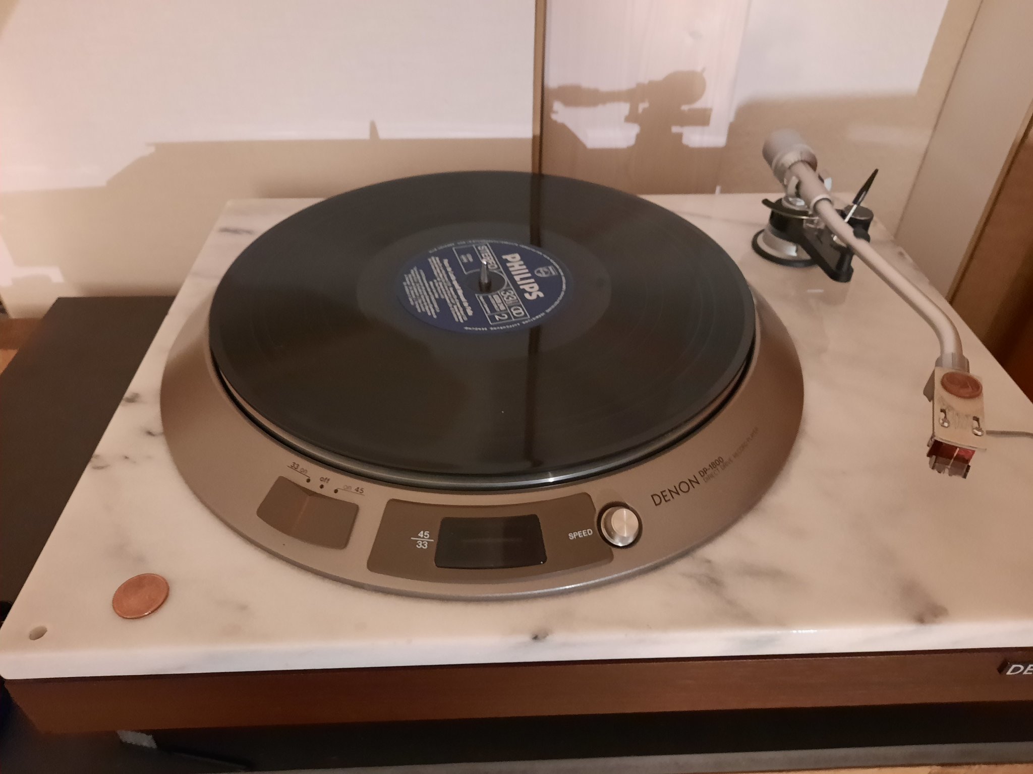

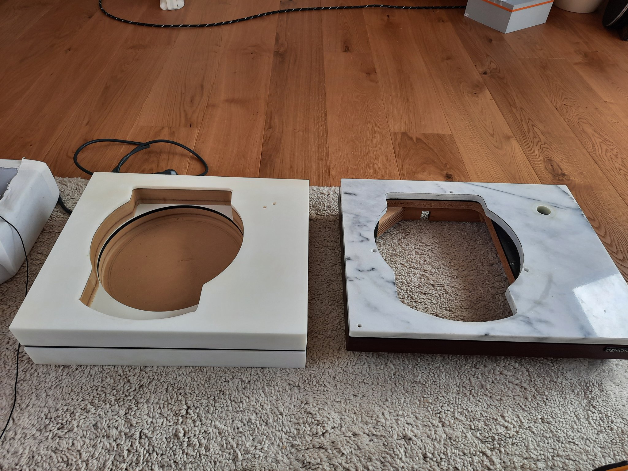

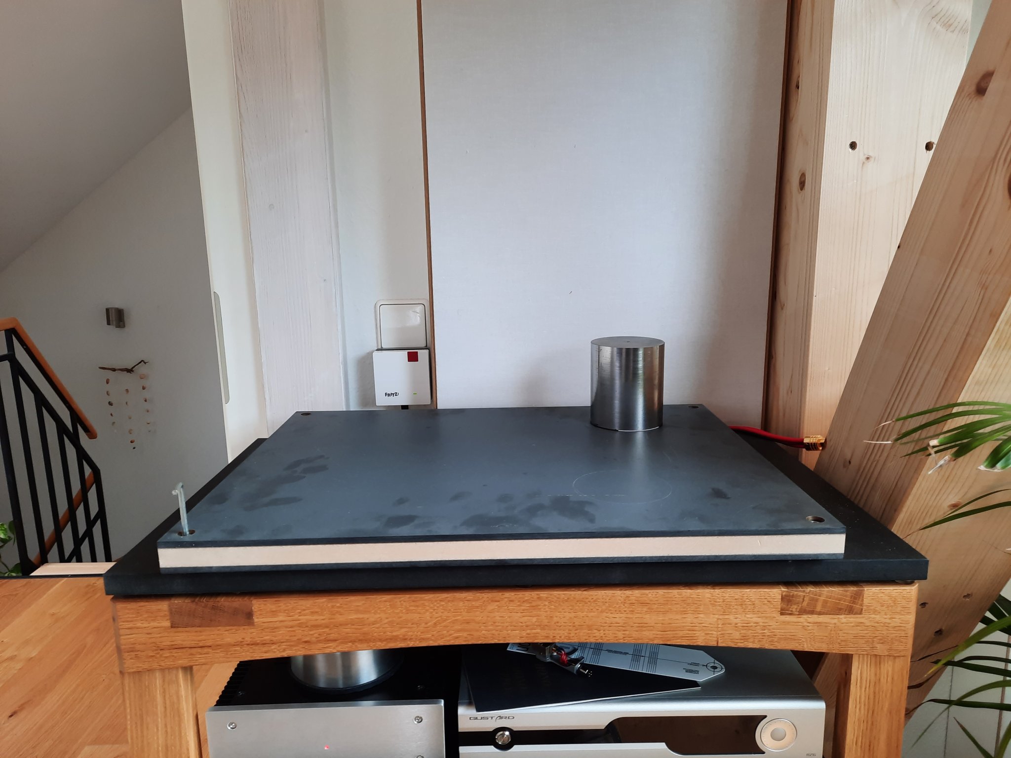

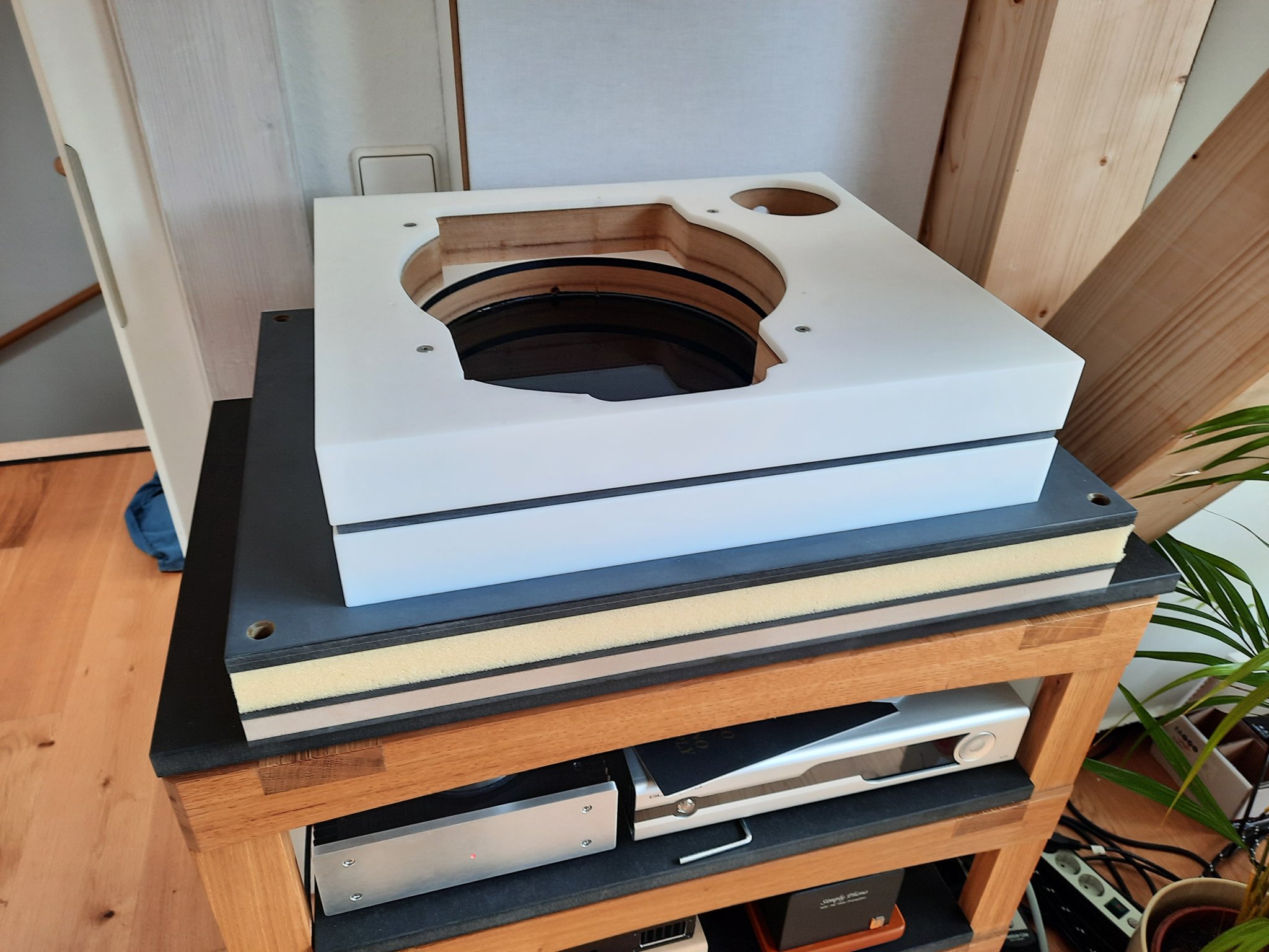

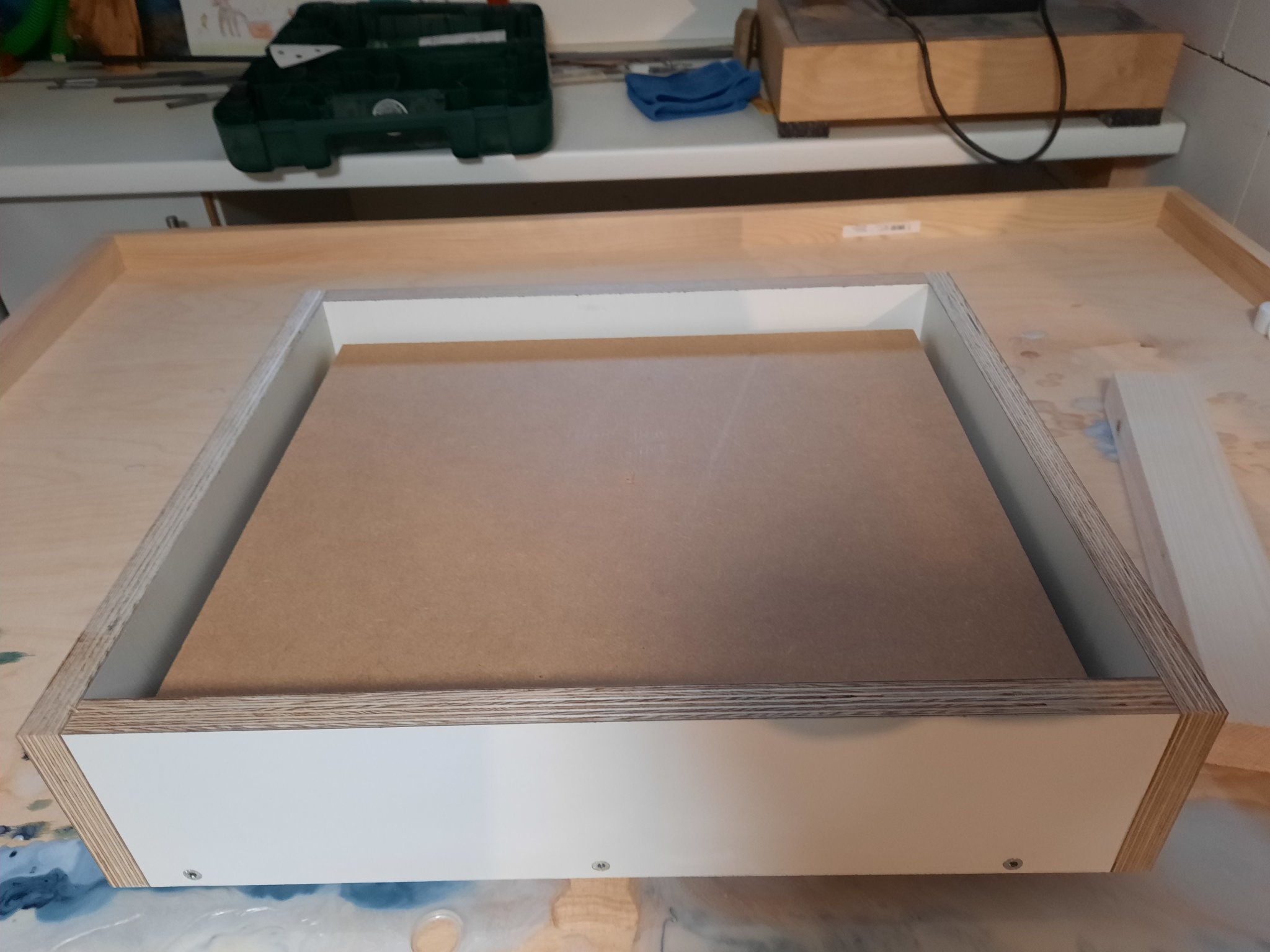

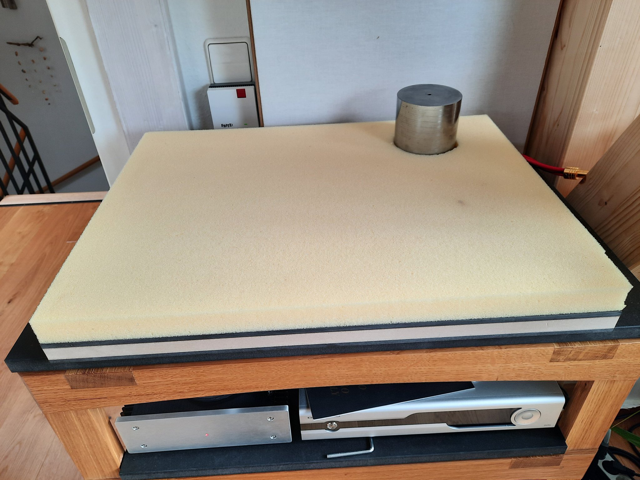

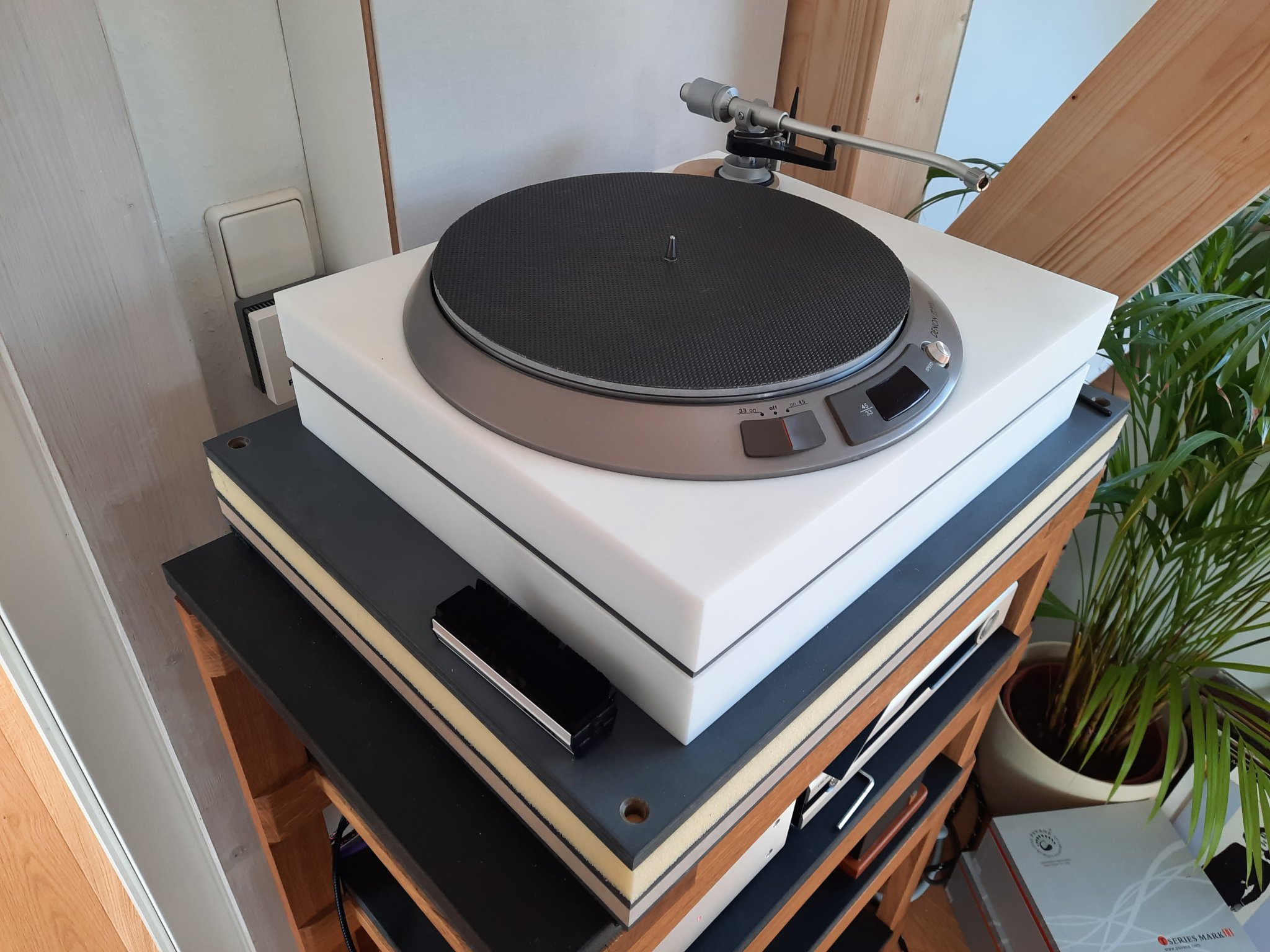

So, more fun project is ready .... new (better?) Plinth for my denon dp1800.
The idea was to completely decoupling the arm from the noisy motor... so I used memory foam and some alternating materials to lower (in theory) vibration.
The mdf is covered with epoxidharz (resin)
And I alternated mdf with so called HPL vollkern plates.
