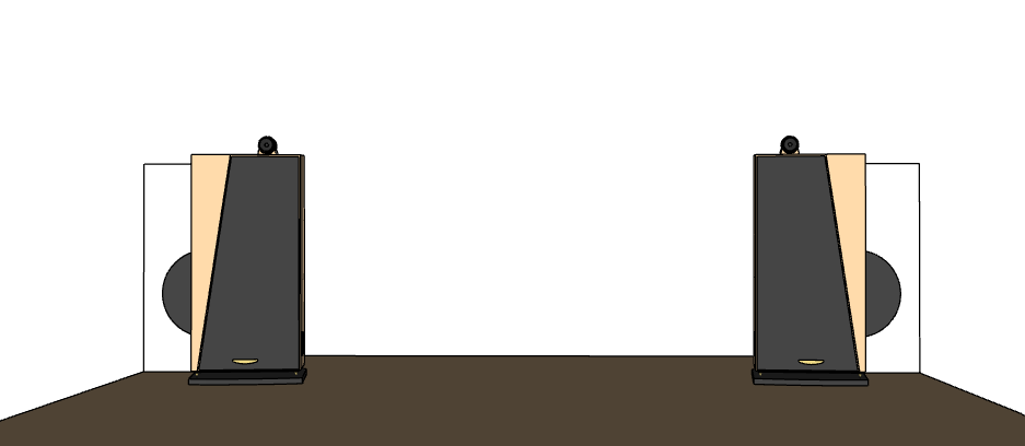

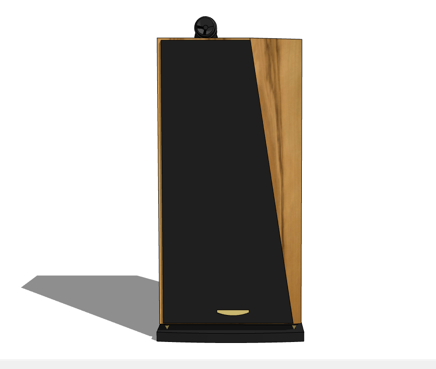

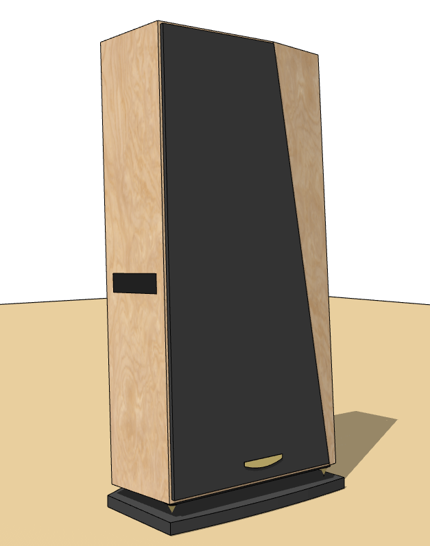

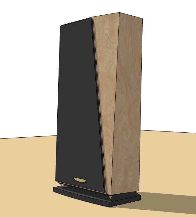

So, here are the CAD drawings, As I right it down I'm working on the veneer.
So, what do you guys think?
BTW- The drawings are made using google Skethcup. The latest Innovation is a small A.I. taking the render work load. unfortunately the A.I. is still too creative for my taste and is doing whatever the **** he wants with the Sketches- So I guess we can assume that he will soon direct its creativity on taking over the earth an enslave us puny humans.

Looks beatiful as always!
The BMS in 155litre ported doesnt go deep enough !
120litre sealed they need TONS of power to play loud. And don’t go deep at all.
I can imagine that 10or 12” Plays better in the upper bass but you will be missing something down deep, that’s for sure.(with sealed 18” BMS sub)
Those are my thoughts after playing around a lot with TL2/3 build🙂

I have tried lots of combinations with the 12N630, great great driver no wonder Troels uses it so often. It has a fs of 28.6, so with ported cabinet (50Liter) it can really dig deep. But... I also tried it different configuration of sealed, and got something I never heard before in my room. The Tl2 has transformed from huge presentation to ultra precise loudspeaker.
The sealed cabinet has still 50Liters, giving impressive transient response.
All this is controlled using the hypex FA501. If I will feel it's lacking in power I can replace it with FA502 bridge mode.
BTW, seems like the Goebel divin marquise subwoofers also uses the BMS 18n862. They are using it in 110Liter volume closed cabinet. (30,000€)!! But with more power. I have to try it!

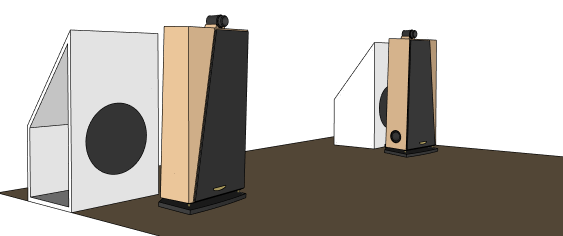

Where does The Loudspeaker 1/2 normally cross into the bass? With a 10" playing 1khz and below, what's the plan for a 12? Decoupling bass from the tower should be nice anyways, but I'm curious what a new woofer's duties would be at that point. 80-300hz?
Love the design work as always.
Thank you D1scoWhere does The Loudspeaker 1/2 normally cross into the bass? With a 10" playing 1khz and below, what's the plan for a 12? Decoupling bass from the tower should be nice anyways, but I'm curious what a new woofer's duties would be at that point. 80-300hz?
The 18N862 originally low pass is at 200hz.
The 12N630 has taken its place crossing at 180hz and will be relieved at 60hz.
The 12N630 can do stuff the 18N862 can't and vice versa. It will be interesting to get everything ticking together

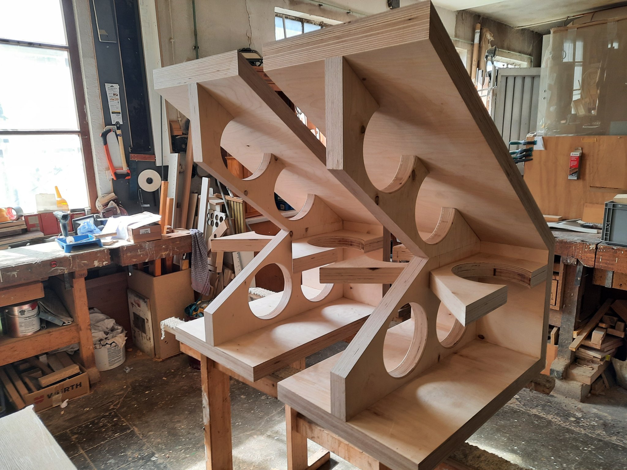

and I thought my 29mm ply was alerady overkill... 😛 I wish I were able to be so precise with the cuts. How did you joint the parts?
There is always an idiot (me) who will over over kill it...I thought my 29mm ply was alerady overkill... 😛
I use wood biscuits and ordinary wood glue.
For those who want to have fast cure time one can use Allcon 10 (Beka).
It is brutal glue comes in tubes like silicon and will cure in 10min. It I stronger then wood glue and will fill gaps if you didn't quit got a perfect cut (up to 1mm gaps- no problem).
