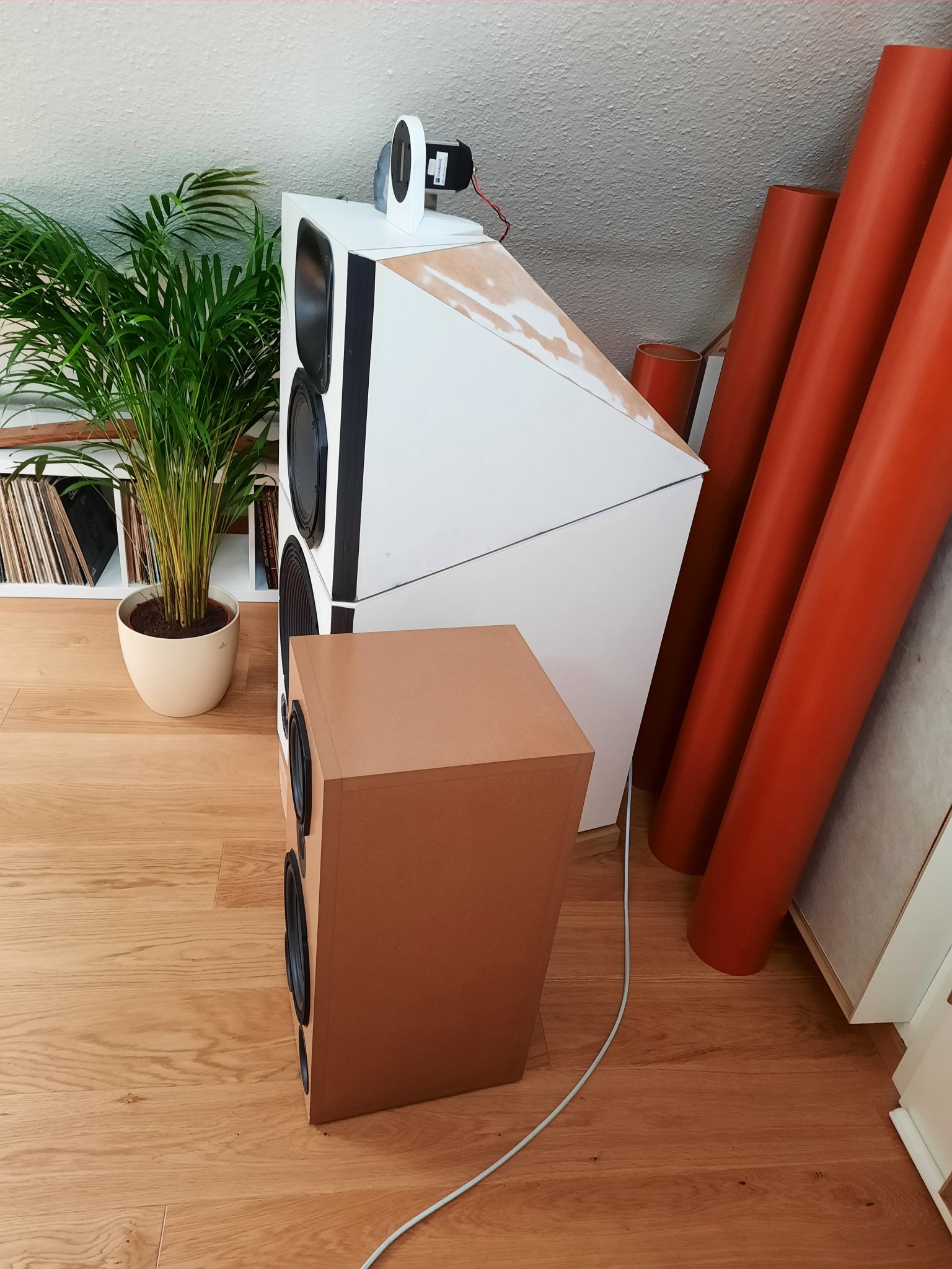

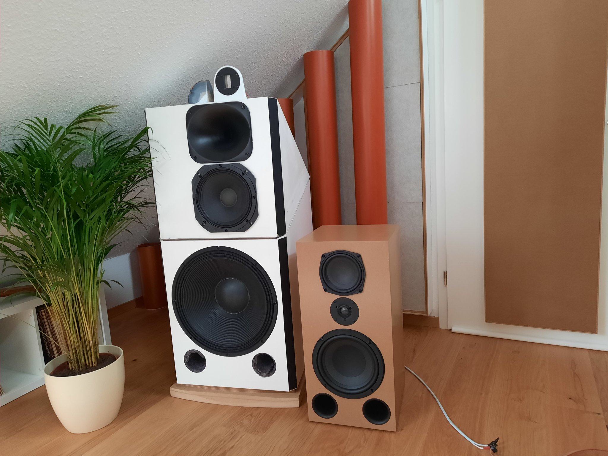

So, the nice visitors have left and it's time to write about our impressions of the
TL2 VS FAITAL 3WC-10 bothe designed by Troels Gravesen.

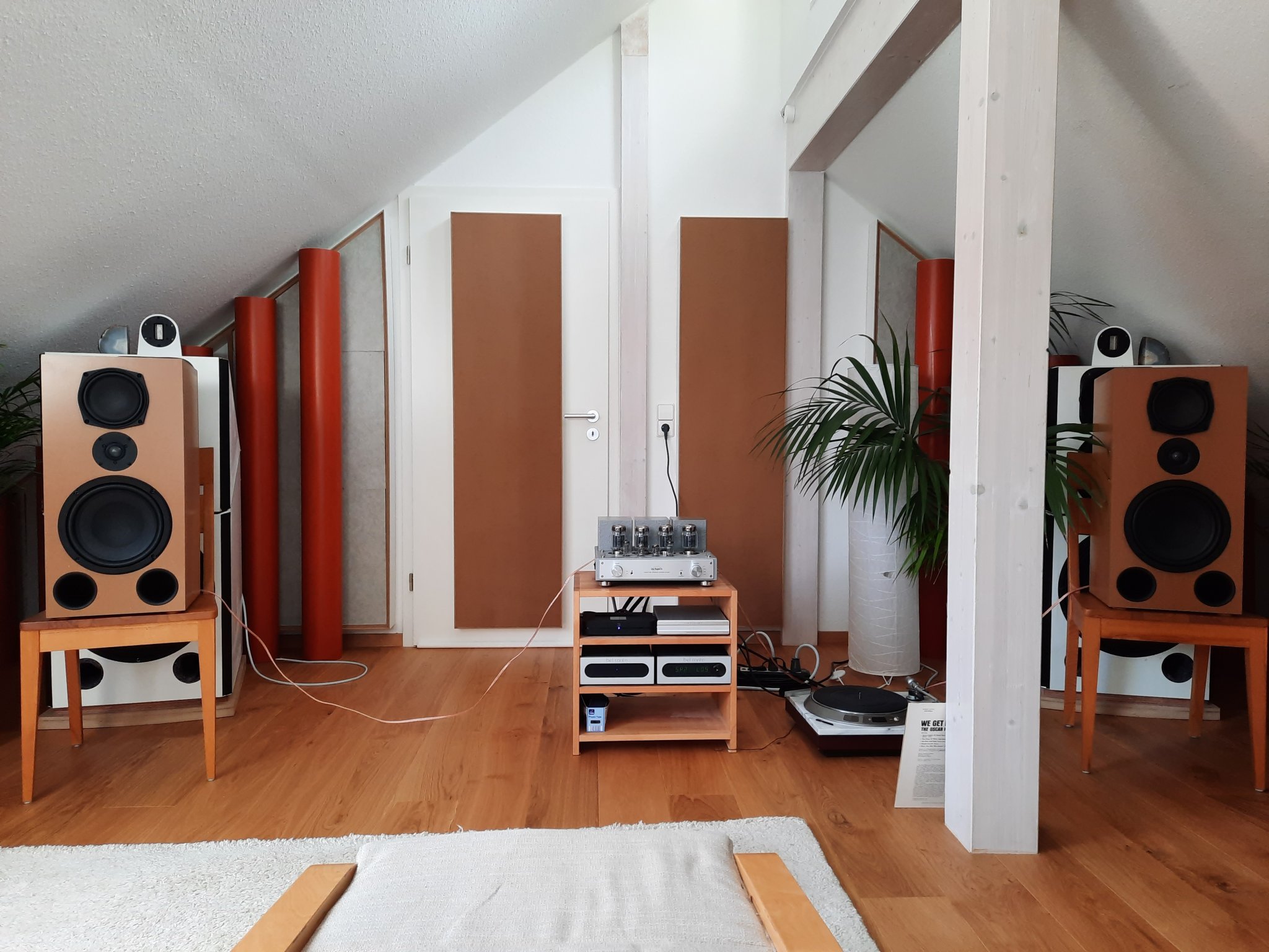

Equipment used:
-Line Magnetic LM216A 38watt tube integrated amp
-BEL CANTO DAC2.5
-Bluesound node streamer
We where a group of four and spent 4 hours of listening. I am writing as a group since we all concluded basically the same.
We started with the TL2- The Loudspeaker II
http://www.troelsgravesen.dk/The-Loudspeaker-2.htm
This speaker made music GRAND effortlessly.
Nothing seems to really put him out of his pace, dramatic dynamics swings, intense or intimate on demand and completely free of strain and stress across the spectrum.
The Horn+10inch kombo made drums and trumpets a blast, fast fast loudspeaker.
Voices were a treat as well, giving a beautiful very realistic timber, especially by man vocals.
Woman voices sopran seems to be especially free of strain, especially at high notes, no ringing, no distortion, air and freedom.
The conclusion
The most holographic, electrostatic like, life like speaker I had, and must be one of the best I've heard.
FAITAL 3WC-10 (Berillium ver.) http://www.troelsgravesen.dk/Faital-3WC-10.htm
Well, a very different animal from the TL2. The Faital was giving a good fight after the TL2 were unconnected.
The Faital excel in gorgeus midrange and fantastic snappy dynamic range. Very very detailed sound and true of timber.
Voices were a treat!!!
Where it felt short of the TL2 was at ease of presentation, scale obviously and the top and bottom felt in comparison restraind, cut off.
Nevertheless, I would probably be very very happy with the Faital , especially since it costs a fourth of a level one TL2.
After listening to the Faital we switched back to the TL2 and the sense of atmosphere and presence where back in the room. Size matters after all.
Disadvantages of TL2: I think that the BMS 18inch felt a bit loose and would probably profit from more power, maybe I'll bi-amp them, maybe not.
All in all a very enjoyable and insightful for us four.
Ps. 4 hours of listening is loooooong (for me) yet we agreed that there was absolutely no fatigue, a virtuous of both the TL2 and the Faital.

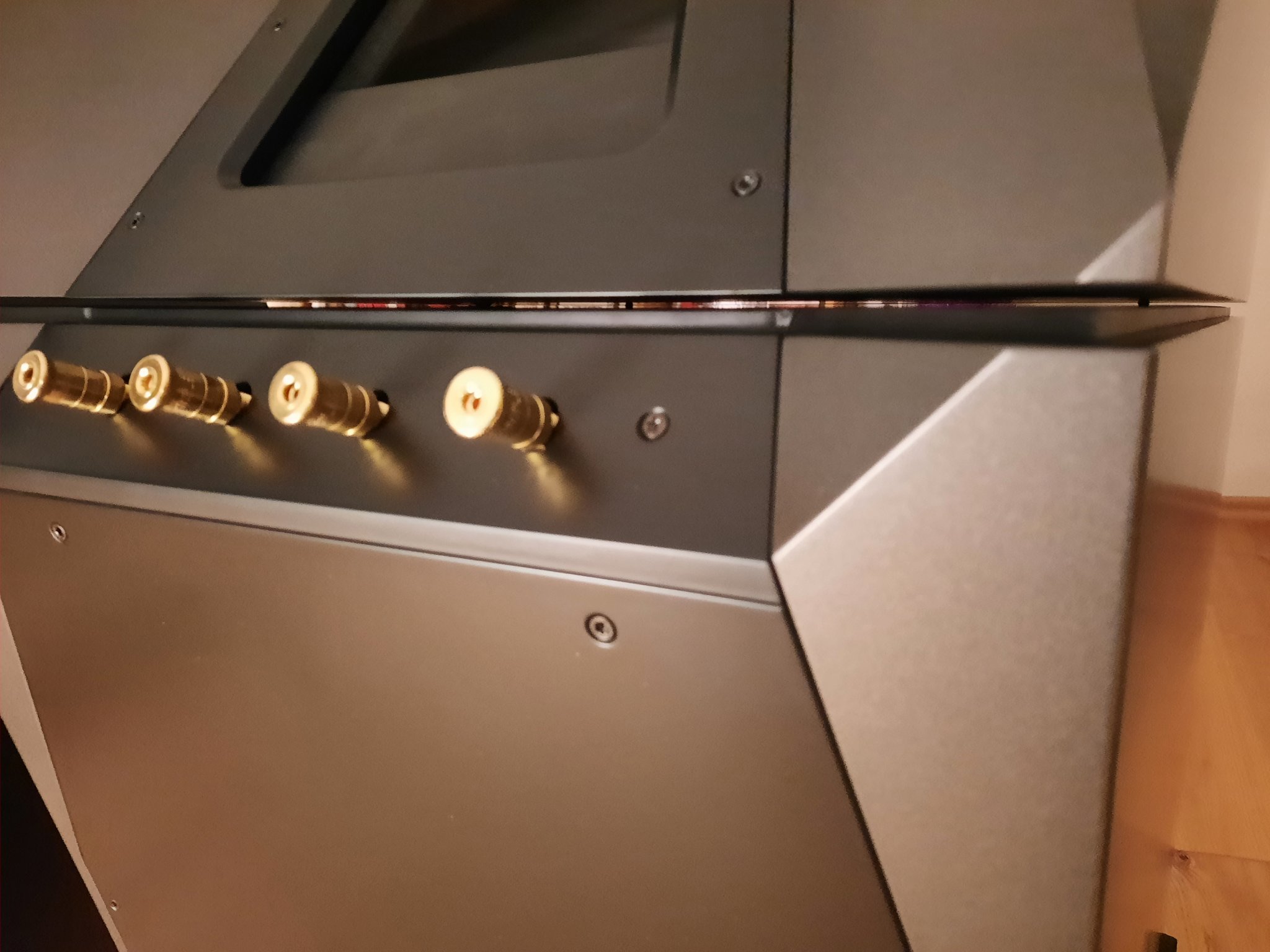

BTW really nice job on the design. Maybe I missed it earlier but how are the two halves of the cabinet connected together?
Thanks a lot for the kind words 🙏
The top cabinet has 3 height adjustable spikes. Actually no real use to height adjust the top cabinet, I guess I did it since I tend to complicate things.

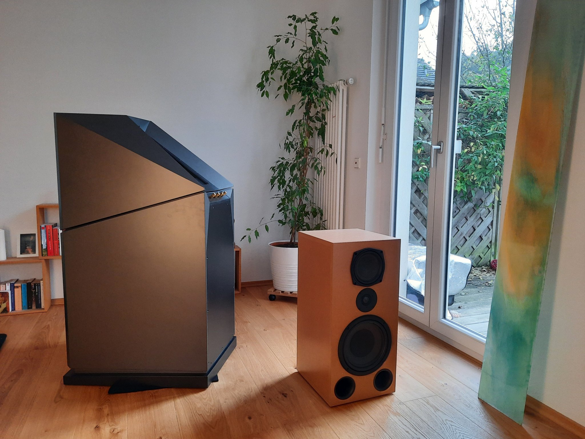

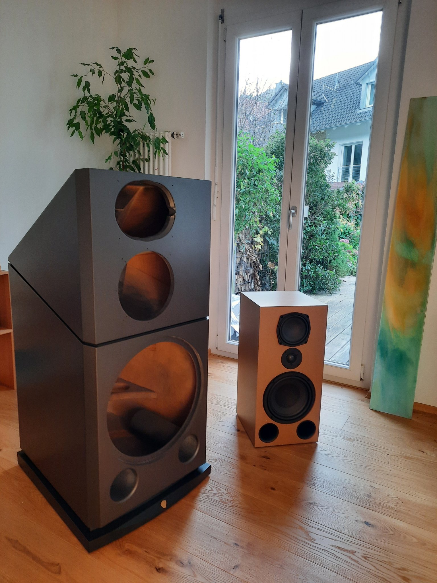

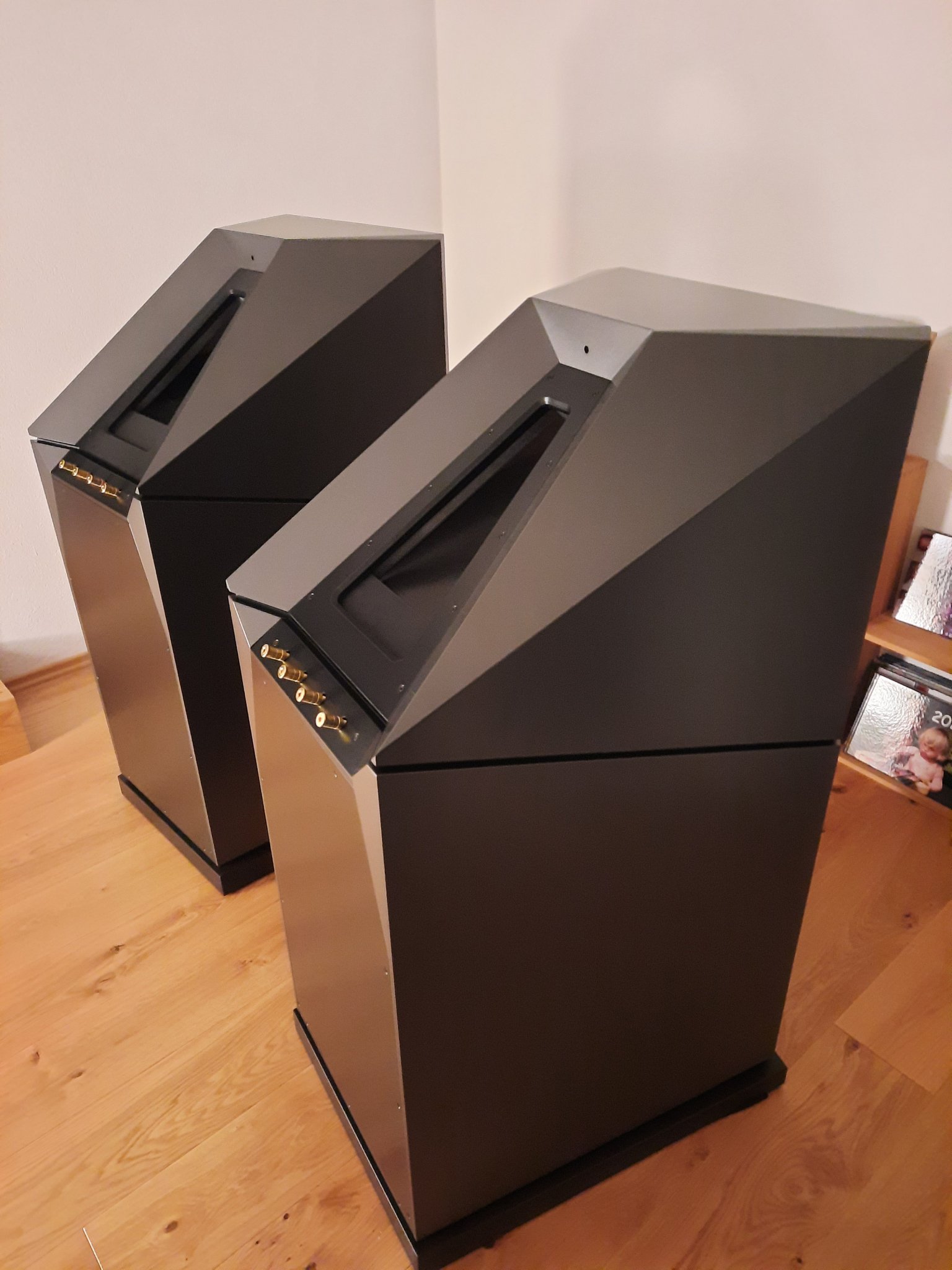

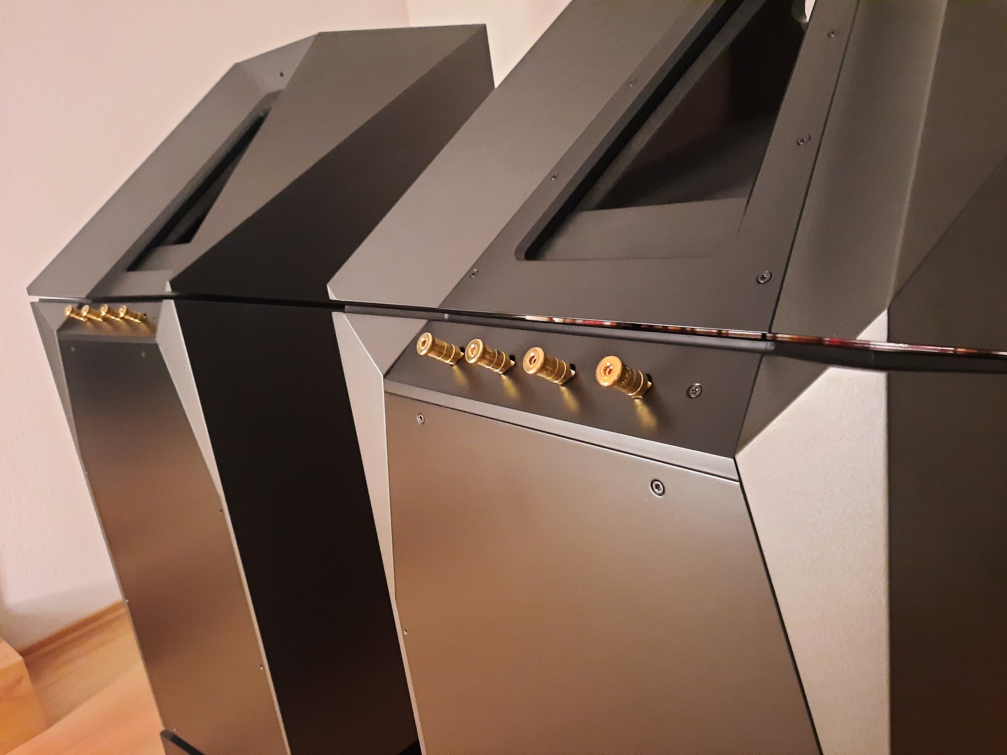

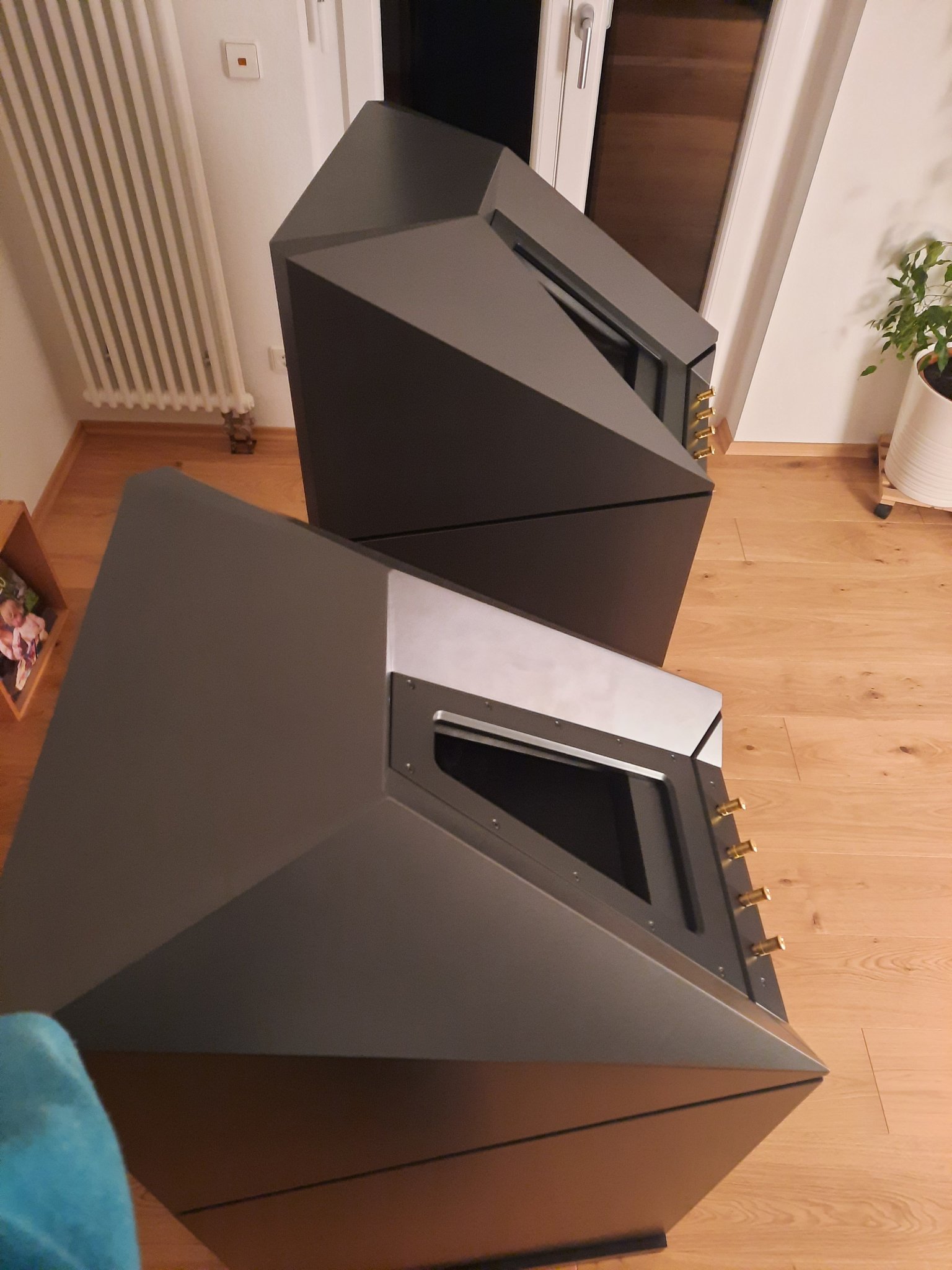

Finished with the clear coat on both. Time to rest and think about the grill
What about grill color 🤔

Noam, I think after those photos, half the internet wants to kill you, the other half wants to marry you
I fear that so few have the skill, dedication, and eye for detail you do.
As for grill colour.
Since the cabinets are super dark grey.
You could match the cabinet colour.
But I think I'd contrast the cabinet colour with black or a medium to dark grey.
I think any other colour choices could look strange.
