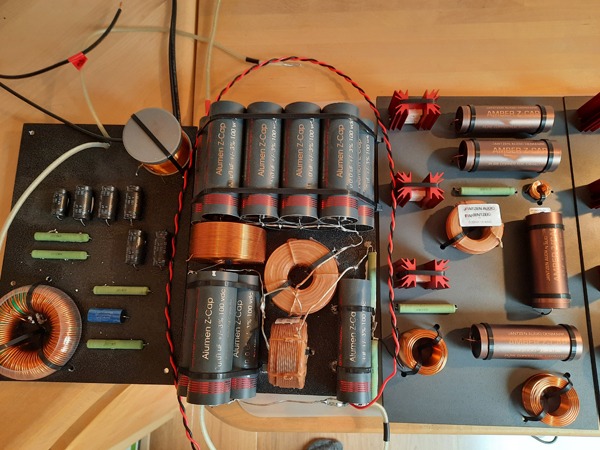

I am using the passive Version. Level 1.Du you use the passive or active version? And what amp do you use?
I have replaced the Jantzen resistors for the new mundorf ultra resistors
This crossover wouldn't pass any border control.

Those boards look really great!
Which ones are the Mundorf Ultra resistors, please?
What are you using the heatsinks on?
Are you using the tag strips on the underside of the board?

The big Red heat sink are for the smallish mundorf ultra resistors.Those boards look really great!
I bought them since Magico are using them in the a5 speakers and are writing:
" In addition, the crossover debuts Mundorf’s new M-Resist Ultra foil resistors for unmatched transparency, liquidity and power handling."
Since I still have a soft spot for magico, I had to try it for myself.

I really don't know. But level 1 is loaded with fancy copper capacitors and the resistors are a bit... well, plain. So I just replaced those in the signal path for the tweeter and horn... if it supposed to make a difference then, it will make a difference in this erea.Is there a big gain in upgrading to mundorf ultra resistors?

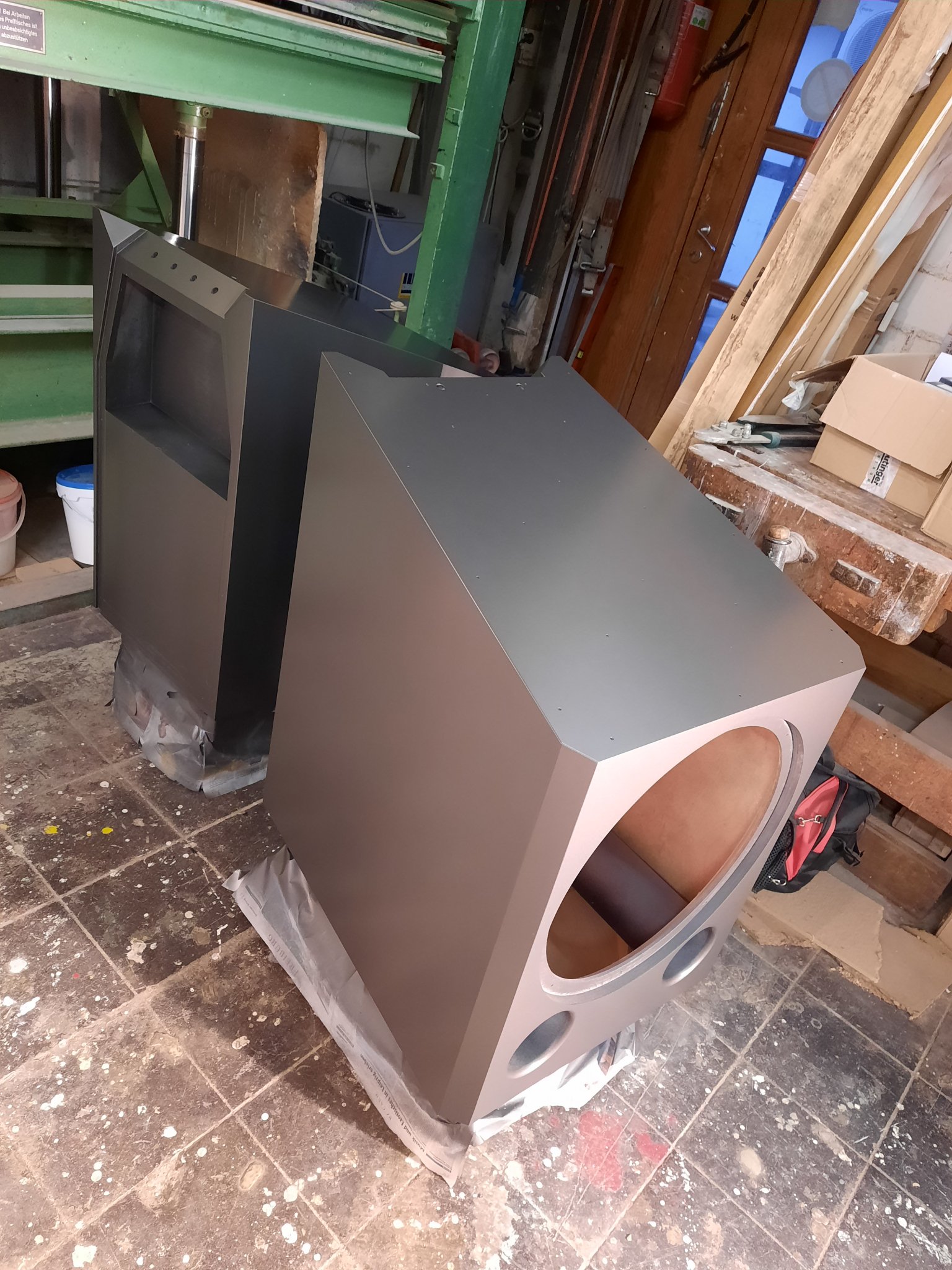

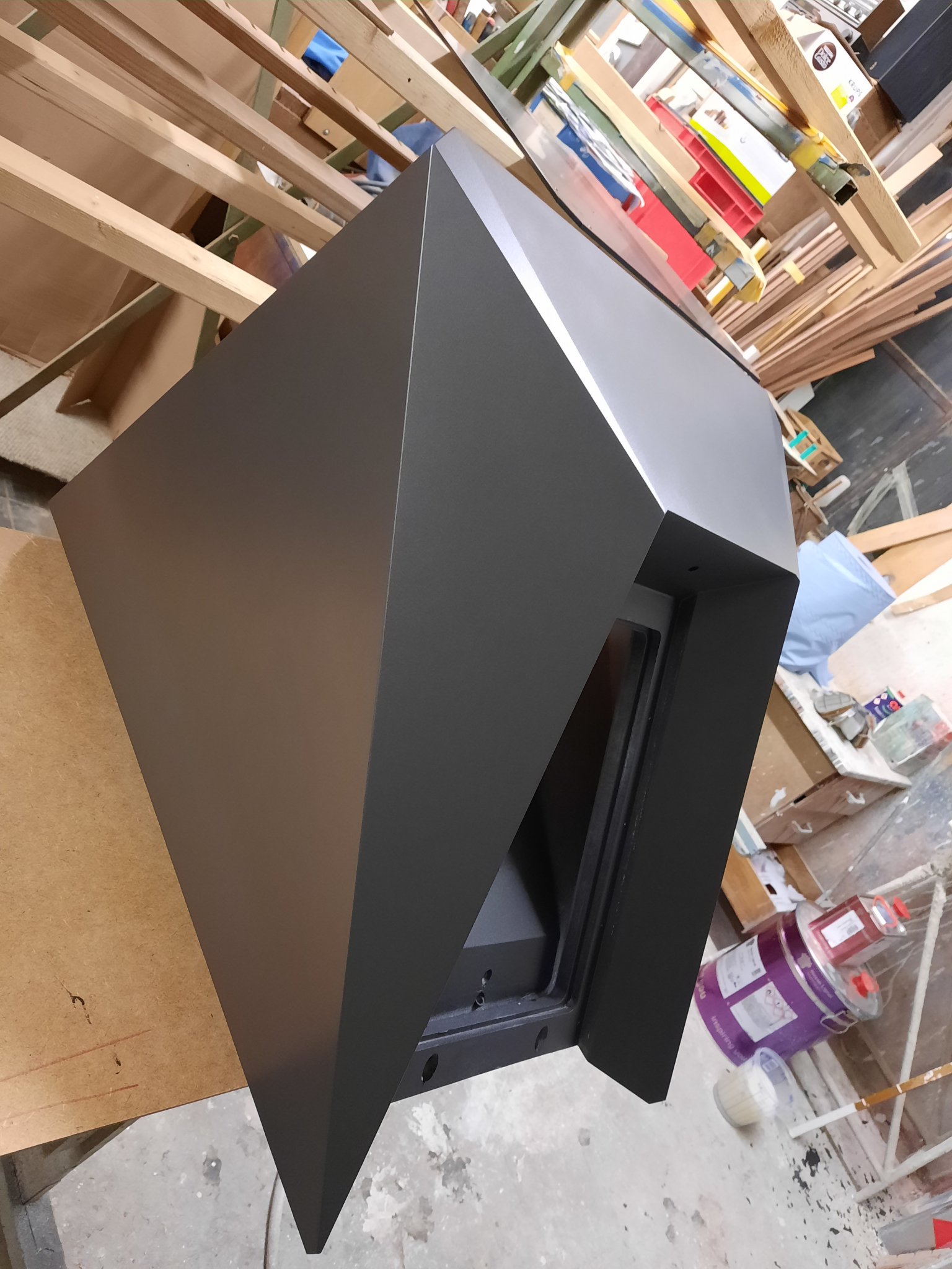

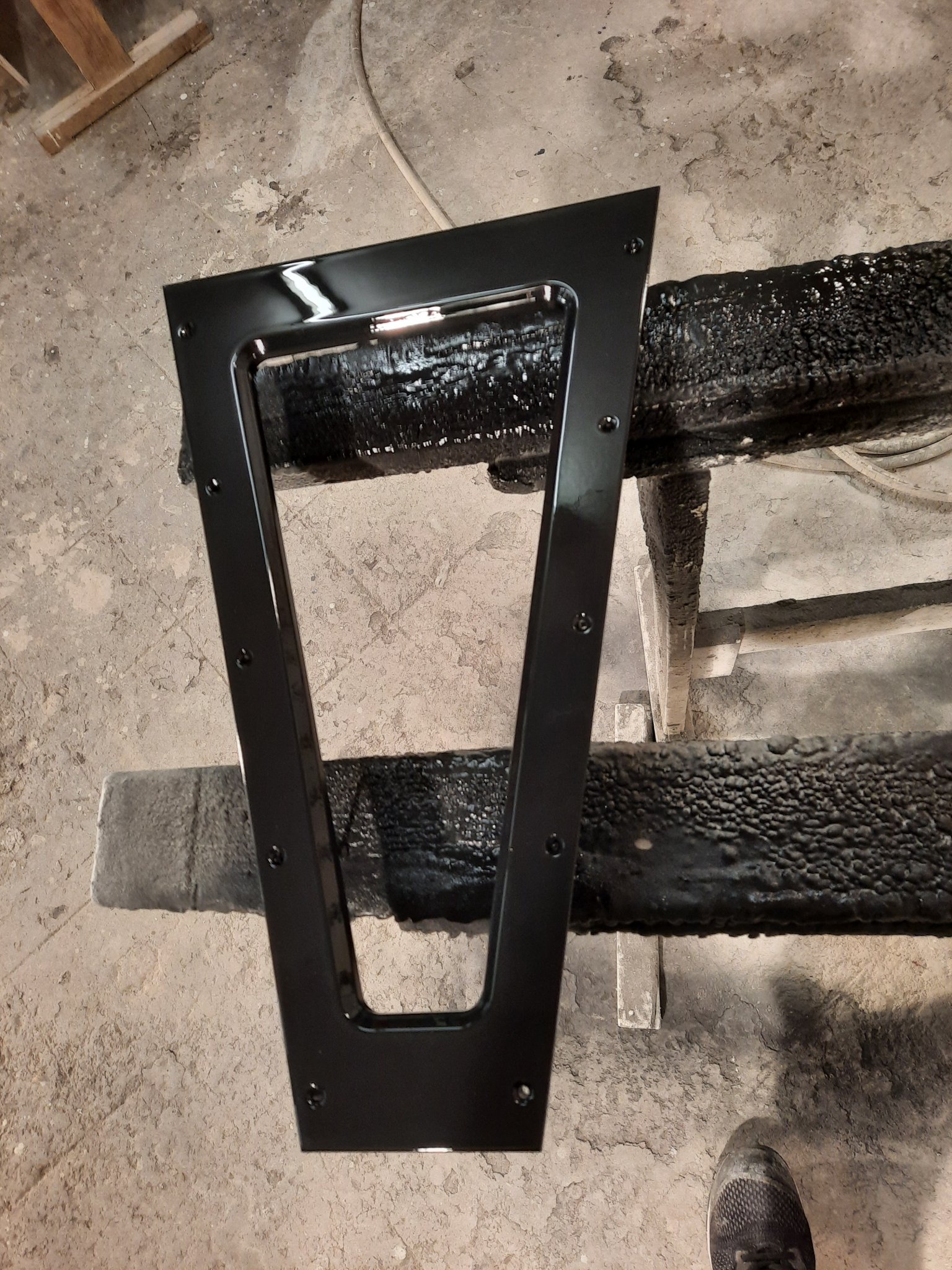

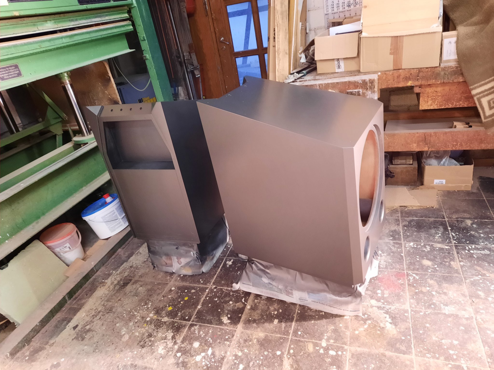

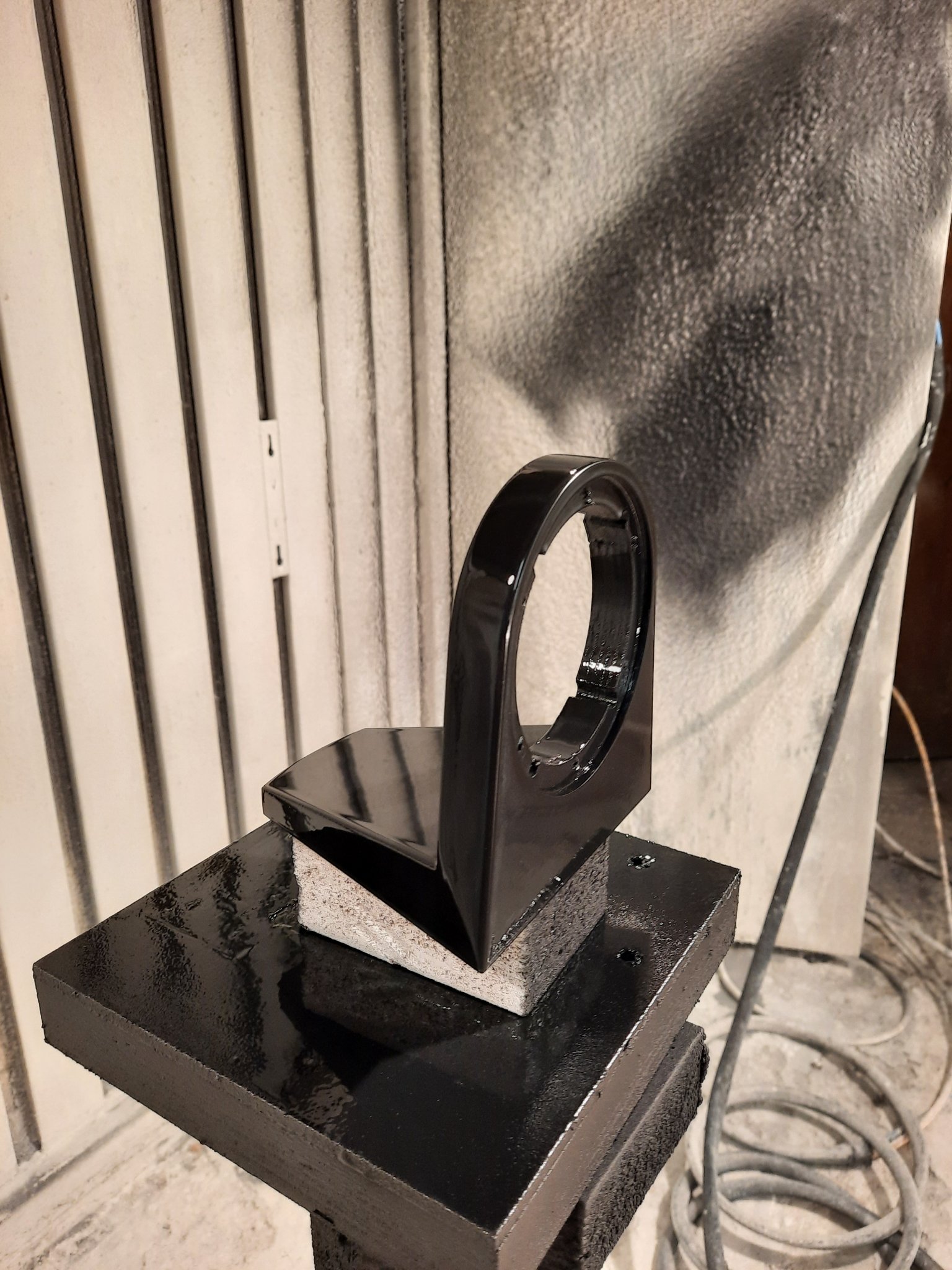

I just been painting first coat of colorand what I got is-
Eeeeeeviiiilllll, I present you Darth Vader
Yep, clear coat on everything and that's it for color, I'm done ✔ next stop, putting everything together
hashtag #killerwoodworker,
the wet dream of enclosures.
are these the set of speakers for your client, or do you intent to put veneer on top of the black lacquer?
🙂 thanks!hashtag #killerwoodworker,
Those are the speakers for my client. The color in reality is much much darker. Think Dark coal. Batman was never really my thing... but if he had a speaker, that would be it.
