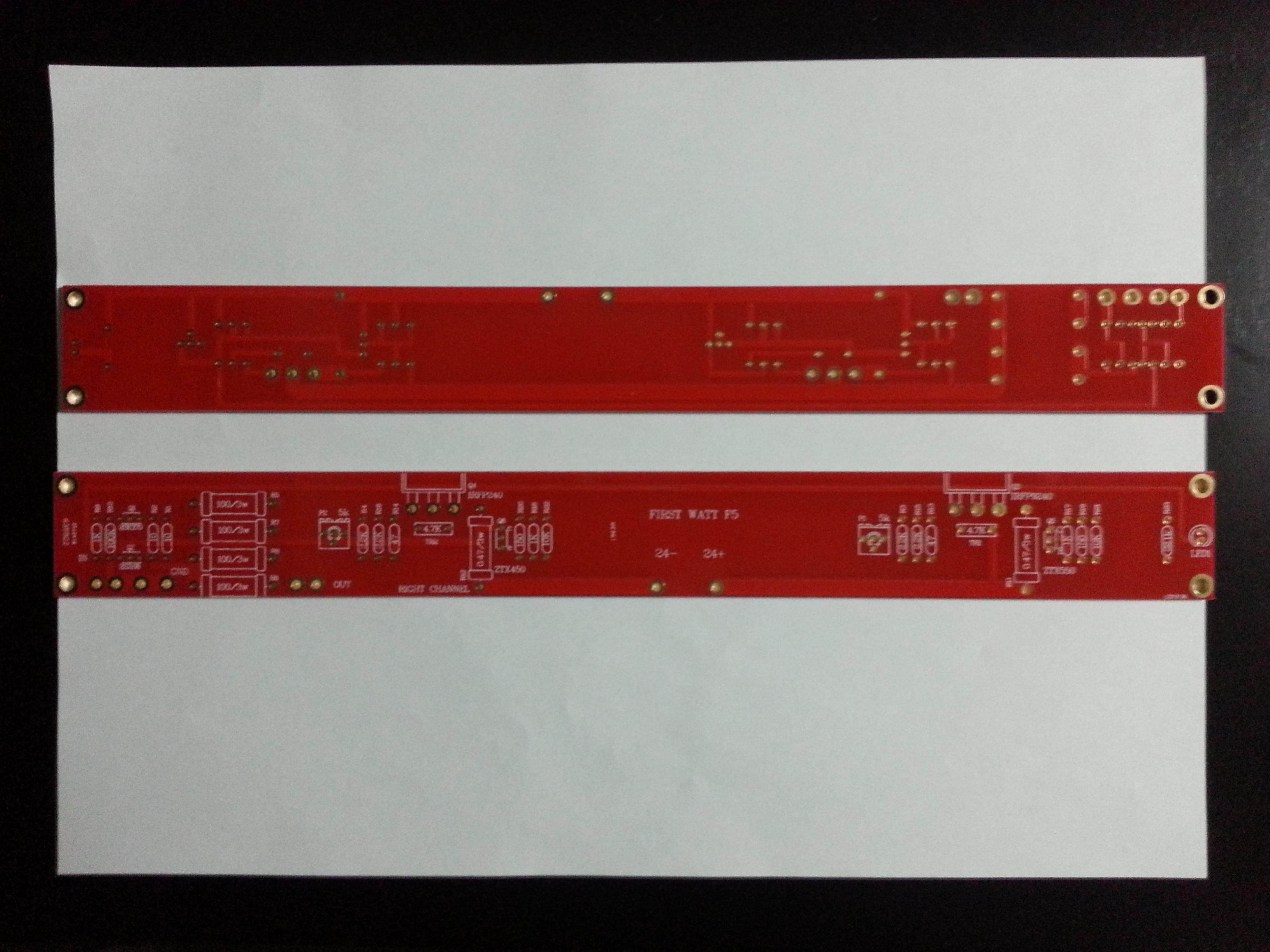

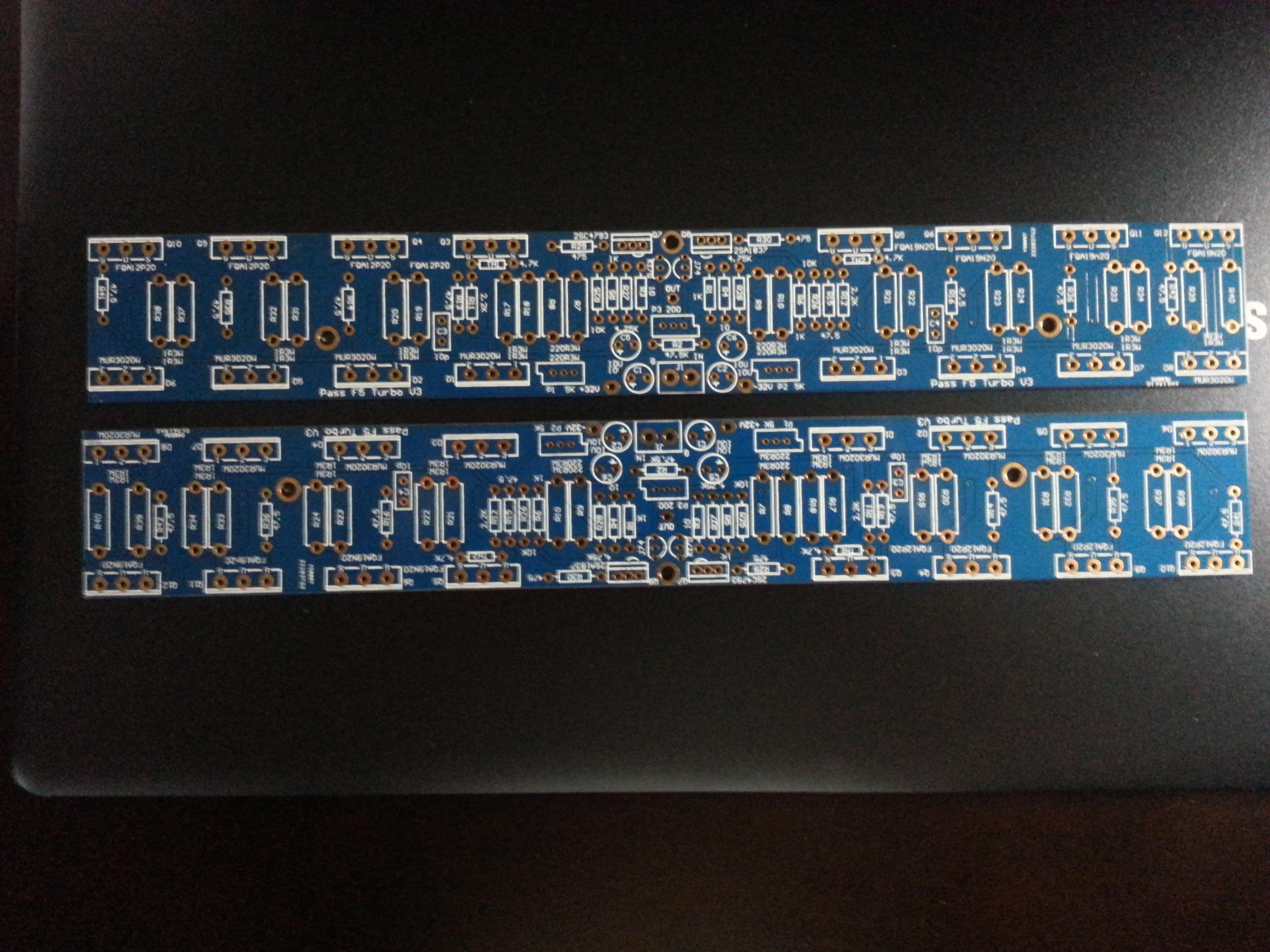

One is the F5 (red) and one is the F5T V3 (blu).

Reading the guide built of Salomon I contact him for the PCB and he suggest me to look on Jims Audio in ebay. Now I have 2 channels of F5, 2 channels of F5T v3 and 2 channels of AlepX that look very nice
Received the V3 PCB I ordered the 5U 400 chassis from HIFI2000 that look very big and nice but reading this threat I understand that the V3 stereo in one chassis is not the best chance so I thinking come back in V2 using the PCB of V3. The picture of the board is attached. I check the PCB and look exactly as per NP schematic.
Somebody have used already this PCB? I think that can be easly used for the V2 bypassing the cascode and installing 2pr instead of 4pr.
