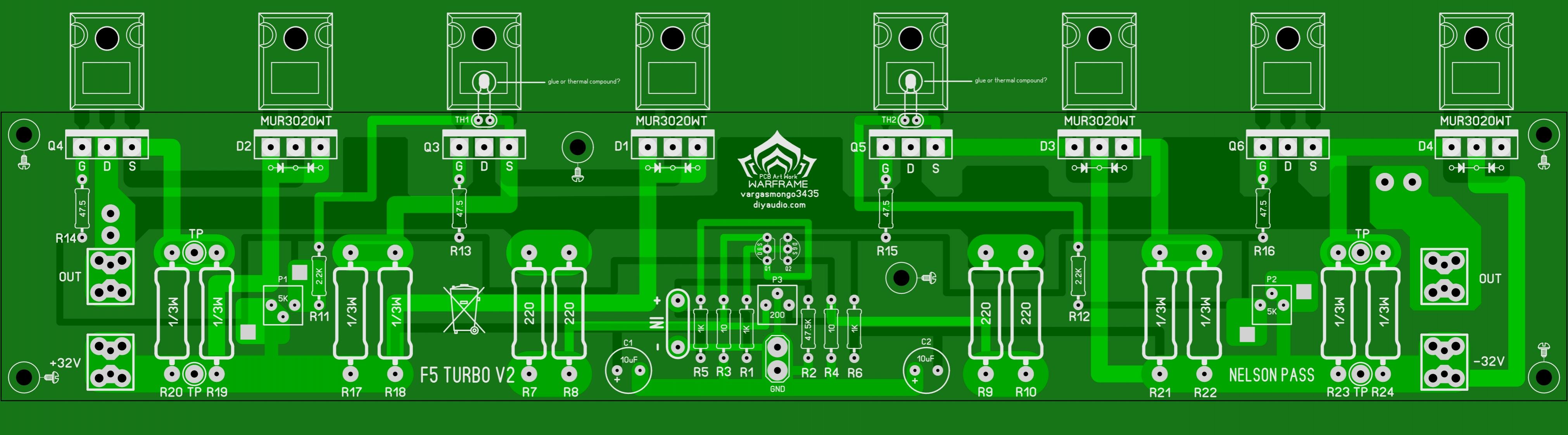

hi guys this is the first time I draw this PCB I have a question the TH1 and TH2 they go on the Q3 and Q5 do they need glue or just thermal compound or does not need any at all? oh note the power semiconductors are there only for illustration purpose
Glue is fine. They are there to make the bias circuit compensate with the increase in the mosfet tempature.
thank you I'm gonna continue on the PCB layout making sure that there are no bugs 🙂
