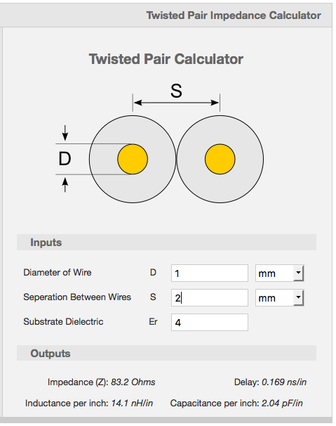

I think that twisted wires will minimize the pickup of hum, because the loop area between the wires will be small. Or is the resistance/impedance seen by the wires (on the FE board or the power boards) too small for efficient hum pickup?
Twisted pairs (or wires that are close to each other) may also add some inductance and capacitance. According to some online calculator tool, the capacitance of a 50cm long twisted pair would be in the range of 30 pF, and the inductance in the range of 200 nH or so (see attached screenshot; depends a lot on the thickness, distance and insulation of the wires).
(How) Would that affect the performance of the circuit?

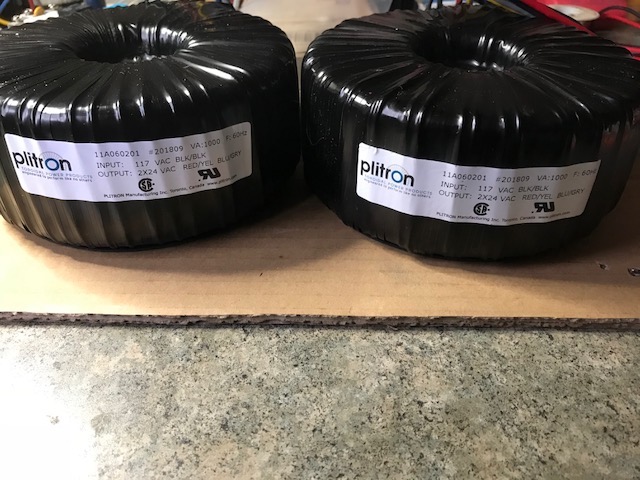

Hey Guys
My transformers finally arrived today so I am ready to start wiring everything up. I just need a matched pair of JFETS from the DIY store when they become available.
My question is whether or not I need one speaker protection board(from the DIY shop) for each channel. I am already going to use one inrush board per channel as I am using a 1000VA transformer and 264,000uf for each channel. Does it make sense to run two speaker protection boards or will one suffice. This is a single chassis dual mono build.

If you want to stay double mono.... yes, you'll need 2 protection boards - 1 per channel
