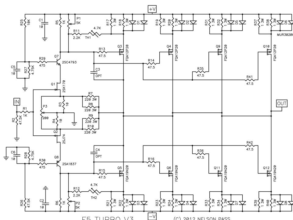

The short story is that the compensation cap from gate to output (marked as C2 on the output boards, but marked as C3 and C4 on the V3 schematic) needs to be used. 1000pF is working well.

"The short story is that the compensation cap from gate to output (marked as C2 on the output boards, but marked as C3 and C4 on the V3 schematic) need to be used. 1000pF is working well."
I have attached Nelson's V3 schematic. I haven't seen the schematic of the board that 6L6 is using, but have seen the photos of the board. Evidently, C2 on that board is acting as C3 and C4 on the V3 schematic I attached.
6L6, please correct me on this. Is there one C2 on the board you are using that can replace both C3 and C4 on the schematic? This doesn't seem correct to my understanding, but I am normally pretty confused. Might you post a link to the schematic (maybe you did and I missed it. If so, sorry).
Regardless, I am attempting to understand whether C3 and C4 on the V3 schematic (attached), and thus, C2 on 6L6's board, are simply passing high frequency AC back through the feedback circuit to dampen the high frequency oscillations that were contributing to 6L6's repeated loss of MOSFETs, or whether there is some other action of these components. And I was interested in what frequency range might be passing through the capacitors, which would imply what frequency range was responsible for overload and loss of the MOSFETs.
Nelson wrote:
"Depending on layout and other little issues, we might ultimately have to consider using capacitors to perform frequency compensation which have been absent (along with coupling capacitors) in previous F5 versions. In actual testing I found that ringing and oscillation issues can be dealt with by optional C3 and C4 in values ranging around 1 nF. An alternate location where compensation can be performed is capacitance of similar value across the feedback resistors R7 and R10. I did not encounter oscillation, but at these bandwidths we are working near the edges, so it's a possibility."

At the risk of stating the obvious, looks to me that the compensation caps are needed now because open loop gain has increased a lot due to the paralleled outputs. One thing that might be worth trying (if you wanted to avoid these little caps) is to maybe increase the input jfet source degen resistors to 20 ohms or so. Its a bit of a hassle though because the 220R feedback resistors will also need to be changes to 470-480 ohms.... Anyway just fwiw - great thread btw.
