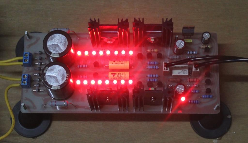

Today I almost done it, I want to test the voltage first before put the missing 2SK170 pairs
because I can't get 1.8 volt LED's so I use 1.88 volt instead.
I hope nothing bad happening 😉
Regards

DCB1 is Ready to Rock

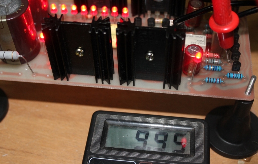

Hi all...
I measured the voltage today & they are okay I guess 🙂
so I put the 2SK170 pairs & they are a bit warm 😎
Hey, they are working :drink:
maybe tomorrow I will surprise with the sound
Warm Regards 🙂
All Ok, thanks to all
Fine until now. Verify that the relay clicks to engage the audio outputs. You should measure some DC offset at the audio outputs. If it is lower than 5mV it is acceptable.
