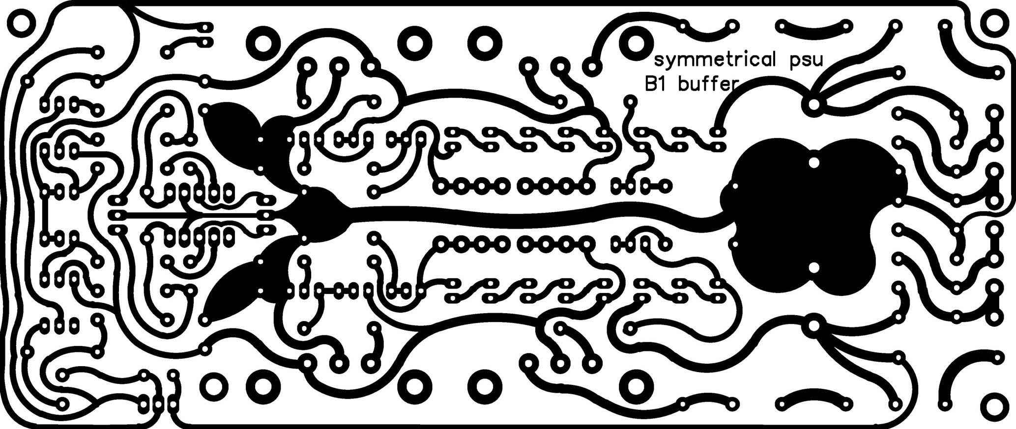

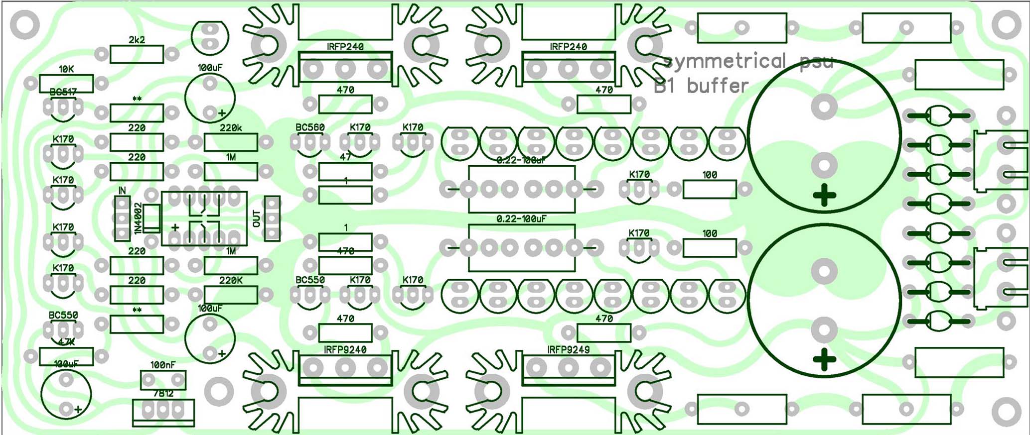

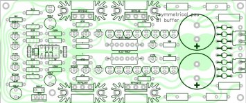

here's the layout...

Making the B1 with symmetrical ( +/-) supplies makes it possible to go capless or DC-coupled with the B1.
1. By trimming the supplies a bit non symmetric, the output offset falls to either zero or under half mV, steady. It counteracts naturally non perfectly alike JFET pairs.

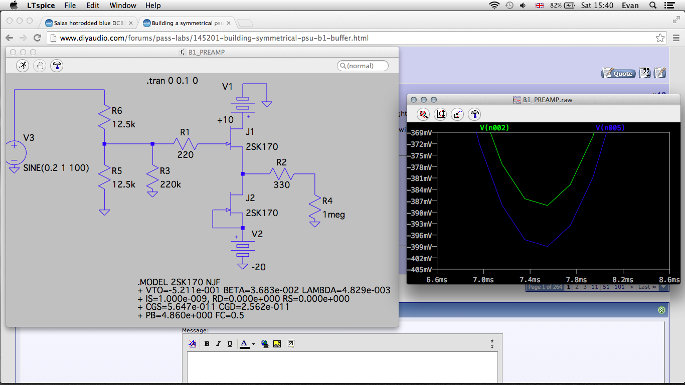

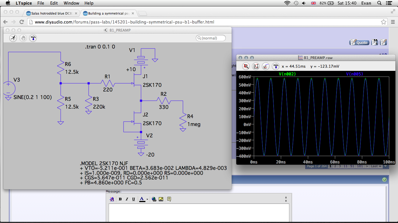

I know I am coming to this waaaay late but please bear with me.
I have a couple of questions about how this circuit works. I have simulated the whole thing in ltspice. No matter how much I trim the positive and negative supplies I can never completely eliminate the dc offset. With +10V / -20V I can only get up to 15mV off the original 100mV injected dc offset so it's not really going to work unless there is a decoupling capacitor downstream.
Is this a limitation of the simulation software perhaps?
Also I've not seen any trimmers on GB boards to adjust B+/B- to remove the dc offset. On the contrary the shunt regs match B+/B- very closely indeed.
I can understand the benefit of ditching 2 caps over the original B1, but from my simulation I show that at least 1 cap is still required. That is still minus 1 cap per channel but one can't rely on supply trimming to remove say a 100mV offset.
Am I missing the point somewhere?
PS: Could the same trimming functionality be achieved on the original B1 by replacing one or either of the R2 R3 10k voltage divider resistors with trimmers? 😉

The real dcb1 gives +/-1mV dc offset quite often in reported builds here with just good idss matching of the signal jfets. Because I had an LM317&337 original test bed with trimmers for evaluating the signal circuit, moving the supplies a little had a measurable impact on dc offset. I had a picture of it with 0V in yr 2008 by trimming the supplies. Staying put on same afternoon temperature at least. It is somewhere in the original B1 thread, if I will find it I will re-post it here. Don't ask too much from this kind of spice jfet models in general, they are just rough and ready.
Indeed. I thought it might be a limitation of the spice model too. If you've tried and tested it then that's good enough evidence for me that the supply trimming does indeed do the trick 😉
What's the best way to incorporate some trimming functionality on your shunt regs?

You could botch a 500R rheostat instead of an LED per side. Its not productive though, the offset is already very low. If you don't mind that and you wanna do it out of curiosity, its up to you.🙂
