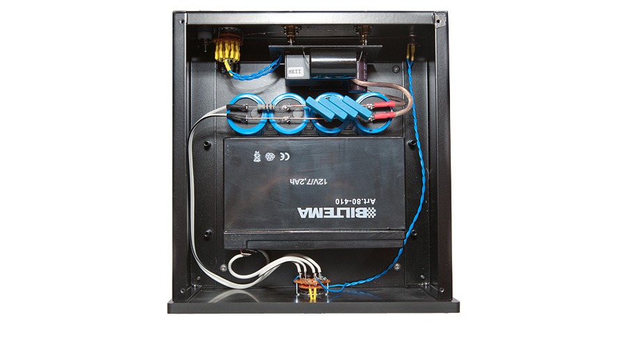

Building a symmetrical PSU B1 buffer
Historic! One like this?

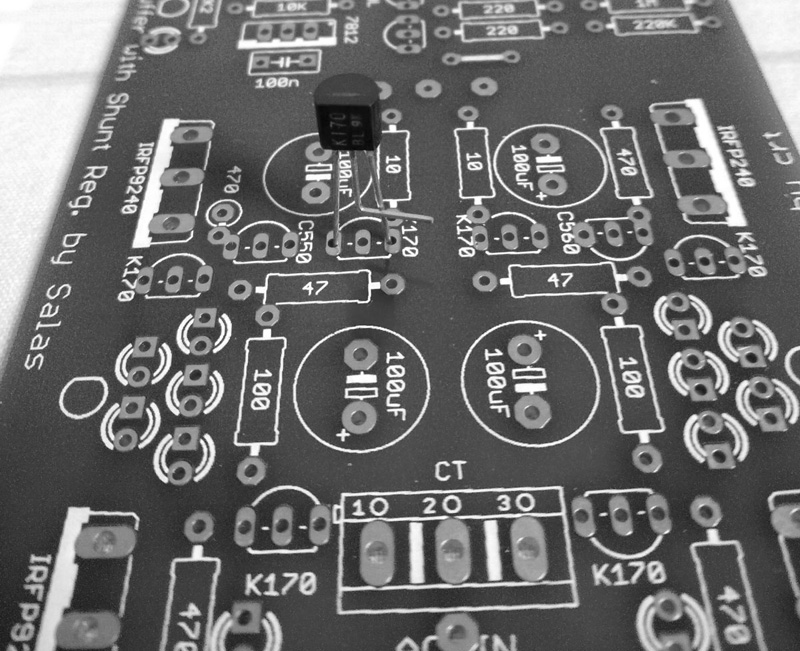

That one is good to run as is at 60mA. No sinking. To make it symmetrical Vref for running it better at high mA you got to do this leg trick for that specific JFET only. Solder those two legs together and insert it as a two pin device. The original issue board connections will do the rest.

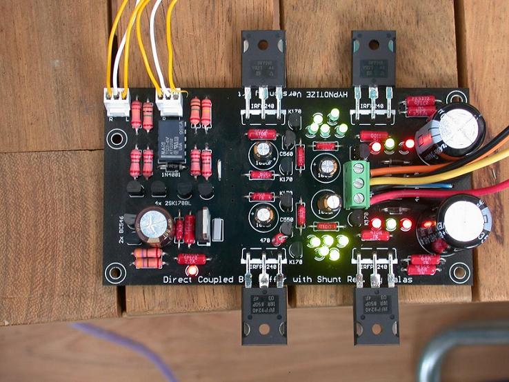

I will attempt to use 2SK170V in the B1
Dissipation will be 10V*IDSS in DCB1. Type V has much IDSS. 15mA example will run at 150mW. Better don't run them unassisted like this. They may fail for longevity. There are TO-92 mini-sink hats to find in vendors. Or you may come up with a diy solution. High IDSS is good for DCB1 signal quad JFETs. THD and output current spec gets better. But those JFETS when beyond BL range should be running heat exchange assisted.
Ah yes I definitely will be heatsinking them. I have many 100's of 2SK170, I need to put some to use.
Can you confirm that the asymmetry is only because of the N/PMOS difference and is undesirable? I suspect my memory of 2SK170 asymmetry is of a refinement of the F5 whereby the 2SK170 is degenerated to match Yfs of the J74
The asymmetry I had embedded in that particular issue was in the Vrefs of the PSU to aid lesser matched signal JFETs offset and promote little more second harmonic because it was running low mA lest it would sound bit dry. It could be readily seen in the positive side 5X Leds cluster shining bit brighter than those on the opposite side. Positive is bottom side in #2742 post's picture.
In DCB1 there are only NJFET used so its not the same as with complementary pairs.
As for the PSU NMOS and PMOS power MOSFETS you don't need to match VGS in this.

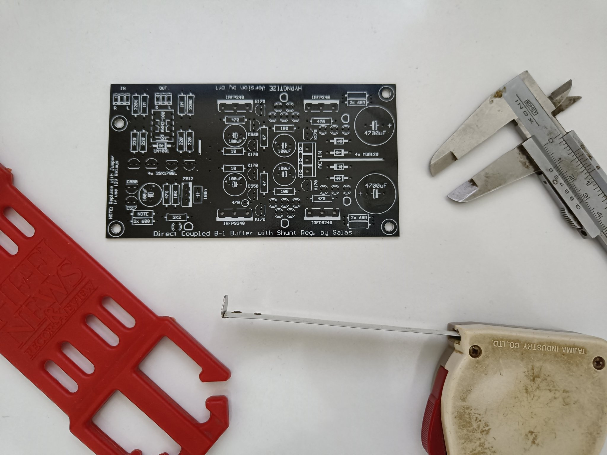

Luckily I had one such board and it measures 122mm by 68mm. It accepts five 100uF 5mm pitch 10mm max diameter electrolytic capacitors. Also two 7.5mm pitch 18mm max diameter 4700uF. Use no less than 25V spec for all electrolytics. Preferably 35V. For all resistors it allows 12mm leg to leg bend distance. It accepts four 1A rectification diodes at 10mm leg to leg. And one same dimensions flyback protection diode found next to the relay.
The Omron relay code printed on the PCB is not available anymore but you can alternatively use KEMET EA2-12NJ or NU.
There was a BOM indeed but not relevant for codes today. Still all component values are printed on the face of the board.
Its a single layer board with a couple of over-paths so don't forget to jumper over the two white lines end points. A long line at AC IN area and a short one next to two resistors near the output area. Also jumper the resistor with the NOTE word in it since the relay I suggested is a 12V type.
Very good info you brought.. now I can start pick some parts. Board is a bit smaller than i imagined, but that is a good thing.

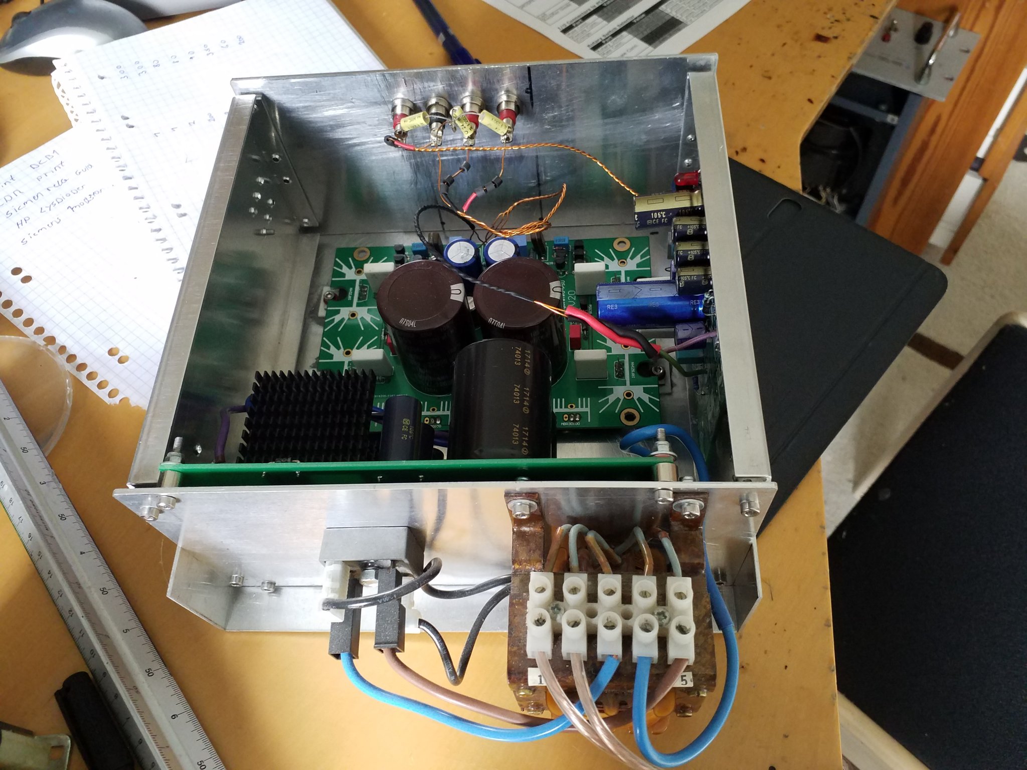

Attached photo is the leftover chassis mc tube preamp
Pros is you get to utilize it and it maybe makes the whole thing a little bit better. Double regulated dual box hi-end configuration appeal and all that. Cons would be unnecessarily spending money and expanding to dual chassis for a an uncertain % of extra goodness vs just a small transformer in one same chassis if you didn't already have that PSU.
By the way keep in mind that LDR is active attenuation in a way and brings second harmonic vs a basically well working series type potentiometer. How much depends on the specific type's photocell linearity and how its driven. It can be more likeable than most transparent I mean. You got to compare the two solutions on your own of course.
