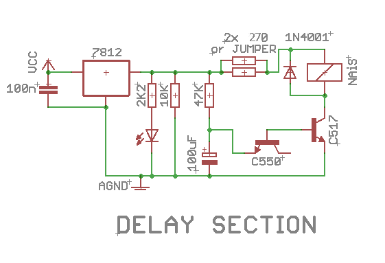

I'm getting 12V across the input relay, 5.15 across the output. I can't see a couple of the cheap resistors under the LM7812. That's the only thing reasonable?
That's good news because the 7812 isn't pulled down and the problem seems local to the output relay's circuit. If local parts are missing or having wrong values or faked its very reasonable to have a problem there.

That, and I am getting the 12.8V across the diode next to the input relay. 12.8V from cathode side to ground while activated, almost 0V from anode side. The uncharged input relays have 12.8V to ground from both sides of diodes, and nothing measured across the diode.
Now, hopefully a useful measurement:
The output relay diode is measuring 5.15V across it. From the cathode side to ground is 12.09V and from anode side is 6.94V to ground. Adding or subtracting any of these numbers gives the remaining voltage. Does this provide any useful information?
Yes, it informs that the LM7812 output is good. It also informs that the relay coil driver transistor isn't conducting. Thus the problem is in the parts of the delay control circuit.

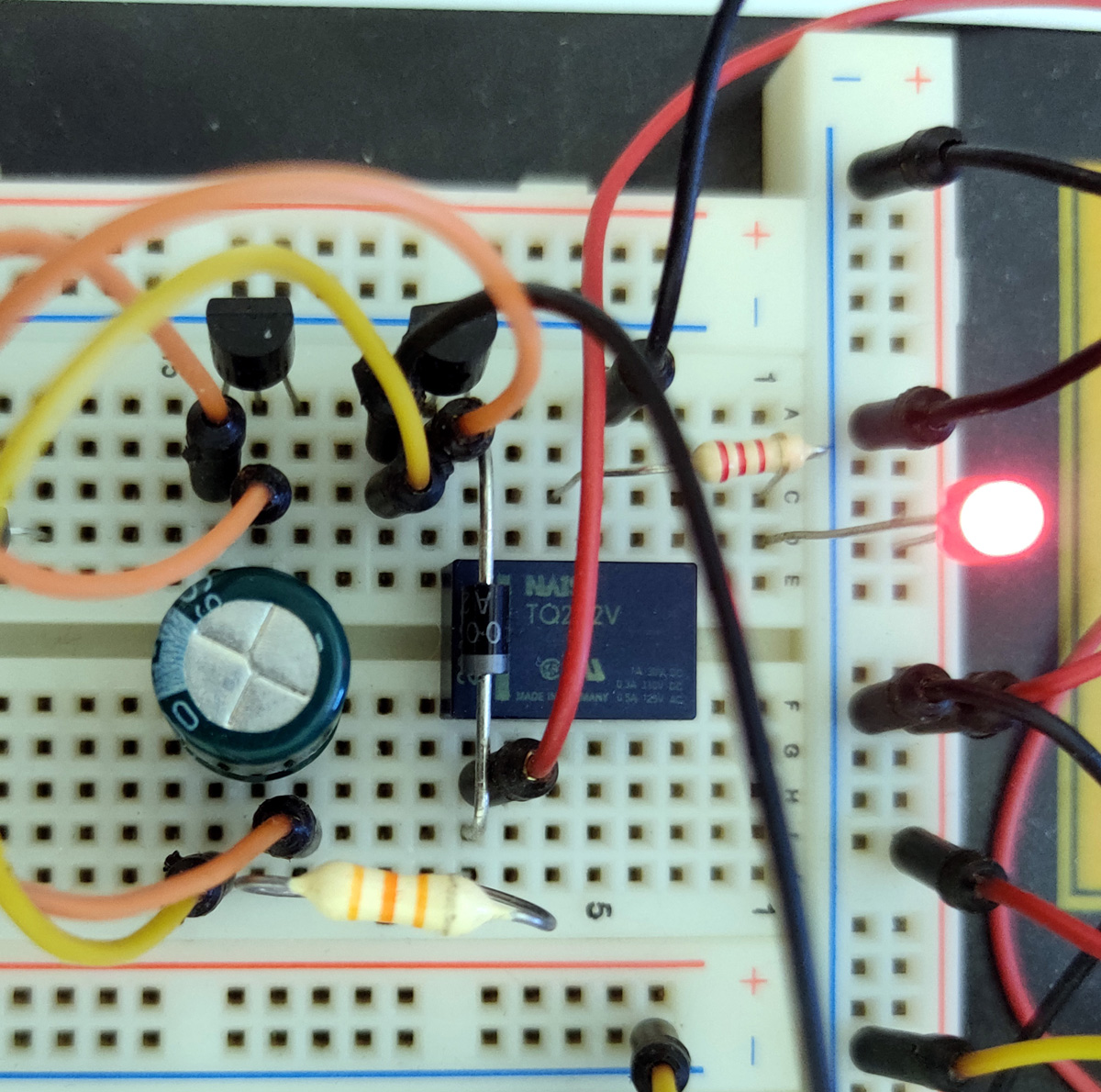

I freshly tested it on a breadboard to give you debugging check voltages. Powered with 12V from a bench supply. I put it to light an Led with its contacts. To can see what it does than just listening for clicks. Relay is the original NAIS TQ2-12V (same as the orange Kemet EA2-12NJ or NU).
With C550 & C517, voltage across diode/coil is 11.27V. C517 collector to ground 0.696V. C517/C550 bases to ground 1.307V. C550 emitter to ground 10.09V. For 47k 100uF RC it takes about 7.5sec to click/light. For 33k 100uF RC it takes 5sec. When starting from a long enough powered off/drained circuit state.
With both transistors C550 it also works (Fairchild CTA). Voltage across diode/coil is 11.80V. C550 relay coil driver collector to ground 0.168V. C550s bases to ground 0.723V. "Predriver" C550 emitter to ground 9.51V (actually applied like a Zener). Seconds to click/light almost the same as before.
*BC550 BC517 pinout is C,B,E 1,2,3 when facing their flat front surfaces.
