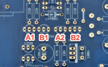

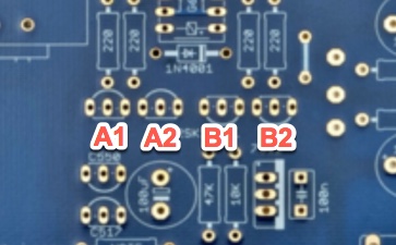

I'm picking this project up again after a few years and I'm still stuck on the same JFET matching question.
Many years ago, I bought 2 matched pairs of 2SK170BLs. When they're installed, how are the paired together?
In other words, if I have matched pair "A" and pair "B," are they installed like this:
Or should they be attached like this:
From AndrewT's comment here, I'd imagine it is the former image.

Order for 2SK170BLS
Tommy_O
The order for the two pairs is covered in posts 1805 and 1806 with pictures and measurerements.
