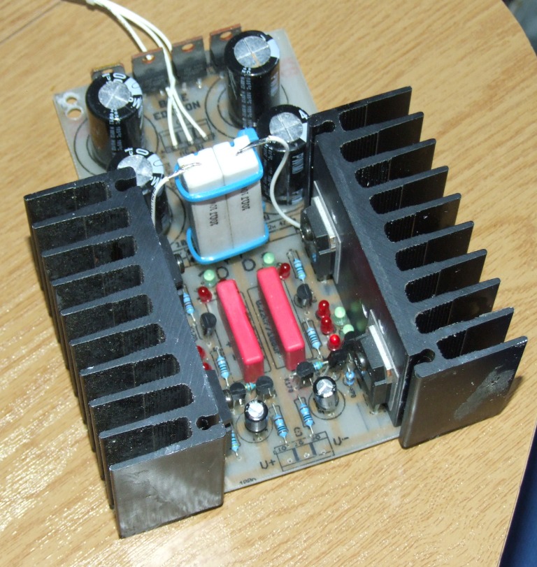

I couldn't hear any difference with running the SALAS Shunt Reg at currents above 300mA. In the end I opted for 160mA (ish), the MOS-FETs run cool and there is no danger of component cooking.
Irrelevant of the current the PSU is consuming, the B1's run at about 7-10mA each (determined by the Idss of the 2SK170BLs).
The 2E heatsinks run at a nice cool 30 degrees at 200mA but start to heat up rapidly above 300mA.
You will notice that I opted to use the SALAS Reg Supply part of the DCB1 but then used the B1 itself. I needed the capacitive coupling so the combination of the two suited my application perfectly.

That's very good sinking for 200mA or less. Have you got 1.6-2V voltage drop on the 10 Ohm resistors? If yes you surely run spec current. Maybe you can double up on them and drop them to 5 Ohm so to benefit from more current since you got nice dissipation bond to chassis.
Yes 1,6 V across 10 ohm. I will follow your advice and use 2 more 10 ohm resistor.
What abuot the 10 V output ? Short circuit one Led in each side ?

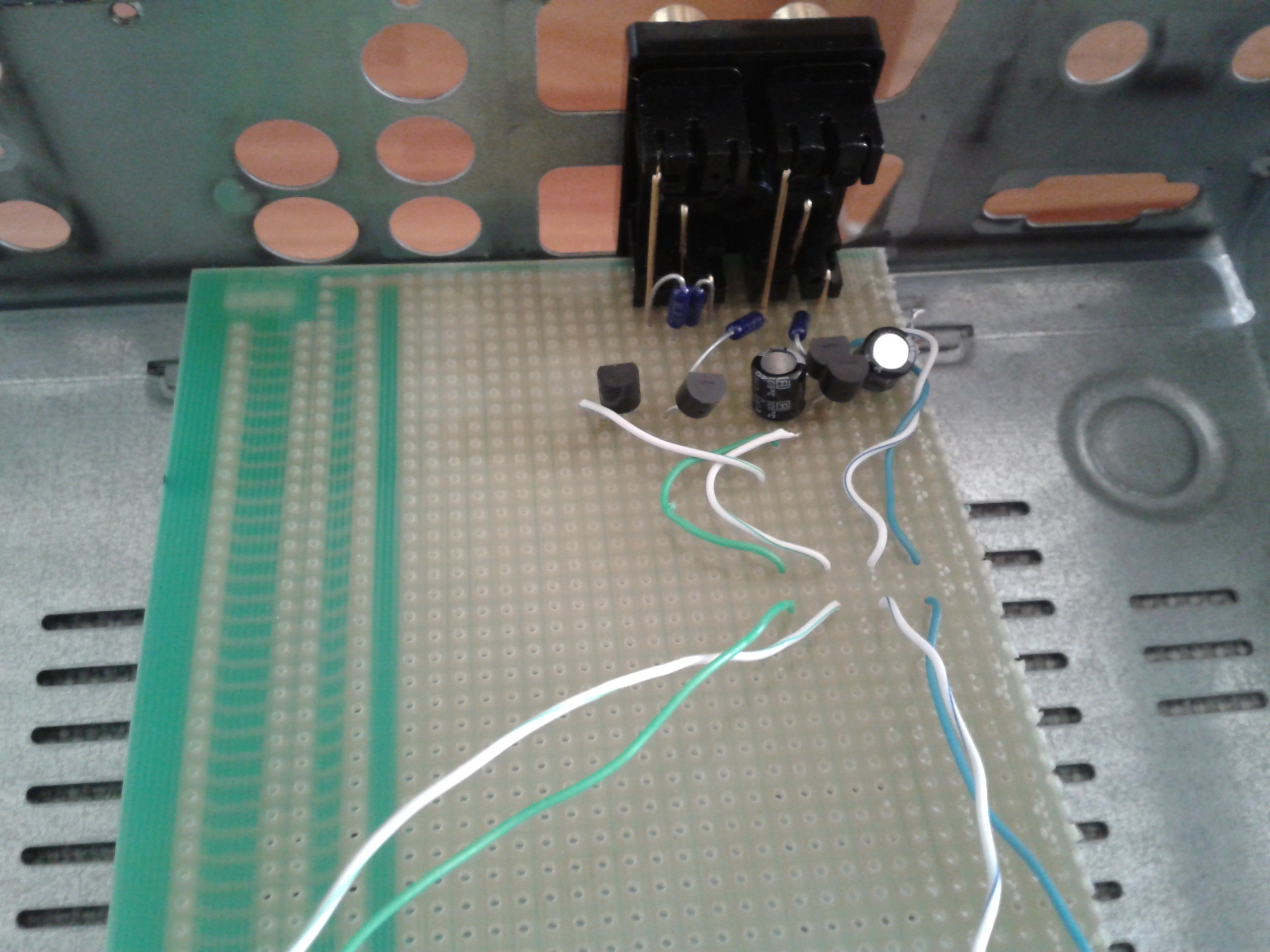

Hi everyone,
I've finished my Hypnotize B1, however it's not working now.
All Leds lit up, the current on one side is 40ma, on the other side, the current is 68ma.
I checked the voltage across the two 2SK170 for both channel, they're about 20.5V, so it seems that the voltage is correct. but I could not hear the relay click.
When I powered up, the green Led near the voltage regulator, lit up for half a minute then turned off completely.
I measured the voltage across the 10K bleeder resistor near the voltage regulator and saw that the votage dropped from 10V when powered up to 0v after 30"
I don't know if the voltage regulator (7812) working correctly? or something wrong?
Another thing is that since I did not have BC517, I replaced it with BC550.
Could you look into my problem and give me some advices.
