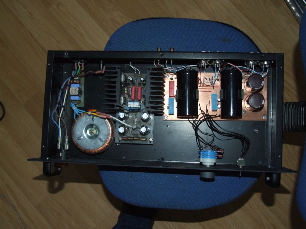

I couldn't hear any difference with running the SALAS Shunt Reg at currents above 300mA. In the end I opted for 160mA (ish), the MOS-FETs run cool and there is no danger of component cooking.
Irrelevant of the current the PSU is consuming, the B1's run at about 7-10mA each (determined by the Idss of the 2SK170BLs).
The 2E heatsinks run at a nice cool 30 degrees at 200mA but start to heat up rapidly above 300mA.
