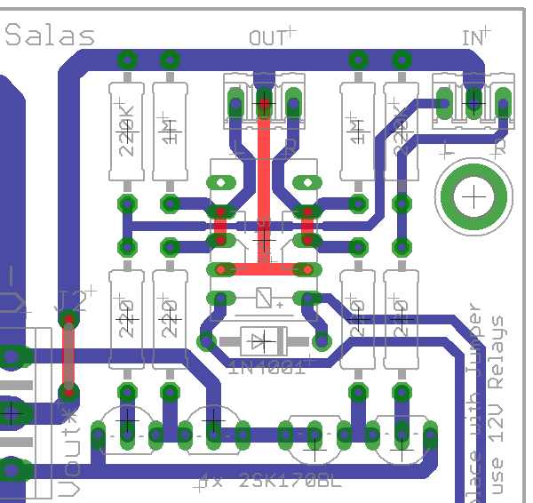

You need to modify the output relay for grounding at rest position too.

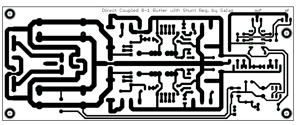

That seems a torturous routing for the 0V track.
I've taken a simpler route. Can't see that it makes any difference as its disconnected once the DCB1 is running.
You'll notice that the routing for the relay drive transistor has also been changed to accomodate the TIP122.

That seems a double layer PCB rather.🙂 If you will get any noise at the amp when relay is at rest position then you know. If not, all well.

The original layout was for a single sided board.
Did you poduce a board with a ground plane on the upper side.
My B1 is Double Sided but there are no traces on the upper side.
Would I be better with a double sided board, simply keeping all traces on the bottom side and the 0V on the upper side ?
