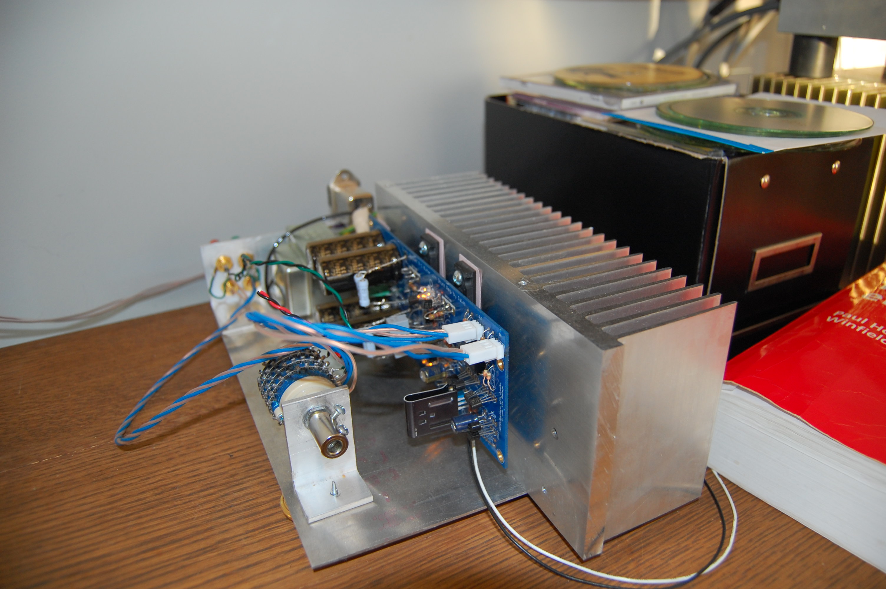

Katie and Dad. I mounted my IRF's under the board. I'll post a pic. It is very convenient. I am currently running mine at 1A. but will drop it back to 600 when i go dual mono. 600mA not as good as 1A, but i feel kinda guilty and i needed a heatsink for my house meter when i trun on all my Pass stuff. Boards are populated for dual mono, but I am busy with another pre at the moment. I am only using 12V secondaries and this helps with dissiaption, but i think some like the idea of more headroom suggesting 15. Using cheapo Radio shack trafo, BTw. I will couple the current B1 with a mesmerize for the dual mono option allowing for two psu's plus dual balnced input as well as one SE.
Here ya go. Like i said very convenient layout that Salas made. Also, the wire you see is Mogami neglex. Very high quality wire for very little money. OFCC and all that stuff. Stranded vs solid, but can't say i can hear the difference. I will try with dual mono with one side being solid and other stranded. Easiest way to compare.
Hmm, I see you have mounting space for exotica even.🙂

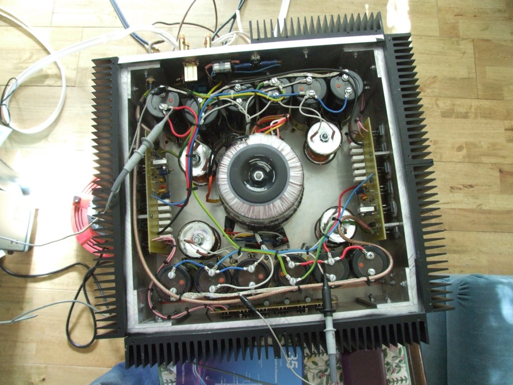

Just looking at your build.
Did it really need a heatsink that size ?
I'll be using a 20-0-20 Transformer (because that's what I've got).
Am I correct in thinking that the two MOS-FETs closest to the rectifiers will be dissipating :-
((20 x 1.414) - 10) x Iout.
If I use Iout = 200mA
That leaves me dissipating 37W x 2 of course.
I think I've just answered my own question, I got 4W first time round.
