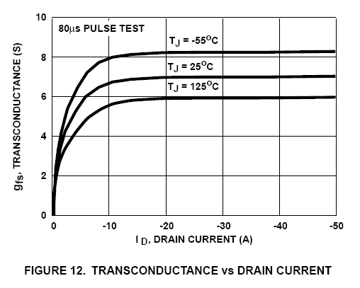

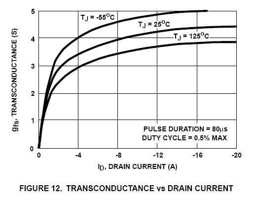

Yes, Juma's & Pass' reference to easier drive and improved linearity both come from higher Vds.
Transconductance is related to Id.
Changing the CCS current changes the Id of both the big mosFETs.
Transconductance of mosFETs depends very much on Id.
MosFETs run at low Id do not amplify well (due to low transconductance).
That's why I was surprised to see irfp240 being specified for the first DCB1.
It was asking the wrong devices to do the two jobs being asked of them.
That is why we now see/hear performance changing when we change currents.
We are moving the devices onto different parameters/characteristics.
The various Salas Shunt Regulators that followed the DCB1 were designed to perform with better layouts and better devices.
See gfs VS Id charts for IRFP9240 and IRF9530. Both from Intersil. I am not that good into reading them spot on due to lack of finer gradation and different x axis scaling. Looking roughly equal at say 1A? They did not appear changing Zo much in LTSPICE if interchanged at same bias currents in same regs non the less. (9530 is used in SSLV1.1).

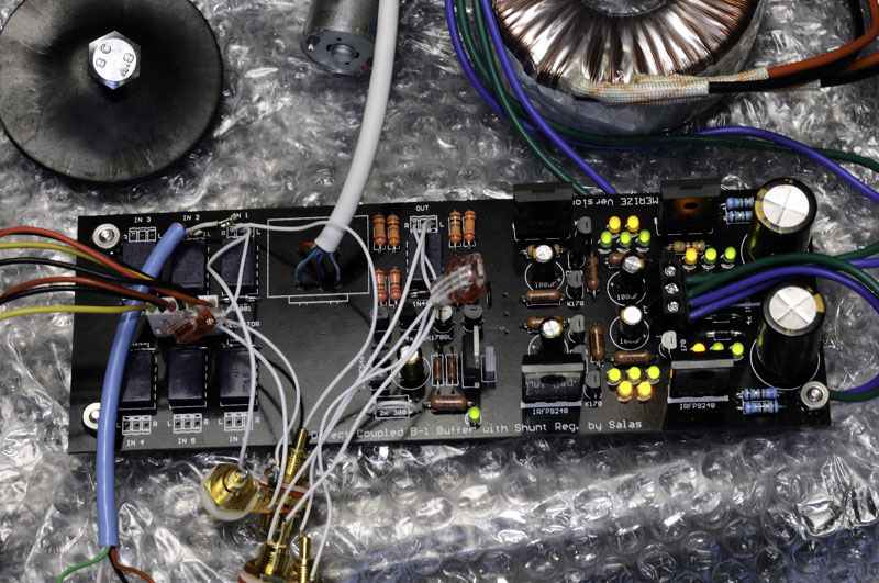

Has nothing to do with consumption. Has to do with the regulators. DCB1 is regulators 90% and a textbook SE CCSed JFET buffer. Thanks to Nelson Pass it was reminded that such a buffer it can be all there is we need in many cases. All I did was to treat it royally so it will give its 100%. I have given options on boards for setting anything according to each one's aspirations. Can run from no sinks to mega sinks. I originally specified TO-247s so to run without sinks on their own heat absorbing mass reliably at about 60mA per rail, and to have easy sturdy mounting due to insulated eyelet for heavy use if chosen so. IRP9240/240 are reliability dogs, another reason for their choice, especially in a DC circuit where if one rail goes, you get the other one's DCV smack on output. You will see many with no sinks and 12-0-12VAC Tx in the beginnings. People gradually voted heat by majority, its a trend. You experience, you decide. Its flexible. Just make it first.

Looking at POST 138 you are using traffic lights to acurately produce the reference voltages - Am I right in this assumption ?

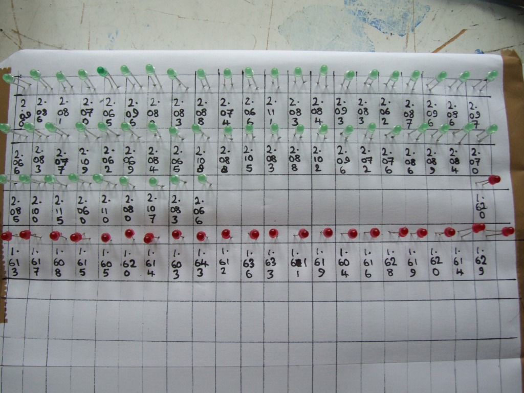

Measuring LED voltages
I've been busy measuring my collection of LEDs - well the 3mm RED and GREEN ones.
I reckon that the best match that I can get for 9V and 5V4 is as follows.
9V = RED RED RED GREEN GREEN. (1.61+1.62+1.61+2.08+2.08 = 9V0)
5V4 = RED RED GREEN. (1.63+1.63+2.11 = 5V37)
I can then match both strings to within 10mV of each other and the target voltage.
Is that sufficiently accurate ?

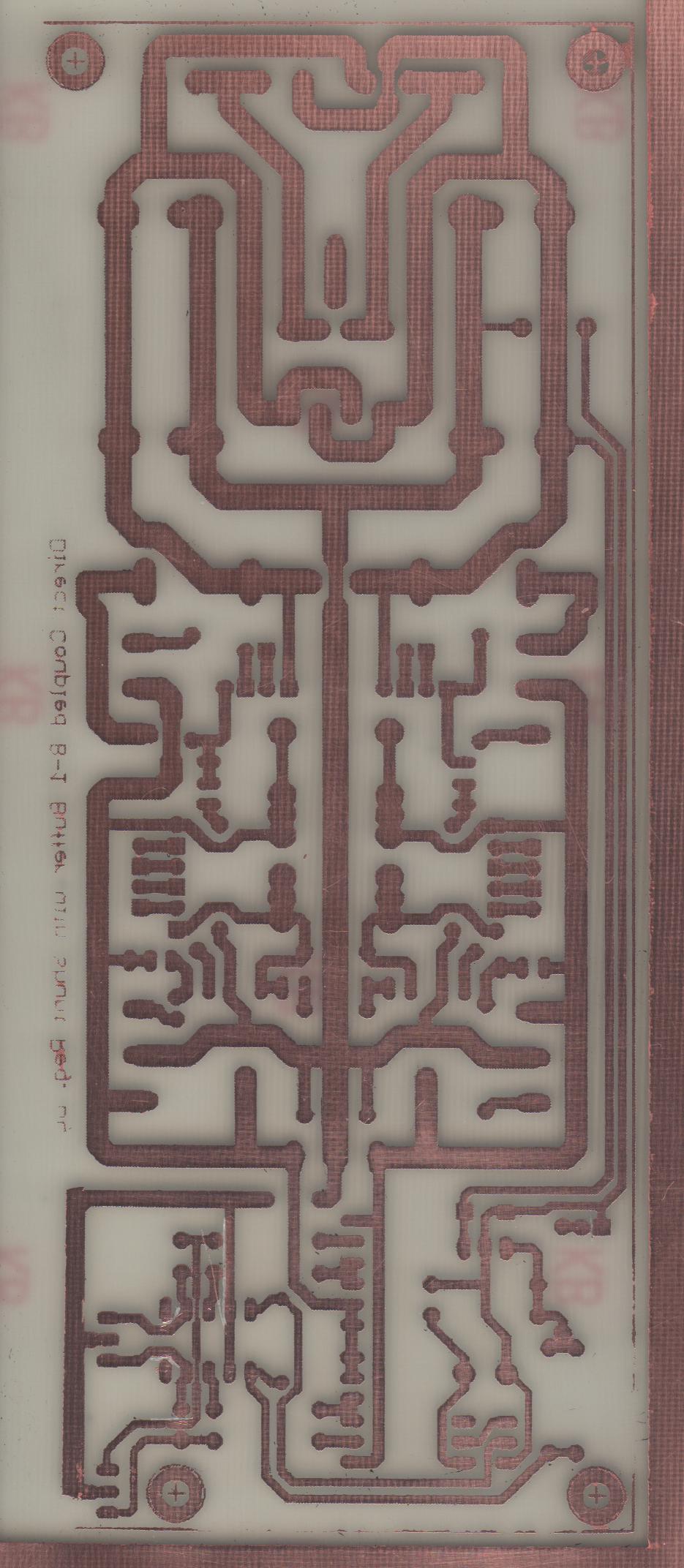

The only problem that I am having with the Toner Transfer method is that I have whiskers between tracks that I have to get rid of.
The photo etch process, IMHO, is far more accurate.
You mean the pictures of the black original boards in post 138 I guess. Yes some combine colors. Try 9.4V total, the old ones had an additional drop of a 10R that boosted the 9V a bit. No sinks low Id build that one. Easy to squeeze in crowded box.

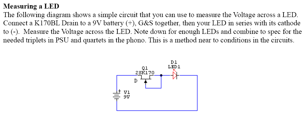

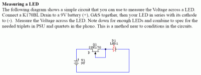

How did you measure those? This is the best method to measure near real circuit operating conditions:
I used a 5V regulated supply and a series 330R resistor to simulate a 10mA current.
I thought that would be accurate enough.
