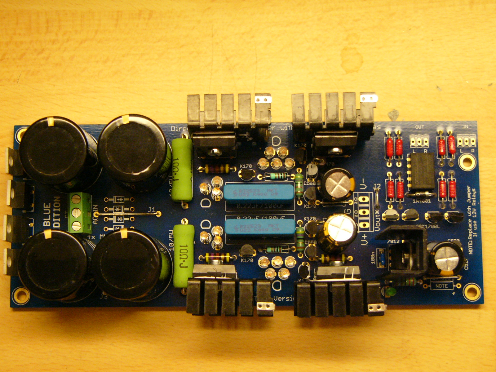

Almost done
Just waiting for x-former from France.
The Lightspeed is running in a mock up at the moment.
Now where does one find a suiting RIAA ? The NLE is a bit rich for my blood.
