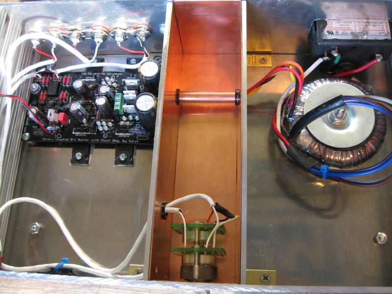

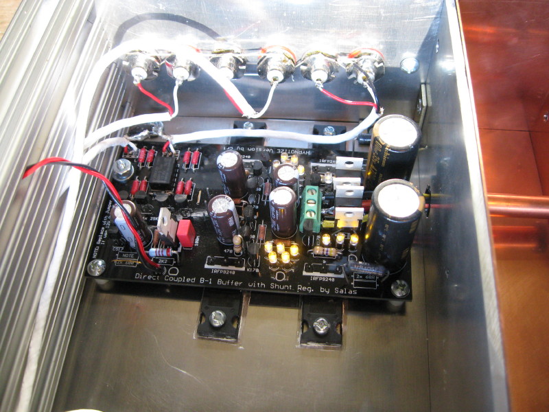

Another Hypnotize is born. Thanks for the help and props for the design and board work.

I've forgotten how you edit over here at DIY but don't follow my depicted mistake, above. I don't know what I was thinking but I managed to get the input and output wiring reversed. It is now oriented correctly.😀
Strange thing, I was driving along and was thinking about this project when it dawned on me. When I got home I brought this thread up and looked at the first attached picture from my previous post. Yup, I are backwards.😱

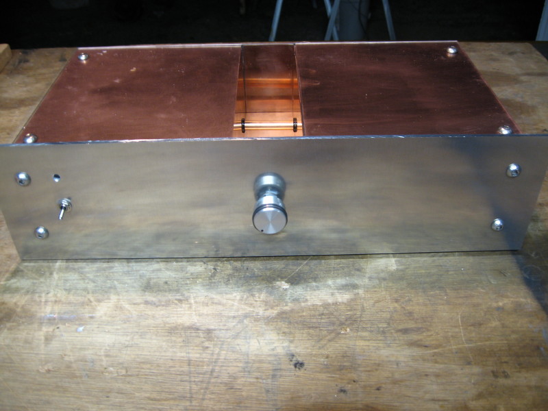

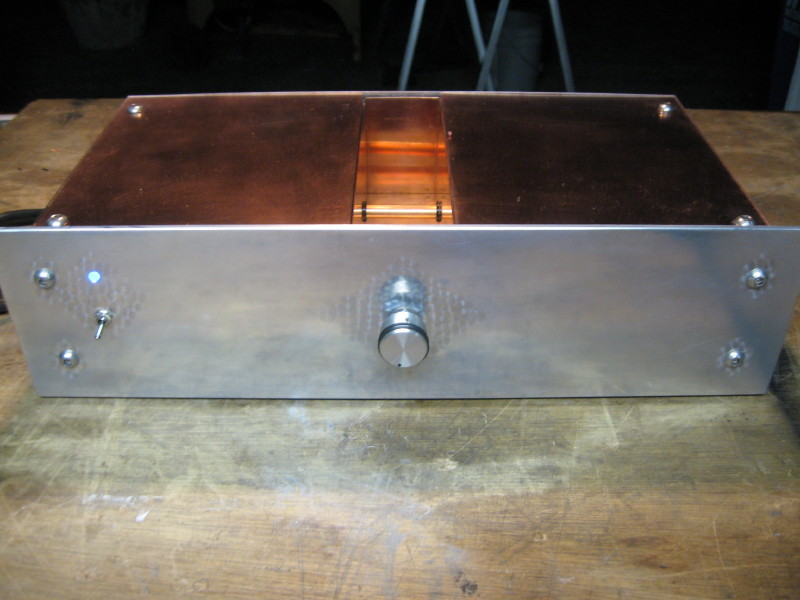

Attached is a picture of the finished case. Mr. Fud is going to like this, methinks.🙂
