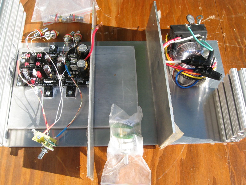

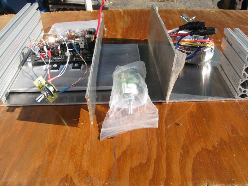

I am helping a local member to build a case and wire the "Hypnotize" version by crt. The board came to me populated. I will be changing the input wiring, the output wiring, and replacing the pot with a ladder attenuater. I will remount the IRFP Mosfets onto the bottom plate of the case.
Would someone be so kind as to post links to the schematic of the hypnotize board and the BOM? Thanks.
Attached are a couple of pictures of the mock-up. The interior dividers displayed as aluminum will be copper. This will be an effort to shield the attenuator and separate the transformer and board from each other.
For the circuit look in the very first pages. You are actually holding a live BOM by having an assembled unit 🙂 but here is the link. http://www.diyaudio.com/forums/grou...led-b1-buffer-shunt-psus-140.html#post1959250
