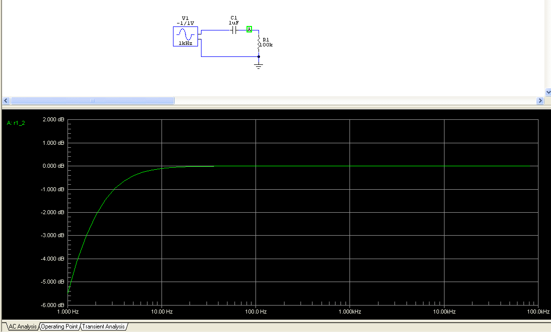

Looks like working perfectly OK Richard. Congratulations. In the graph is the high pass you can expect when coupling 1uF to 100K load.

If your speakers can go lower than 1.8Hz -3dB then its not enough.😀
Seriously, you may use more uF for even less infrasonic phase shift but for sheer amplitude you are way well covered for 100K input F5 as you see in the graph.

Have a proper look.
That graph of low frequency response is for 1uF & 100k.
The output of your circuit is already loaded with 100k.
To achieve that graphed response the following Power Amp or receiver needs to have Zin = infinity.
If the actual Zin = 100k, then the resultant load for the HP filter is 50k. This moves the graph one octave to the right.
The F5 has no DC blocking cap at it's input so the 1uF works alone.
The Zin ~ 101k.
This leaves the HP filter F-1dB ~3Hz.
This is OK for many.
If as stated earlier, a Zin=20k were used then F-1dB moves to ~17Hz.
If that Zin=20k power amp had a capacitor of 4u7F as a DC blocker then F-1dB moves to ~22Hz
