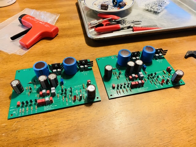

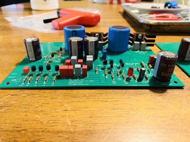

Wrapped up my Pearl 2 boards this evening. PSU is also ready - just waiting on chassis’ to arrive from Modushop. Pretty straightforward build so far. My goal was to get the RIAA boards in a 1U chassis, so that drove some of the component choices.
For the 6.81k resistor just before the RIAA portion, I used a couple Shinkoh resistors that measured in at 6.78k. Anybody see a potential problem in that 300R drop?

If not, get shorter brass standoffs.

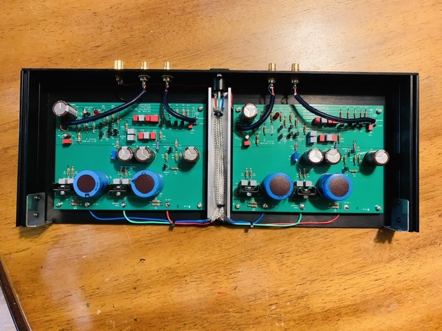

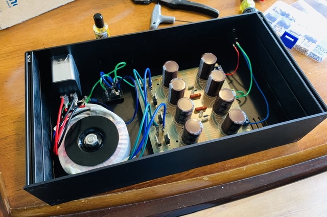

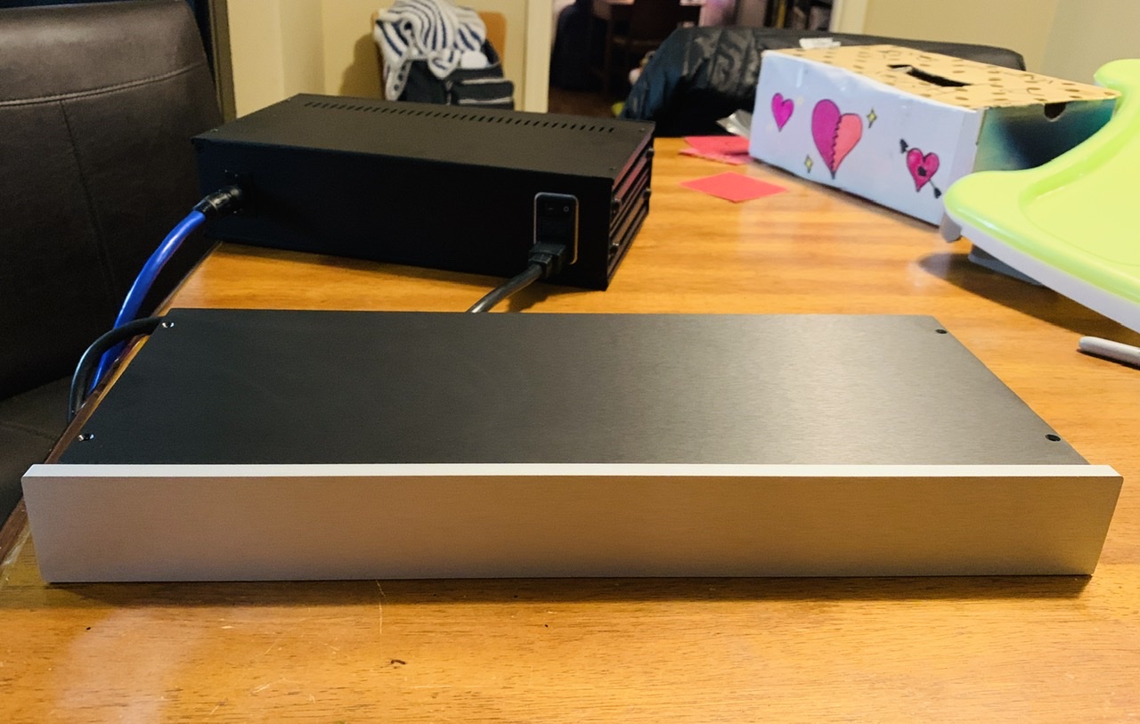

Finally wrapped up my Pearl 2 last weekend. What a phenomenal phonostage! Huge thanks to 6L6 for your help, and to Wayne for the superb design.
Pictured are shots of the PSU (in Galaxy case) and the RIAA (in 1U slimline case.) Had 2mm to spare!

@codyt - Very tidy wiring scheme, less chance of picking up noise. I wanted the board sizes so I could plan my own layout. I will be taking tips from yours for sure. Well done.
I mounted mine with one board rotated 90 degrees counter clockwise to keep the twisted pair input wires as short as possible hoping it would reduce the possibility of picking up noise. It is dead quiet. 🙂
