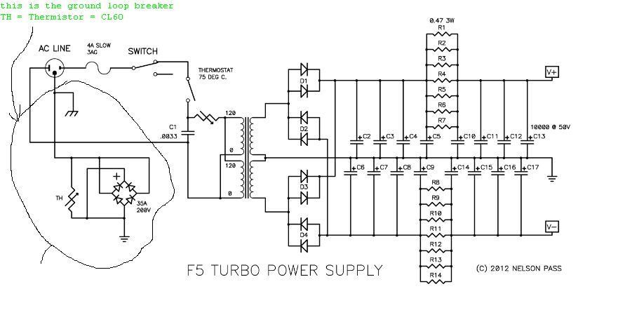

I use exactly the same bridge-rectifier together with a CL-60 thermistor for
building my ground-loop-breakers.
I use them in all of my DIY- Pass-poweramps.
Sometimes I did it with 2 single Diodes (direction against each other - paralleled together with a paralleled resistor around 10 Ohms) in my preamps, active crossovers,... with lower power consumption.
Works beautiful. Also in Germany with 230V/50Hz.
But hum or hiss can also have other reasons!
But often there are groundloops. My experience.
Greets
Dirk

the elliot sound products page never mrntions a thermistor.
your pictures dorsnt have the 10 ogm resistor and the 100 nano farad capacitor. so basically other than the diode bridge the link and the picture agree on exactly nothing.
Firstly as per Rod's description the chassis must be connected to the safety earth ie mains cable.
The earth lift circuit shown in the link uses a 35 Amp or 25 Amp diode bridge, 10 ohm 5 watt resistor and 0.1uF 250V cap.
Use one per channel.
There are other solitions that use a thermistor etc etc.

Hello Dadbeh,
I am sorry if you are angered? But there are different ways to build a
groundloop-breaker.
The Elliot - Sound - Products webpage shows one possibilty. And it is well proven.
This pic shows a possibilty:
I will look for others. But if you search here in the forum you can find many
solutions.
Greets
Dirk
