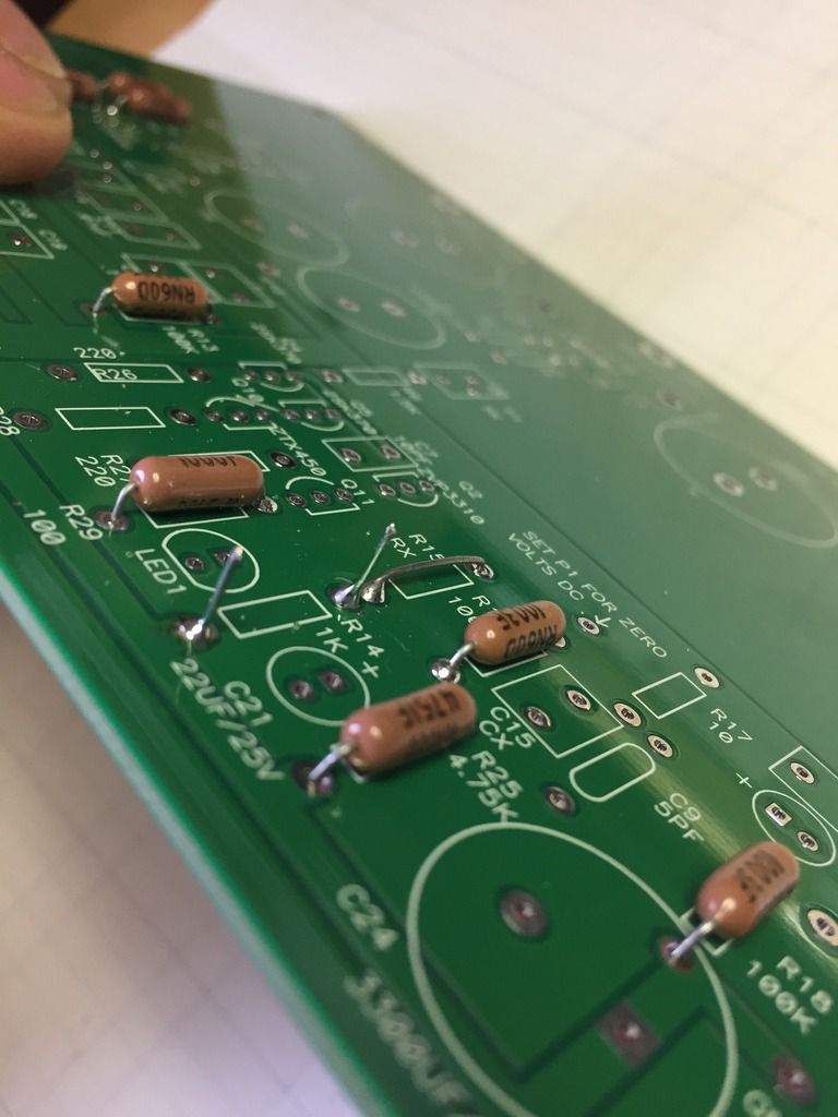

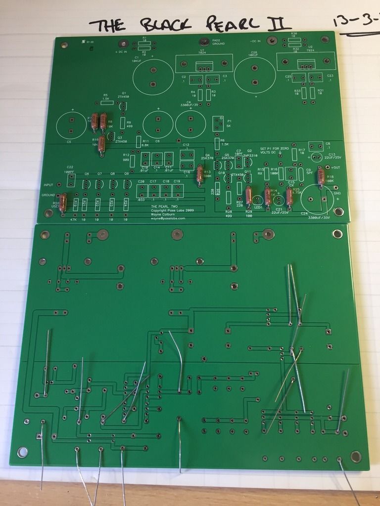

Rather than build one board at a time I'm populating and soldering (a few components at a time) in tandem. I find its easier this way while I have the bag of bits on the bench. Each resistor is checked and cross checked against the schematic prior to insertion in the correct location on the board.
Always the shortest components are inserted (stuffed) first. R20 is the cartridge loading resistor and in my case a Dynavector XX2 MKII which the manual suggests 30Ohms is required. In fact 1K is the way to go. Never believe what the manufacturer tells you...Except for NP who always imparts the truth...

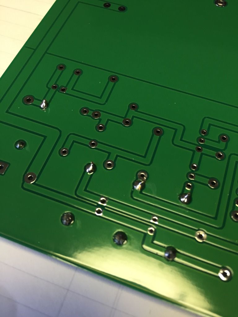

Soldered and excess legs trimmed off.

So, trying to think ahead I soldered some legs at R14 remembering this could be changed from 1K to 300 Ohms to lift the db.

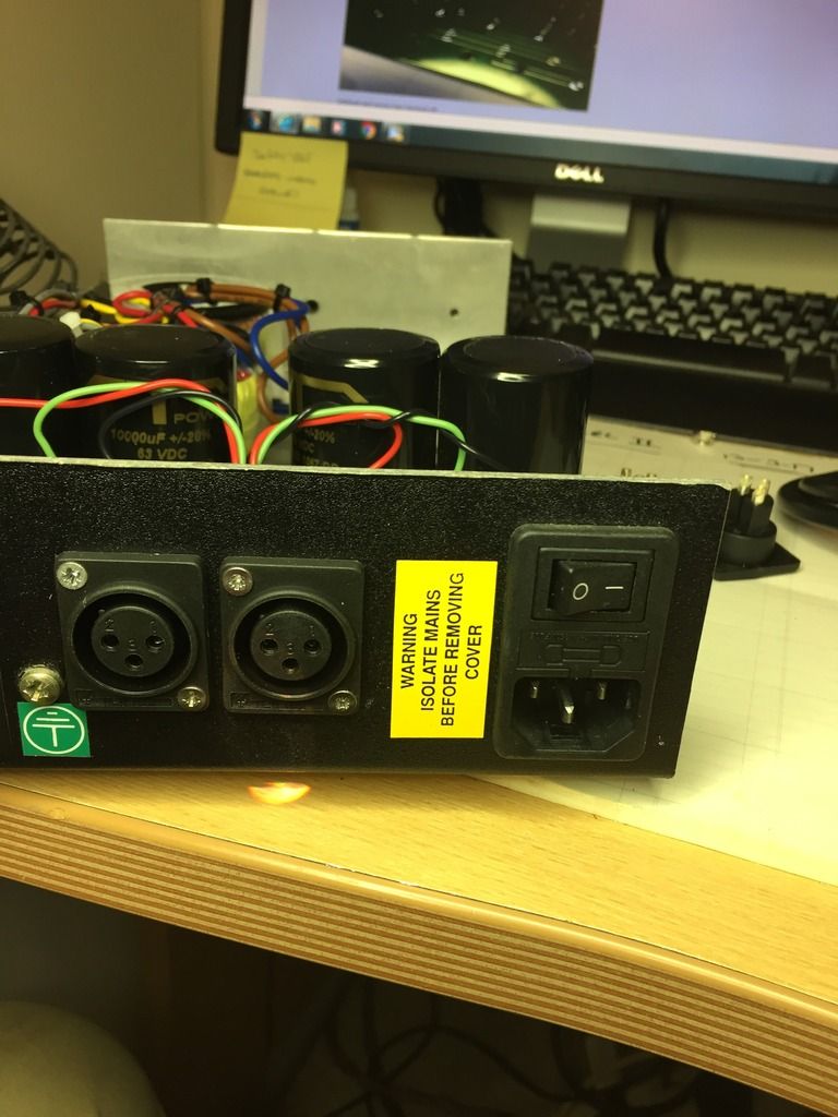

I was going to use a 5 way Phrew for the interconnect between the raw PSU case and the regs and Pearl II boards case. But Ive reverted to my original design of a 6 way interconnect. So I had a rummage through my bins and found some 3 pin XLRs plugs and sockets. I'm going to use these.
The cable is UK mains cable 13amp and is 1mtr long, should just about do the job.
Pin 1 = +vdc Pin 2 = -vdc Pin = 3 0v
