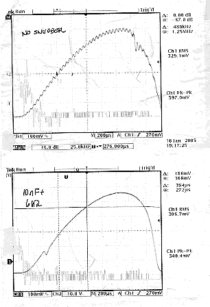

Snubber network is different for each type of transformers, there is no universal value. Mark Johnson showed how to select the right one with his jigs and oscilloscope. Very simple to build in dead bug form with copper surface as gnd.In fact, it is CRC snubber.
True! And with the proper tools it's easy. Without the proper tools, the 0.22uF is better than nothing.

If you are using a torroid, the leakage inductance is probably in the tens of microHenries. If you're using an EI transformer the leakage inductance will be in the milliHenries.

Just looked at my Pearl 2 power supply -- no snubber and no ringing -- using an Amveco trafo and bridge rectifier.
On the other hand, real world issues on an EI core trafo -- this traf was salvaged from an HP 465 amplifier:

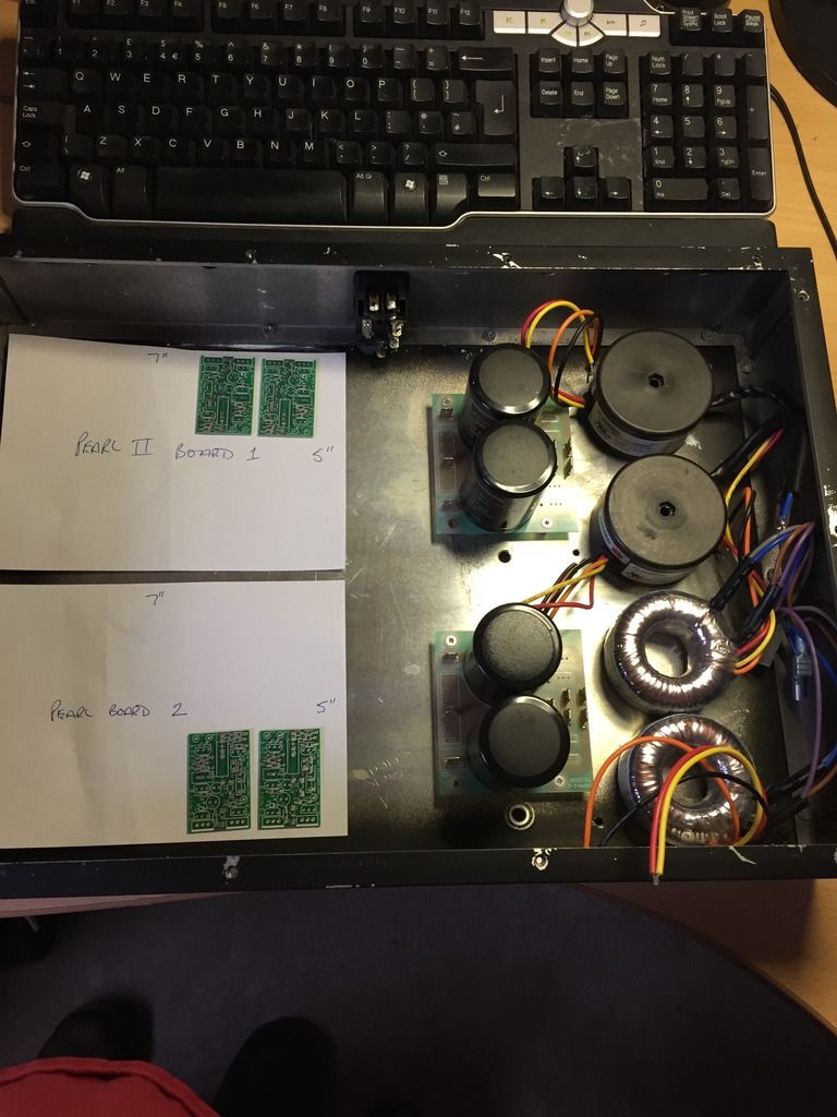

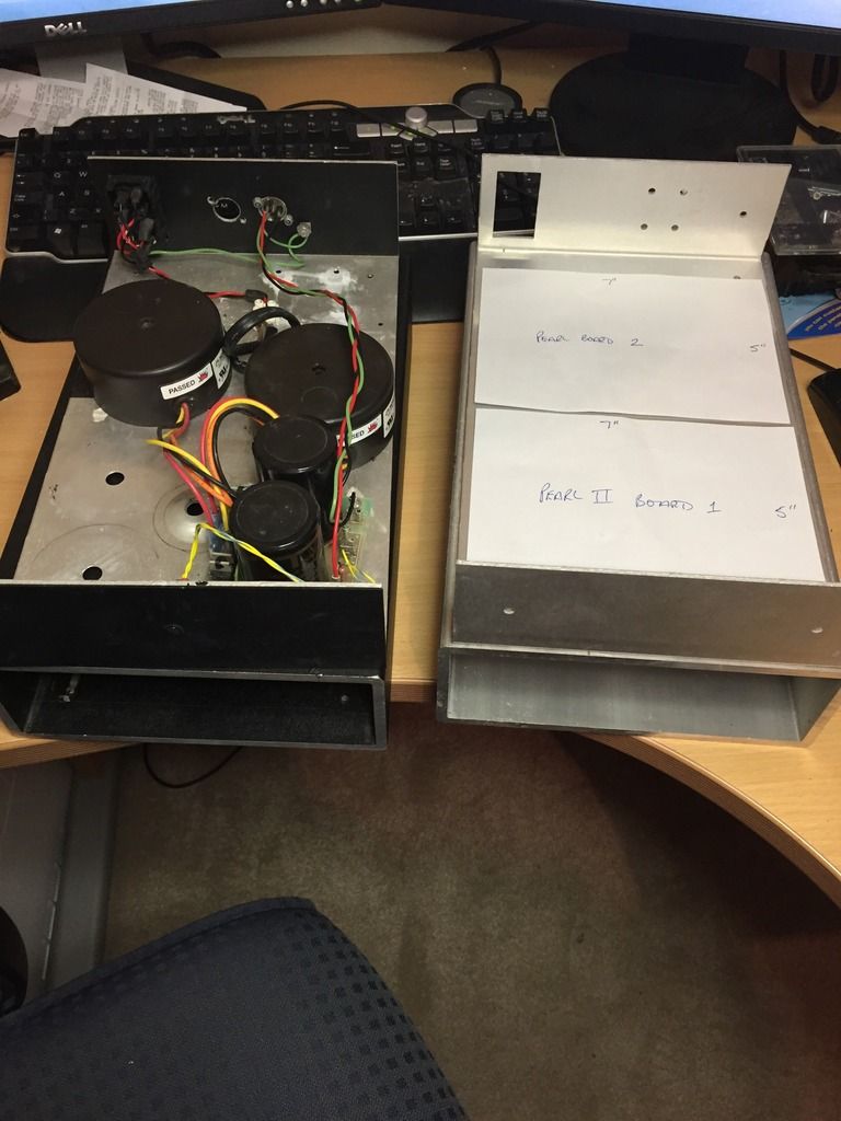

15va transformers (one per rail) to MBR20200 rectifiers feeding 10,000uf 63v T-Net (4 pole) caps raw to super teddy regs...I had all/most the bits knocking about and just sorting out the layout with the existing case I have.
Luckily it looks like it all fits OK..
IF you have an extra case I'd strongly suggest placing the raw PSU in it by itself. Both my Pearl and Pearl 2 were only really quiet when the transformers were 3 feet from the board.
That said, I'm really looking forward to seeing how the Teddyregs work out in your build! They are neat bits of kit and I've always wanted to try them.

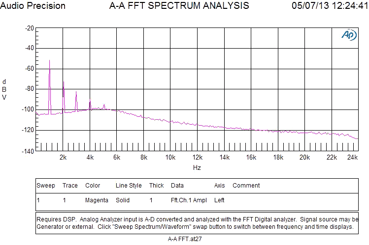

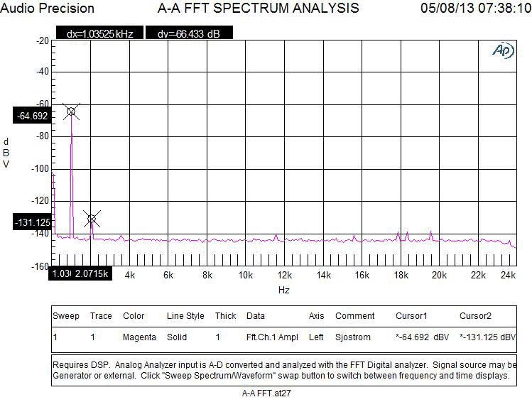

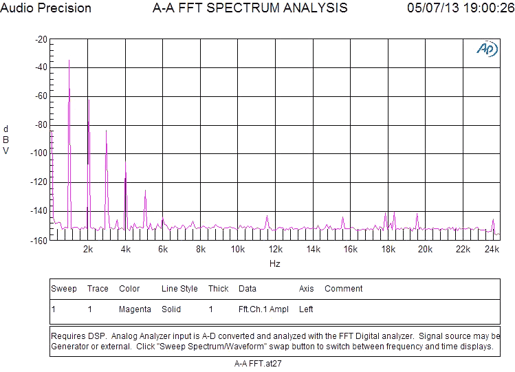

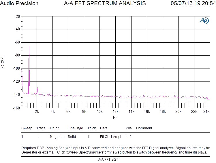

You would be better off with LM317/LM337 with the adjust pin bypassed, even better with the Sjostrom or Jung. The Super Teddy Regs are very quiet, but very slow and they will put back on the power supply rails harmonics of the fundamental. They were among the worst regulators tested for the Linear Audio article. Here are some comparisons of the THD on supply rails. In order, Super Teddy, LM317, Sjostrom, Jung:

So always willing to take advise...revised cases. One for the PSU one for the Pearl's..WTF they just fit..
Regs..Mmm, I use S-teddy regs in my existing phono amp with superb results over Jung/Weeks super regs or Russ white shunts but will now (first) load the board with 317 337 variants and give them a go. I can always just pop the teddies in to see at a later stage.
I understand your belief and one cant diss the tech but I use my ears over 'tech' to determine what 'sounds right/best' IMO the S-teddy reg is sonically superior in my system to others and I've had them / tried all over the years. Just to clarify I have the 4 transformer, 4 cap, 4 reg set up in my current phono front end which is the LT1115 - LT1010 buffer, as used in the Dynavector, mine is a DIY jobbie though.
