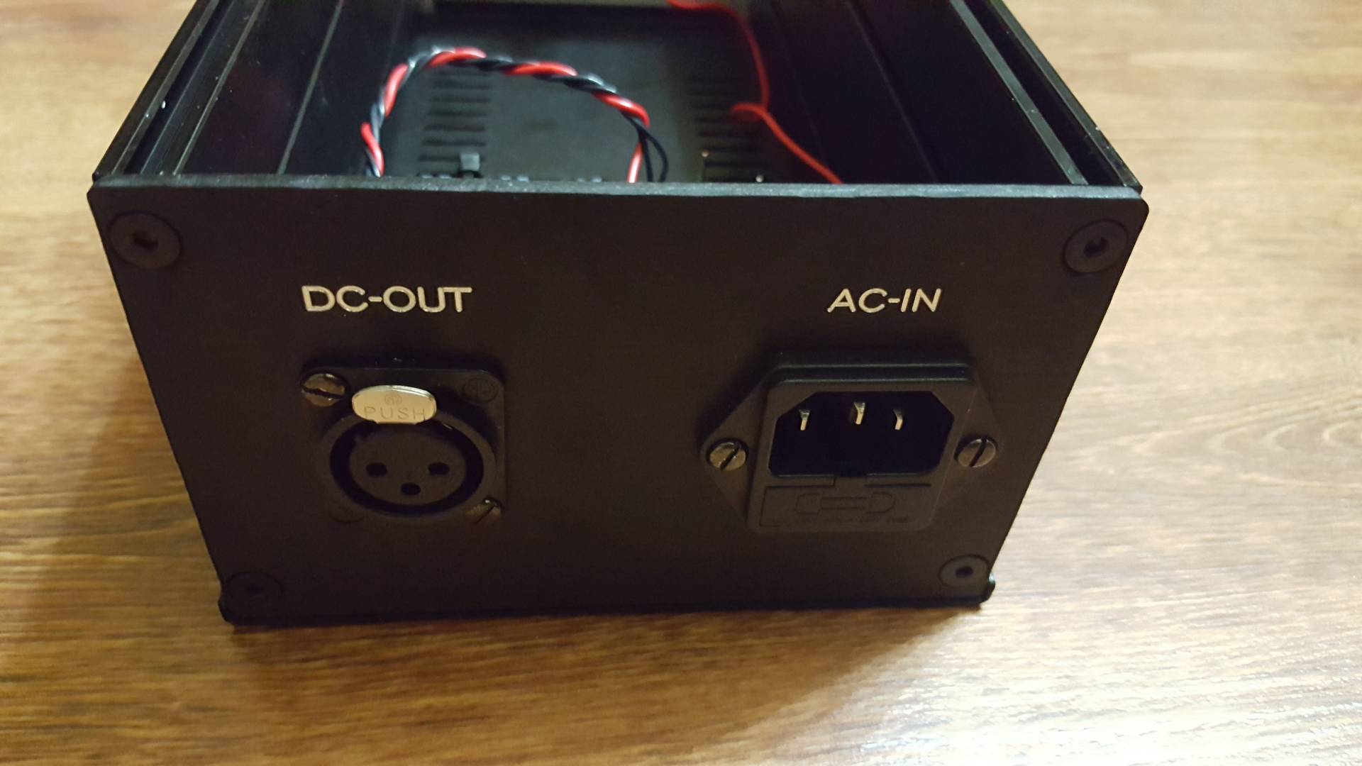

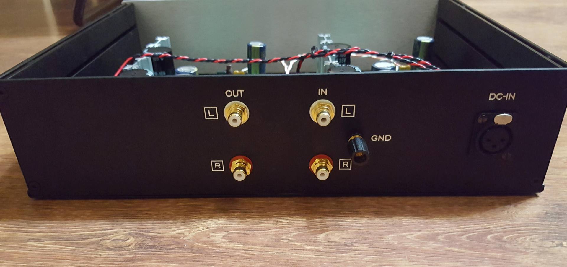

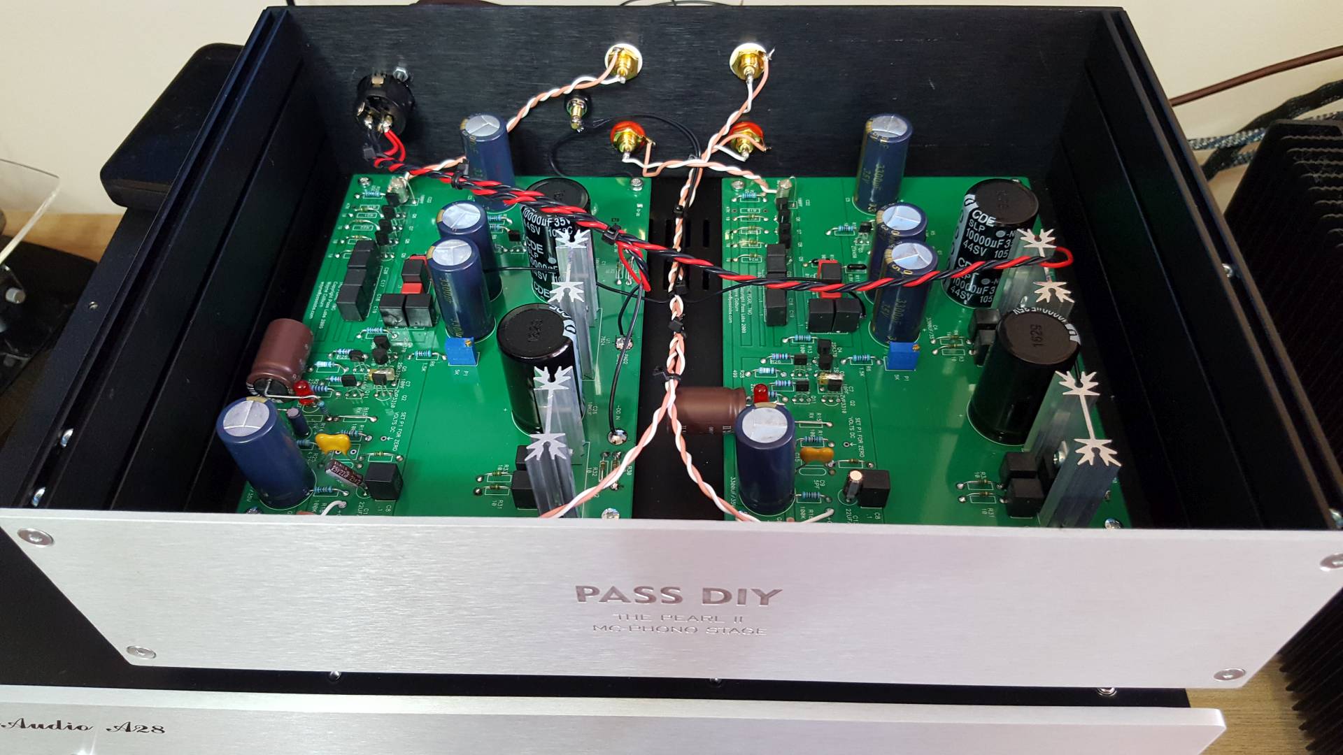

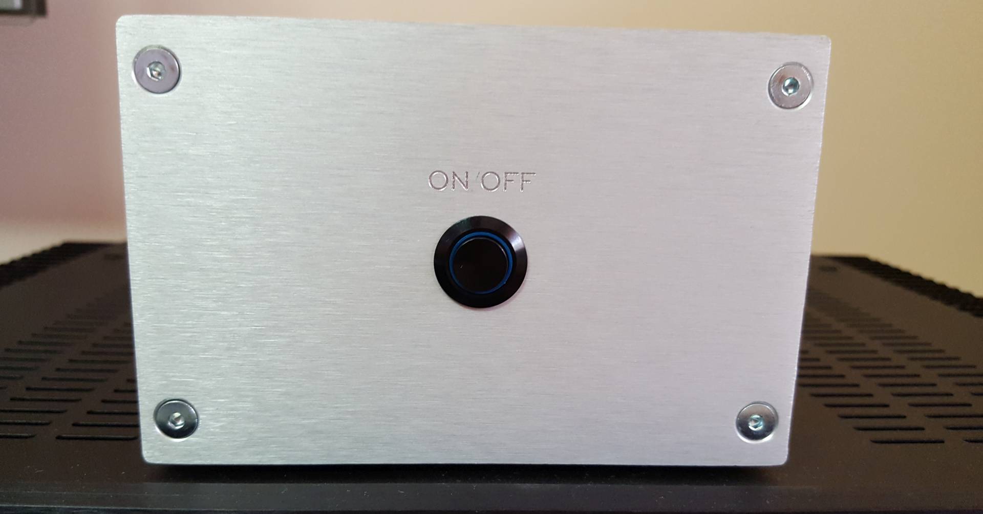

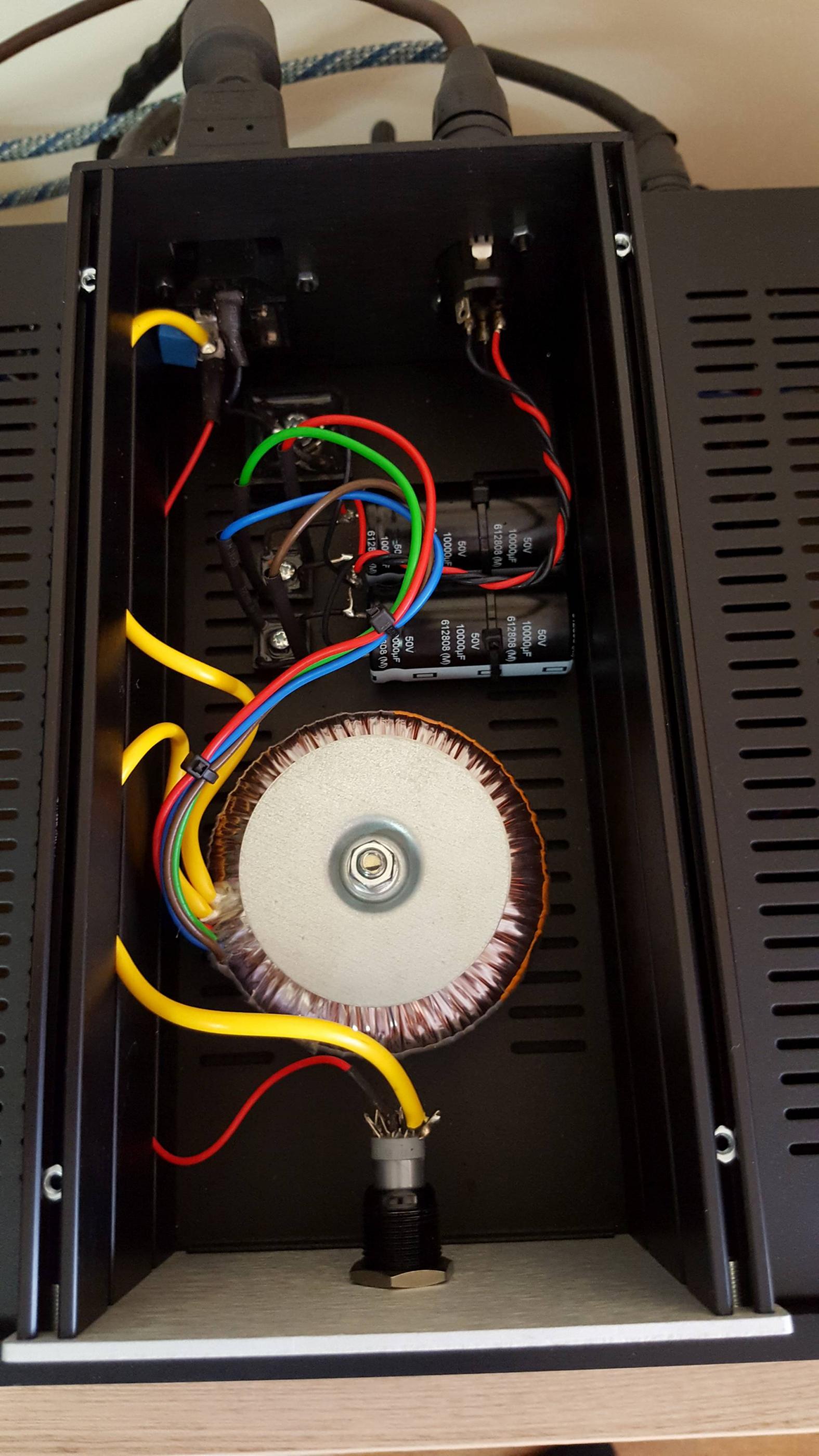

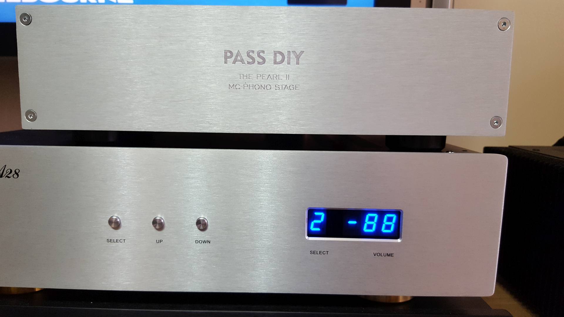

Pearl 2 finished!!
Pearl 2 successfully completed!
I would like to thank Jim for guiding me through the project. Wayne and Nelson for the share of your knowledge and amazingly superb phono design.
A combo of Pearl2 + Rega P5 + Denon DL-103r is ridiculously good. I feel like rediscovering my music all over again!
IMG_9061
IMG_9054
Pearl 2 phono
