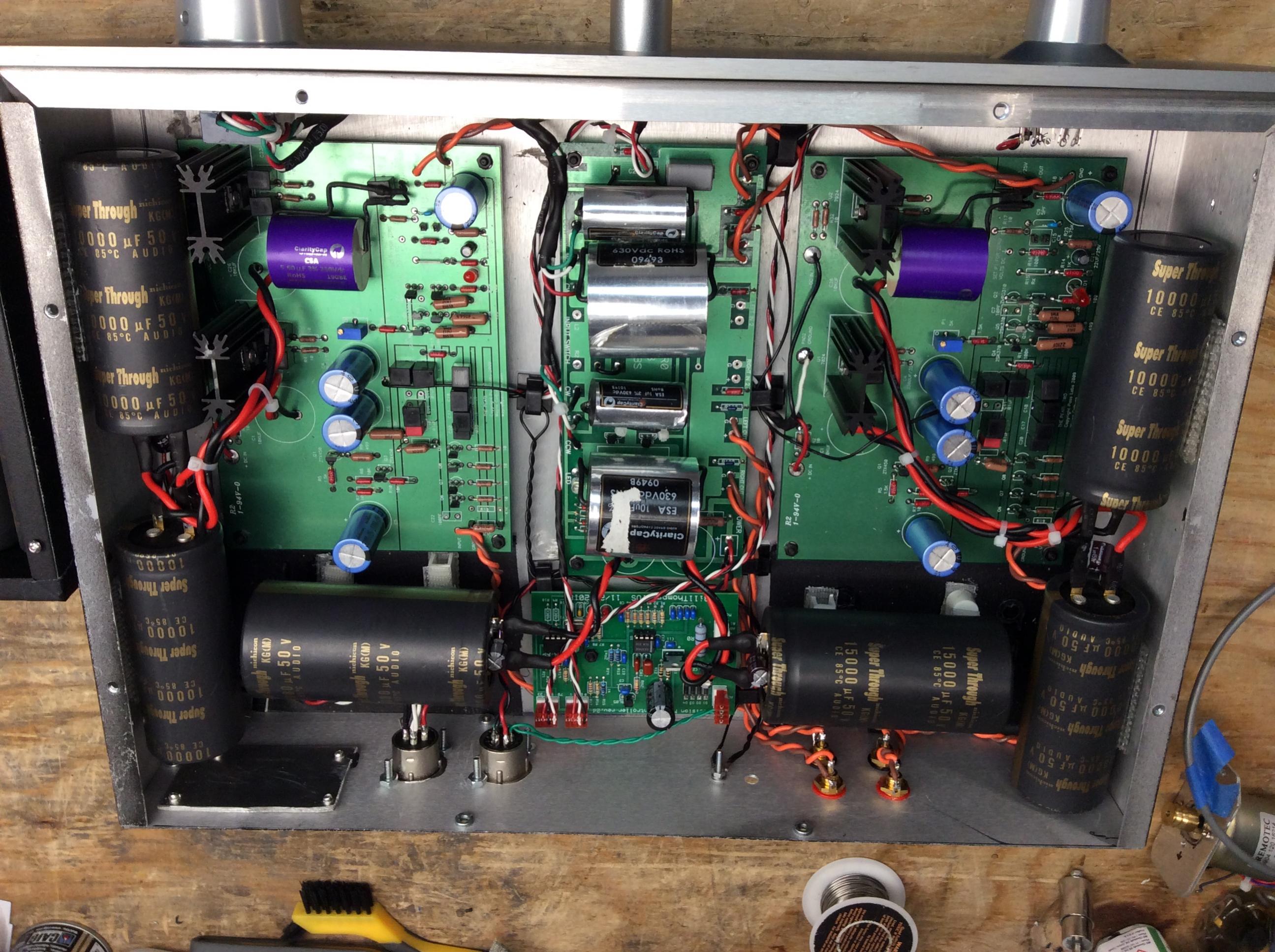

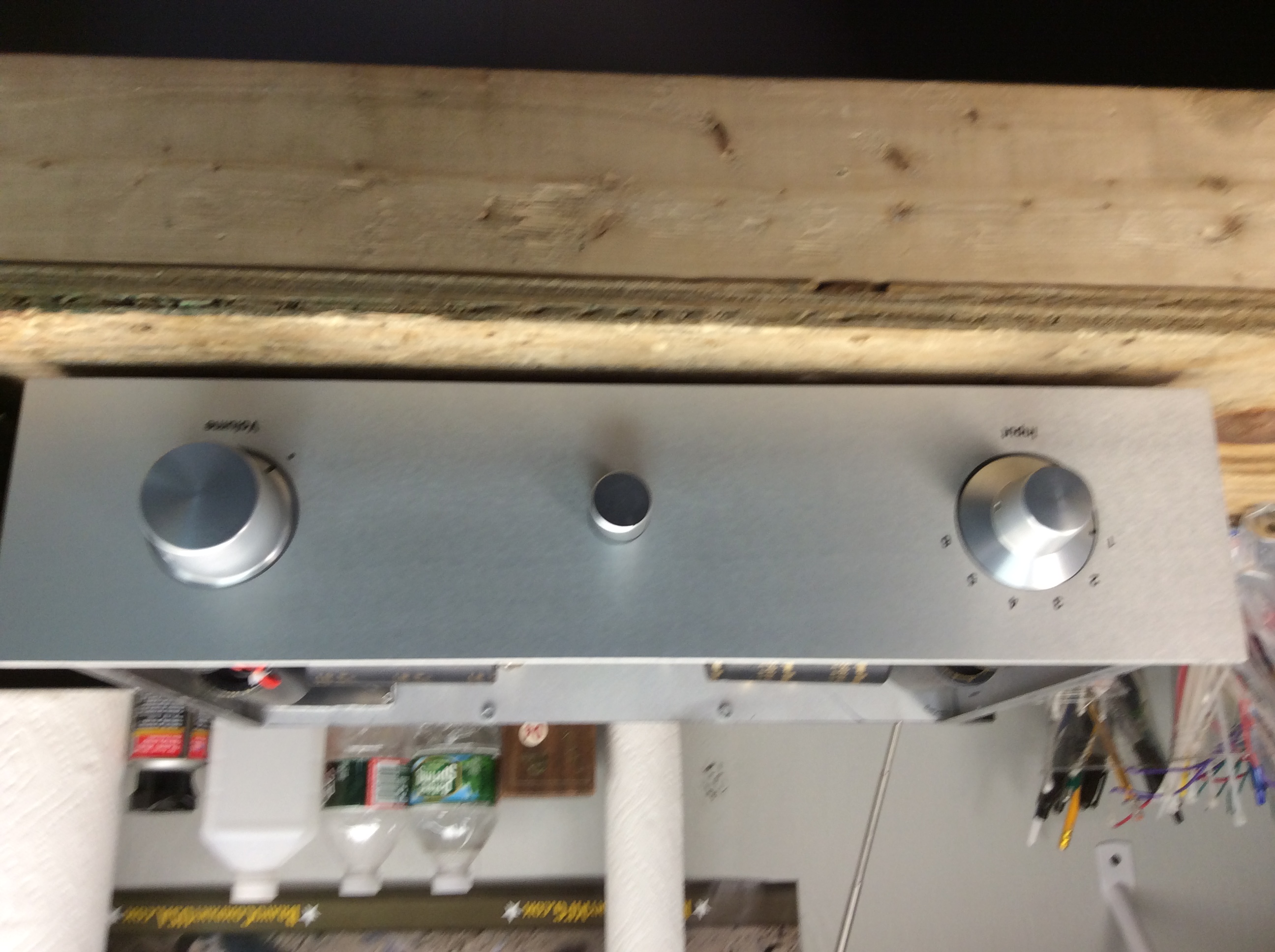

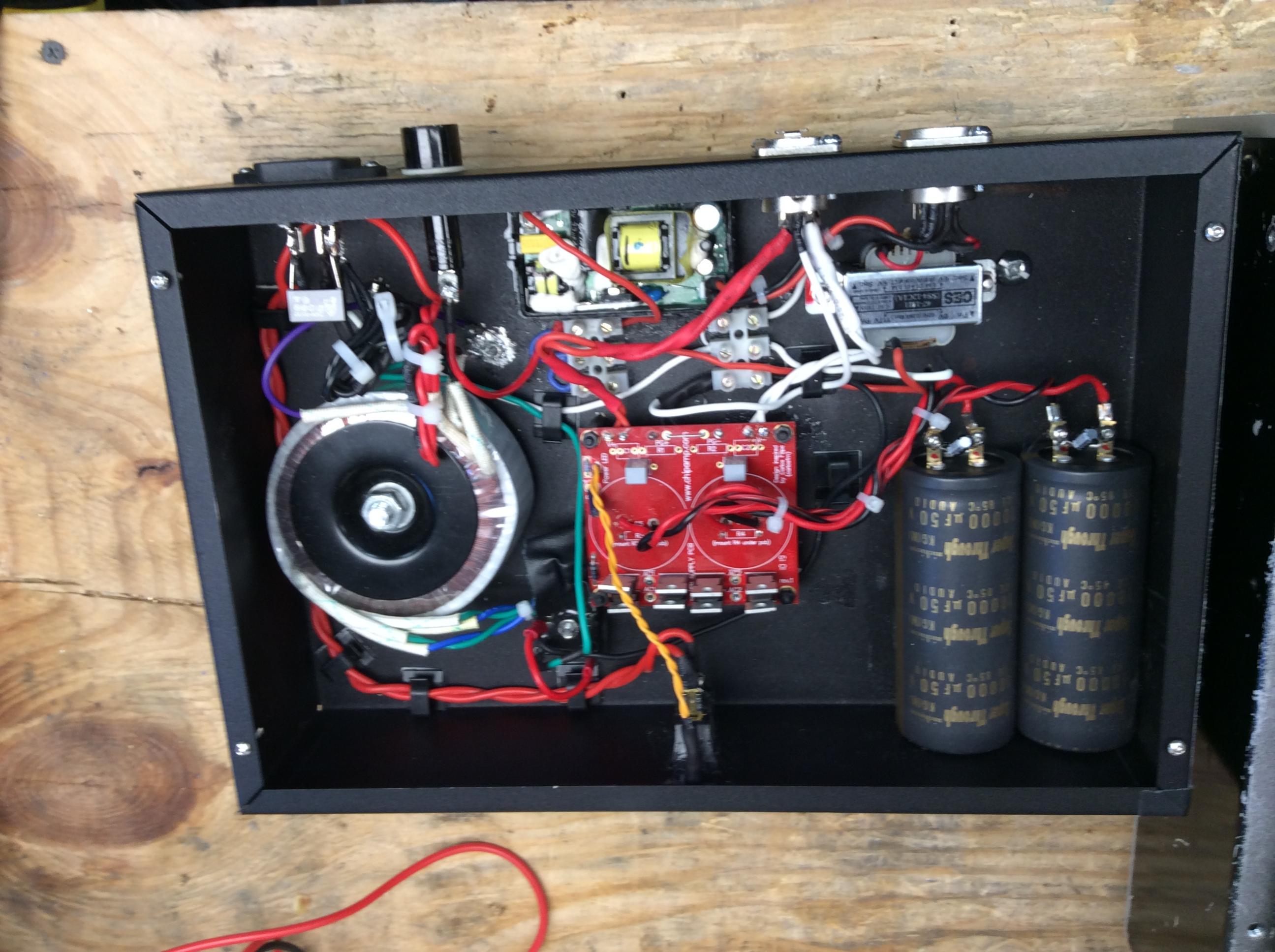

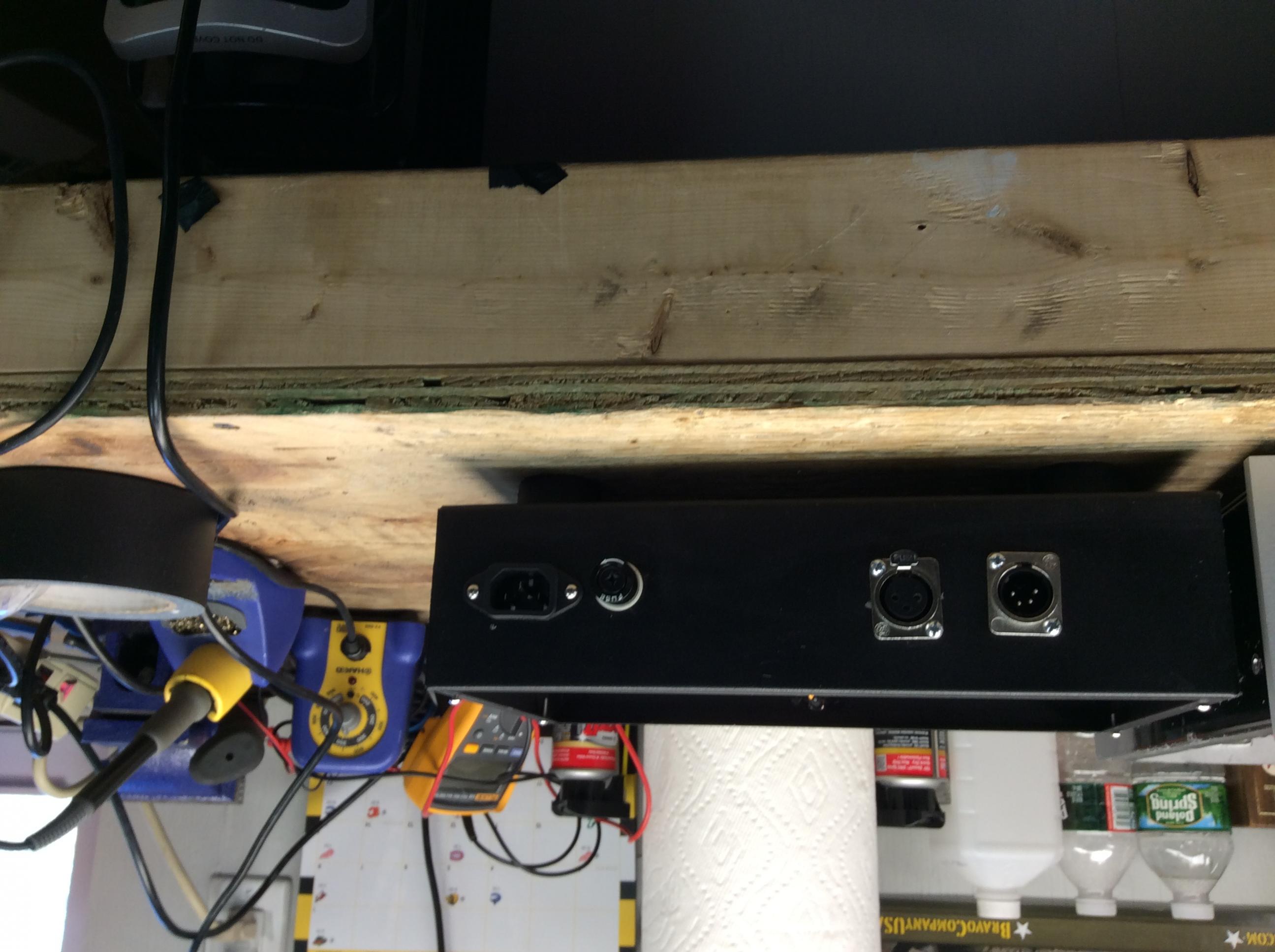

Well after having the boards for years now, I was finally able to get everything together. I ended up with two housings, one for power and the other for the boards.
In the power supply box I have the power supply for the Pearl 2 boards, a power supply for the B1 and one for the TT motor drive board.
In the board chassis I have the Pearl 2 boards, the B1 and the TT Drive Controller board.
Plus some very big a$$ caps.
I have already set the test point to zero volts.
Now I will begin on the reassemble of the actual TT.
I just wish I would have done this years ago when I first purchased the Pearl boards but that is life.
Sorry the pics are upside down.
