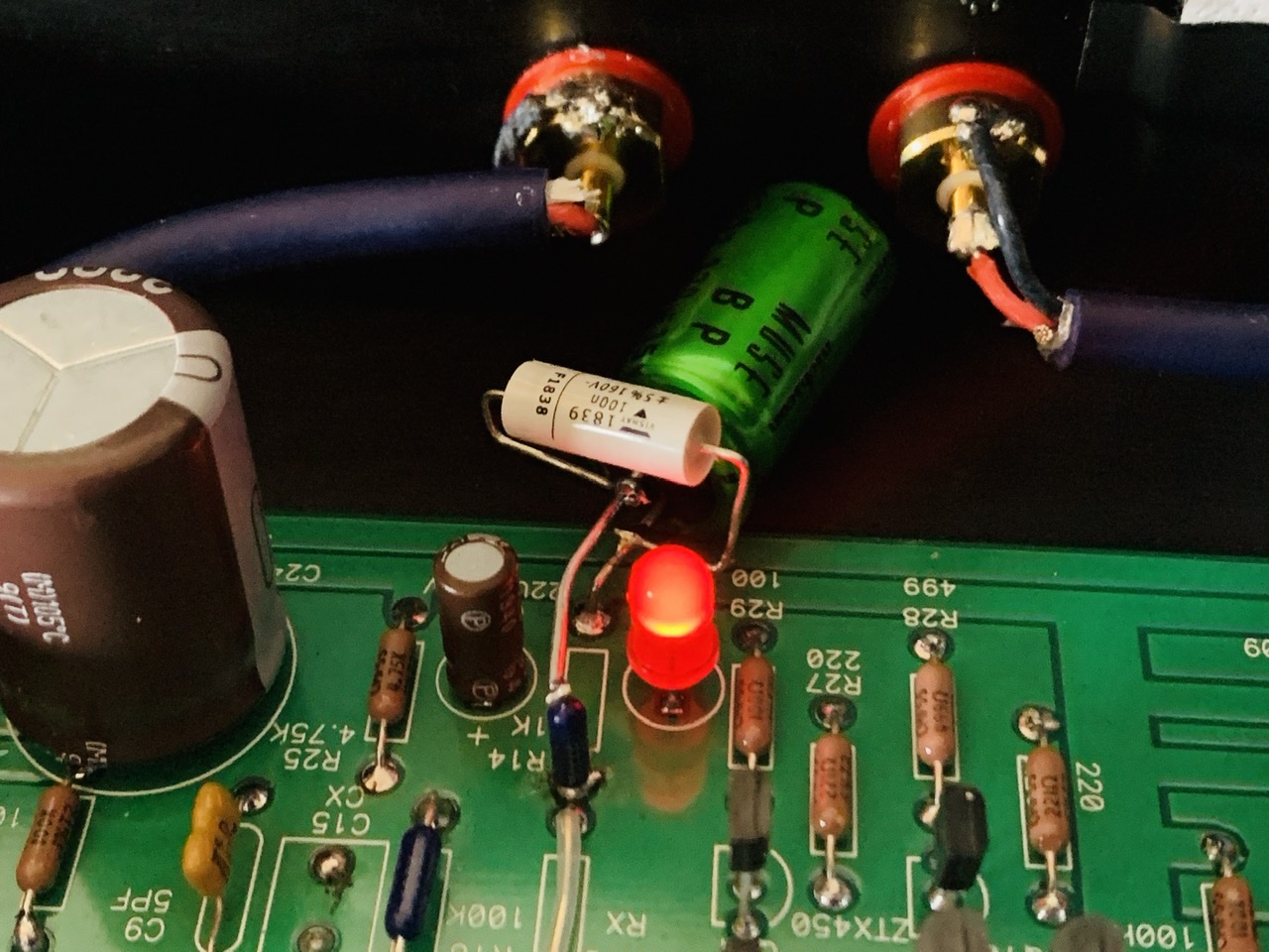

I put a silmic cap between R14 and ground and verified 0VDC at the output. Then put a jumper on C13 and removed C8.
Same. I also added a .1mf bypass to the 220mf electrolytic, but the benefit of that is questionable. I’ll upload a picture in a bit.

So add a 220 cap between r14 and ground?
It is not clear on your images, but I could just lift the board edge side leg of R14 and add the cap there would be my simplest option.

Yep, that all I did. It’s pretty straightforward

I put in a 47uF, I don't think the value is critical.

Here’s a pic

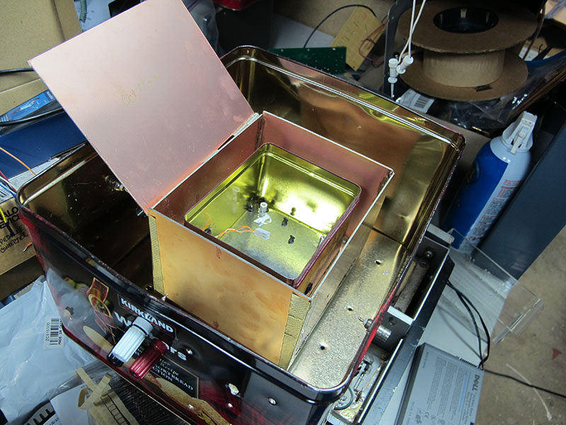

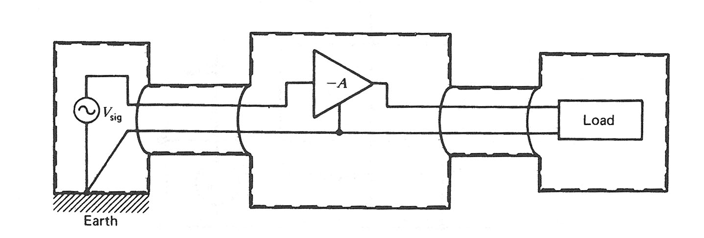

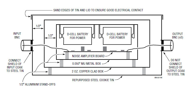

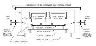

The first image is from Morrison's "Ground and Shielding Techniques in Instrumentation", the second from Linear Tech (ADI) AN-159 "Measuring 2nV/RtHz Noise", third the shielded box I use for noise measurements -- I can measure down to ~500pV/RtHz

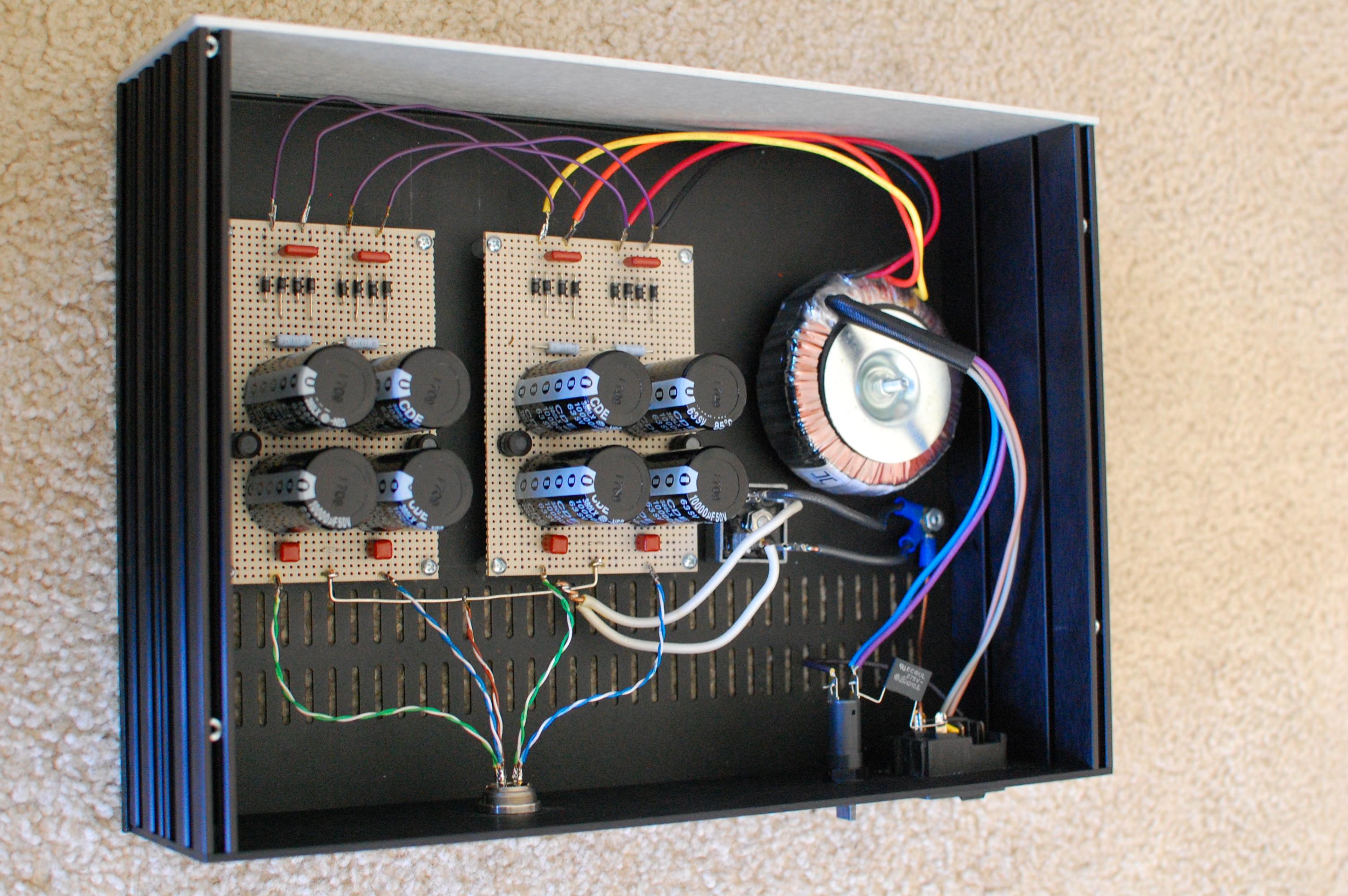

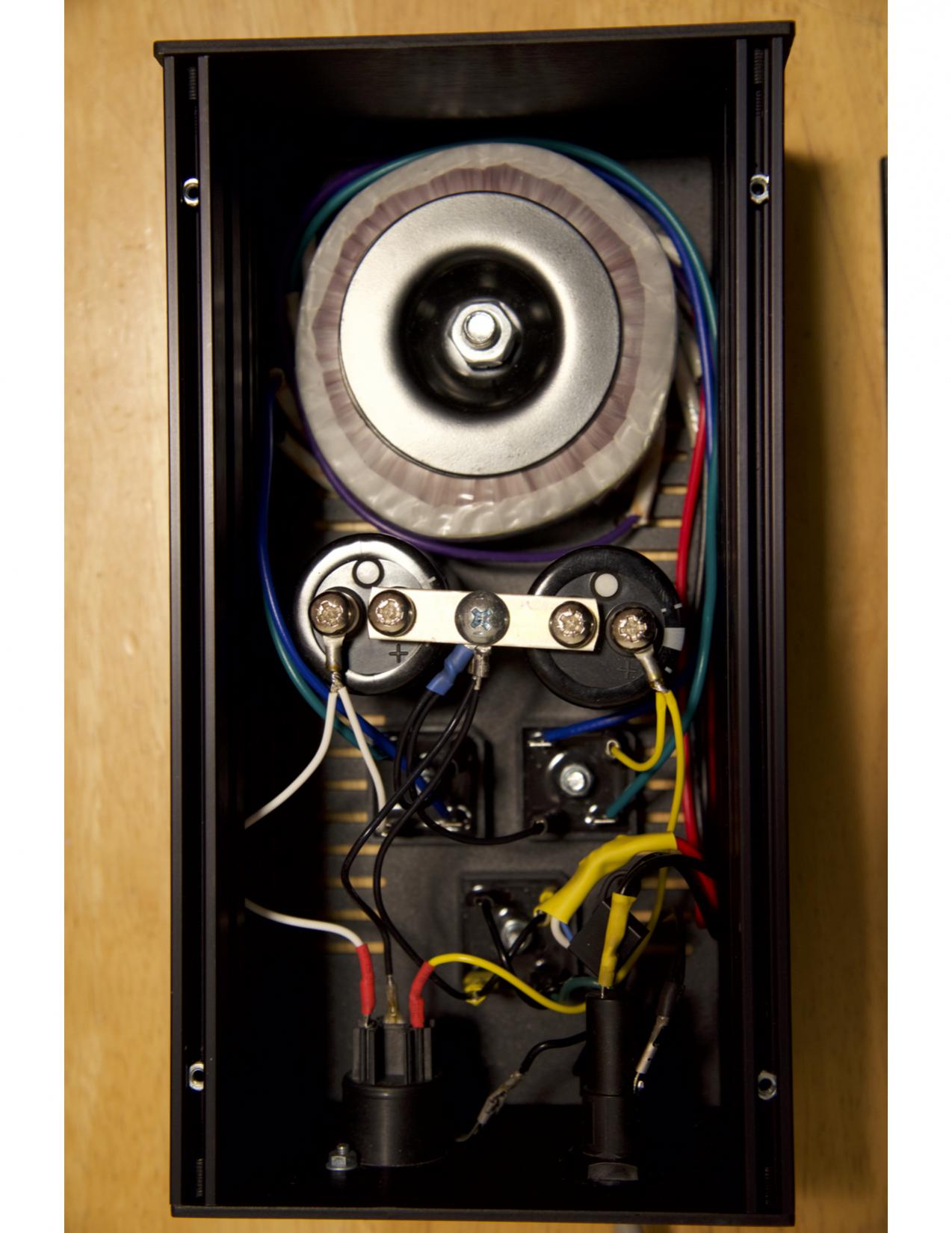

With a little help from my hot glue gun, I found the power supply published by Wayne to be really easy to build P2P.
I’m going to tackle this build next. Does anyone know where to get the power supply board since Chipamp’s website is no longer available?

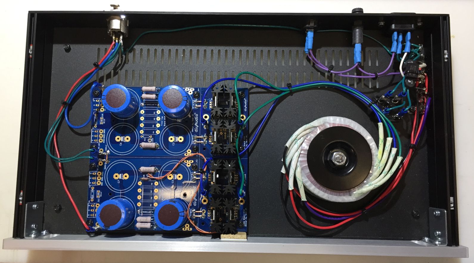

You can also use the DIYaudio store PSU board to build Wayne's supply. I spent the extra $1 each to add heat sinks to the fast diodes but they probably aren't necessary. Safety ground isolation components are on a terminal strip next to the IEC inlet.
