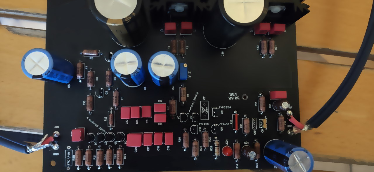

Can you post some photos of your build? Are the RIAA resistors and capacitors in the proper places and of proper values?

the build is customized, I hope I have not done anything wrong, the scheme is respected.
JFET taken from Electro andijk, GR and BL grade.
Tested both without substantial differences, only adequate R21-R24 to adjust tensions.
R11 = 6K81
R12 = 909R
C10 = 0.01uF
C11 = 0.01uF
C12 = 0.1uF
C14 = 0.1uF
C16 = 0.1uF
C17 = 0.1uF
C18 = 0.1uF
C19 = 0.1uF
C20 = 0.033uF
hi,
I solved by removing C22, the sound opened, now I adjust some capacitors in the RIAA circuit and it seems perfect.

Well I got everything hooked up to the home stereo so after the B1 I am hooked up to QSC amp. At this time I do not have nearly the volume level I need.
When I was using the Cambridge Audio 640 I ran it to the B1 and to the same amp I am using now. Since that amp also is being used for everything else I would have to adjust the gain knob to one tick below full open. Now even if I go full open the volume is just not there.
Looks like I will be dropping R14 to a lower value. I am either going to drop it 100 ohm’s since I know I have those or I may check to see if I have a few pots I could use to adjust the value.

Well according to the Pearl doc I can increase the gain by changing out a resistor (per board):
“The overall gain of the circuit as shown is 55 dB @ 1K Hz. Decreasing R14 from 1K to 300 Ohms gives 10 dB more gain when desired for lower output cartridges. R15 which normally would be shorted to 0 ohms can be replaced by a resistor to provide more gain as an alternative to reducing the value of R14. C15 has been placed on the board to allow for additional adjustment of equalization. In both cases these values are up to you.”

Is R14 at 300 ohms now?

Then why don't you put it at 300 ohms and see if it's enough?

My Pearl 2 with a low-output moving coil and R14 at 300 ohms overloads my headphone preamp. It's a huge amount of gain. I think you'll be happy with that setting in your rig. If it's still producing less gain than the Cambridge at 300 ohms, there may be a different issue.
