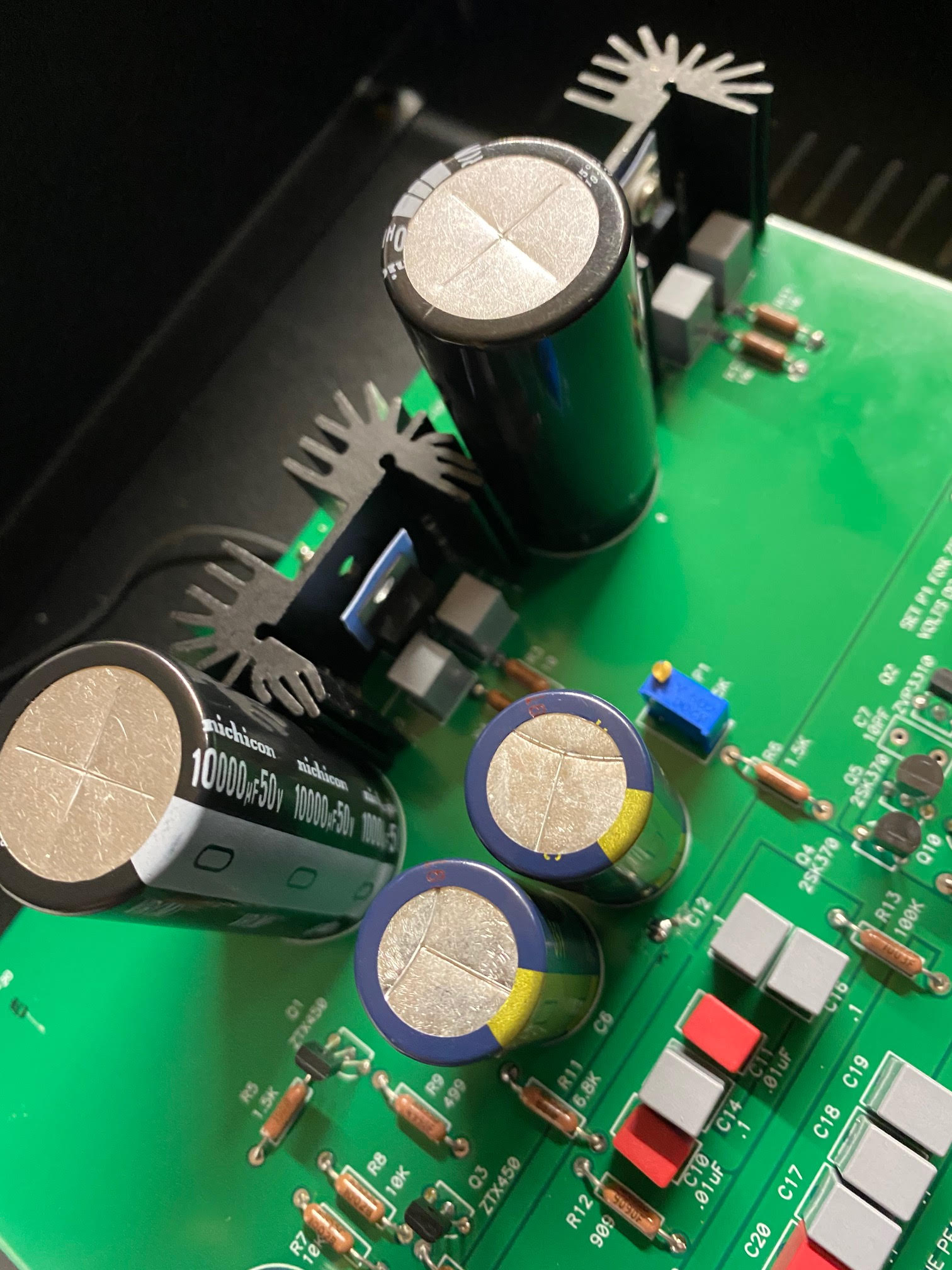

Its the positive rail drop resistor that is over-heating. I following 6l6's pictures and schematic on the first post when making it.
I'm starring at your third picture from post 1845 and comparing it to the schematic. Shouldn't the wires from the positive side of each rectifier go to the positive post of the cap.

That only one of the filter resistors is hot makes me think it's a short on the V+ side or something similar.
Did you measure the on-pearl regulators on both boards both sides?

Yes, I tested the regulators before stuffing the rest of the boards. I listed my results on POST #1847. I can attempt to test them again by lifting the resistor leds for R4, R3, R33, and R31.
On the regulators, both should for sure be isolated from the heatsinks, correct? I reviewed the data sheet for the 7824 & it says "heatsink surface connected to Pin 2" which is ground. Should the rubber pad I used between the heatsink and regulator be removed?

Just to be clear...you tested the boards individually and the dropping resistor overheated using either one?
Also, the positive rail is conducting more than the negative, right? I don’t see the burn marks on the negative dropping resistor.
First thing I just tried this morning was removing the 7824 on one board from the heatsink and "voila!" No DBT light coming on and no hot resistor. The regulator resistors (3,4, 33, and 31) are reading +-24V.
Now I just need to figure out if the heatsink is shorting out or if the 7824's need to be connected directly to the heatsink without an insulator. The data sheet for my device (#863-MC7824CTG) says the ground pin 2 needs to be connected to the heatsink.

Yep... I just attached the 7824 directly to the heatsink without insulator and it powered up perfectly and I was able to set DC to 0mv on the one board hooked up.

if heatsink is (in any way, deliberately or not) in electrical contact with circuit, then you must isolate regulator electrically from heatsink
simple as that
datasheet is saying nothing else than that pin2 and back tab are electrically in connection, not that they need to be connected
