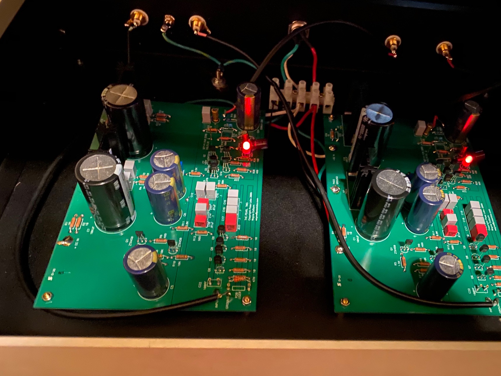

I have a Dynavector 10x5 and Denon DL-103. I started by testing the Dyna and it had a bit too much gain right away. I have a stepped attenuator on a BA3FE and it was a decent volume at the lowest setting.
The 103 I had to crank to halfway for a decent volume but it introduced more noise at that level.
It’s silent on both carts at low volume but gets noisy for both halfway up.
Sounds great so far though.
I’m experimenting with different resistors but finding I enjoy the 47k already loaded.
I do find that I am experimenting a bit too much noise at halfway on both cartridges. It’s not hum, but more of a fluttering/ground loop noise.
I’m running a Dynavector 10x5 —> Pearl 2 -> BA3FE -> F4 -> Cornwall III.
I figure it’s just a lot of gain.. I do have 1K resistors on the Ba3FE and the Dyna is a HOMC so puts out more.. sounds amazing but lowering the noise would be nice. Although, the Cornwall IIIs are very efficient at 101 db.
That Denon is going to be happier around 100 ohms and the Dyna around 1000.

New mouser parts came in today for me to change out the wide heatsinks I had so they were not touching the large filter caps. I changed them out and while under the hood I changed the twisted rca wires I had to some shielded rca wires and the phono is now dead silent! Before I changed the wires, I was also having noise issues when switching out the loading resistors. I now don't get the noise and the posts I have make a good connection with the resistors when swapping them out.. Next is to create a switch for changing the loading resistor... but for now I will enjoy the phono as is...
This is truly a solid performer and it will be replacing my tubes4hifi PH-16 tube phono....
Thanks again for everyone's help on this build.

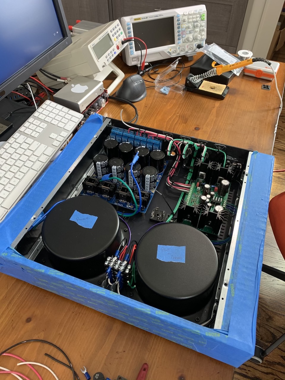

I've almost finished building an external power supply which I'm planning to use to power an M2X (or F5) power amp, Korg B1 pre and Pearl II phono stage (I think I've got most parts gathered in boxes lying around somewhere). My question is; Is there any advantage/disadvantage to adding additional capacitance to the supply lines locally inside the enclosures for the Pearl II and Korg B1? Each will be housed in separate enclosures.
This is the progress I've made so far...
