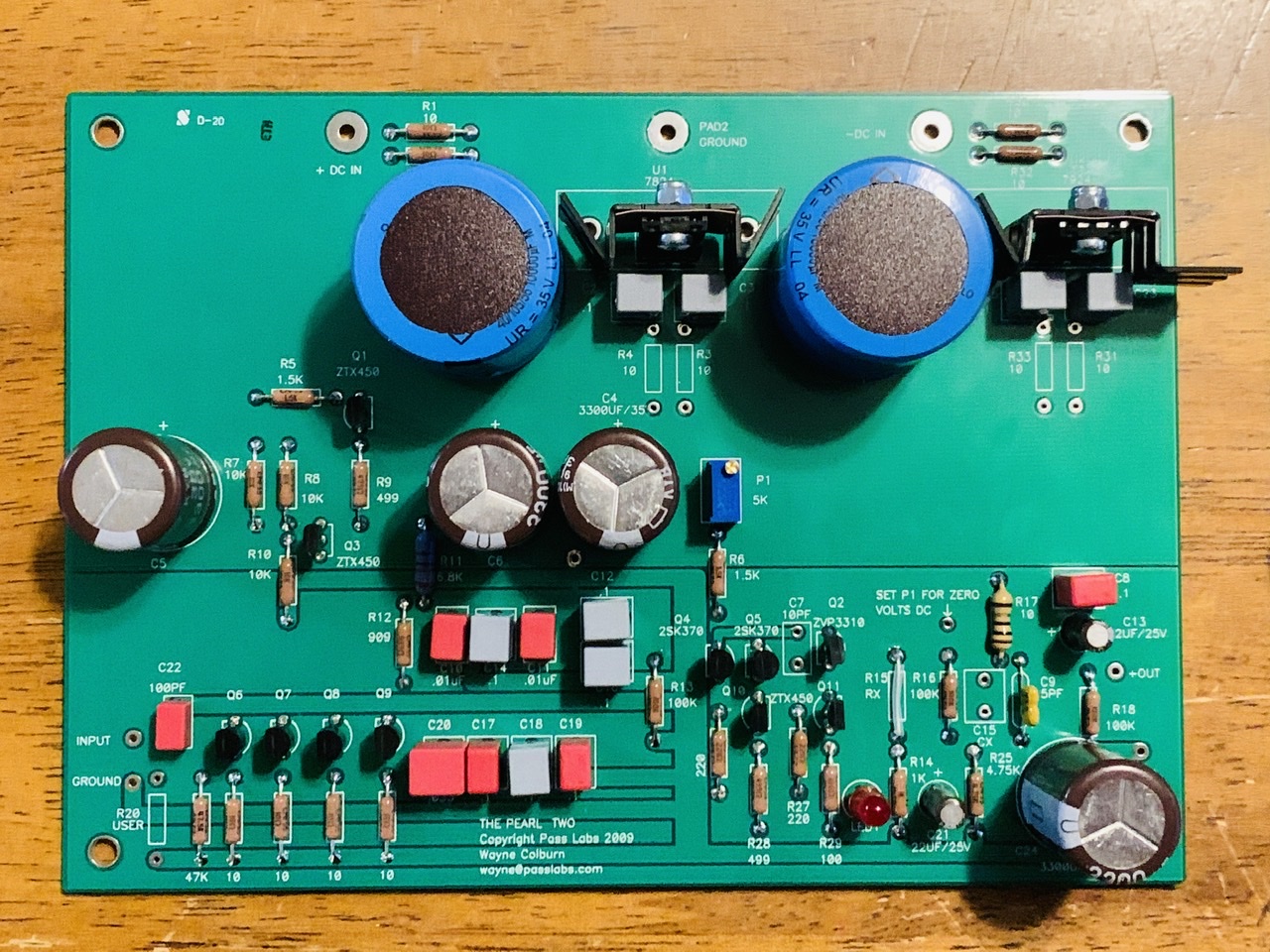

Finally, I’d like a low-profile look and would like to wire in the 10000uF caps on their sides. Any problem there? It looks like the PCB has room to do that. If so, any particular gauge wire to make the connection to the PCB?
Thanks as always. Looking forward to getting started.
Jim
You can get the Pearl 2 into a 1U chassis without putting a caps on side. Those 10k caps are the Key. I ended up finding an ideal solution with a slightly larger footprint (30mm, vs 25mm on the board) and using a heatsink on the regs that I could bend to accommodate.
On thing to keep an eye on - my boards had a slight warp upward that ate into the clearance I allowed for components.

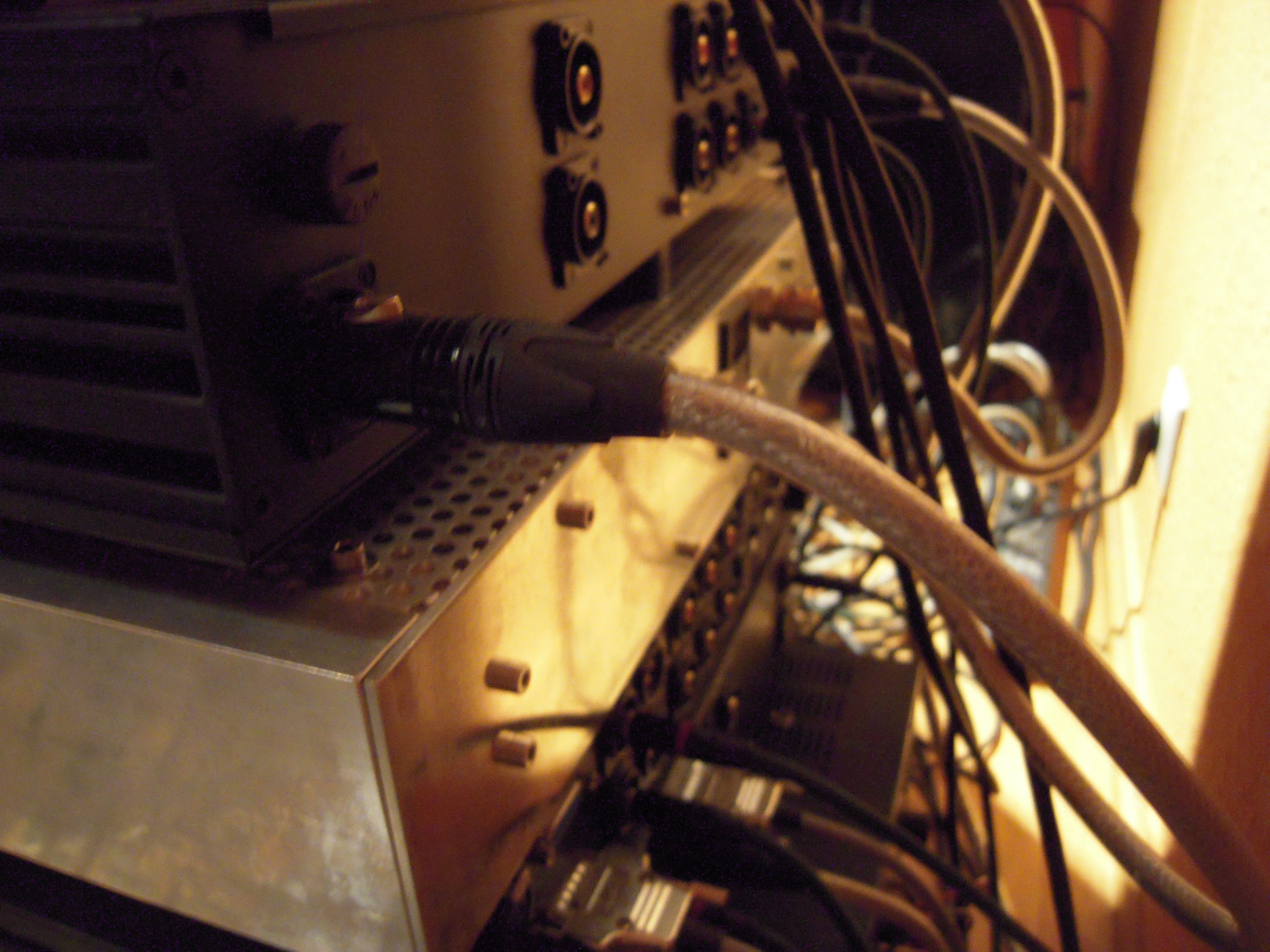

I connect my PSUs to Preamps / Phono - pre most often with the Neutrik- XLR-4-pole.
Works nice. Neutrik specs the connectors only for Audio- / AC-signals. Not for
DC. The pic shows my BA-3 preamp (seperated cases for PSU / preamp / dual-mono). I also did this with my Pearl I and Pearl II.
Greets
Dirk

Hello jamayfie,
Greets
Dirk
