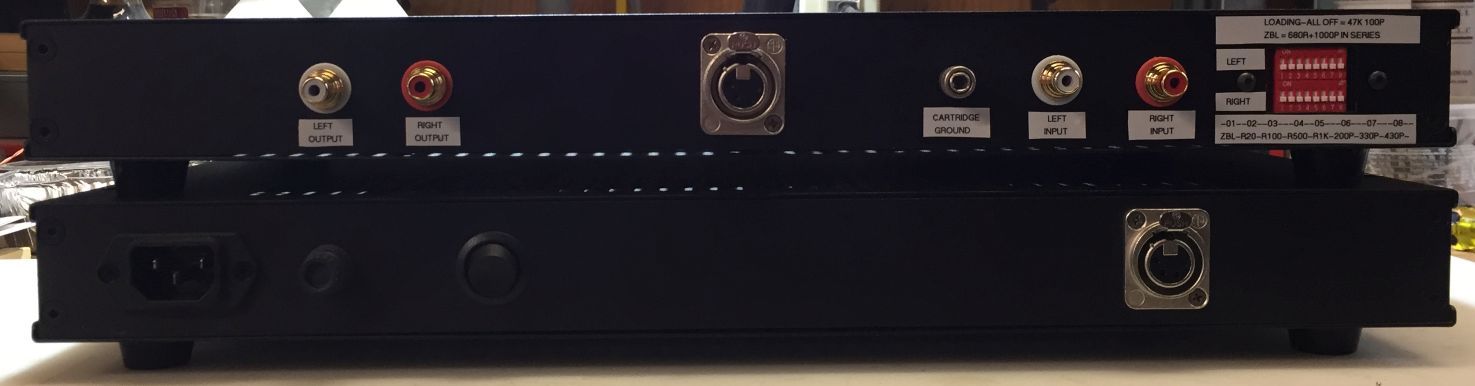

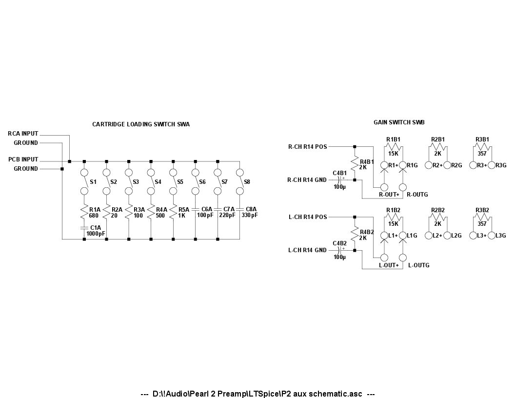

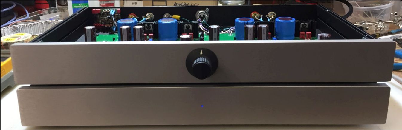

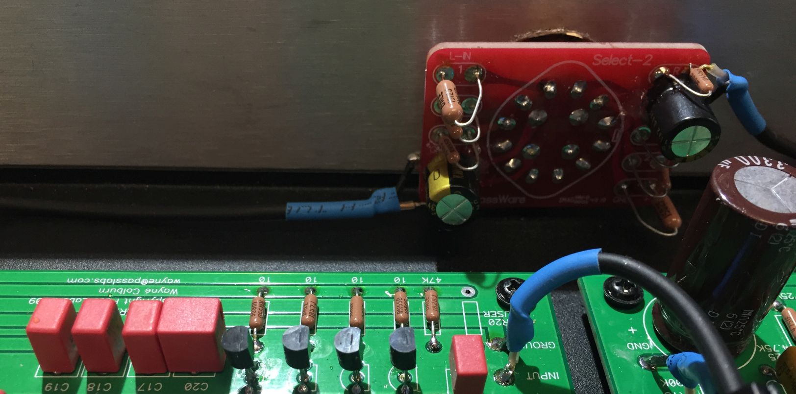

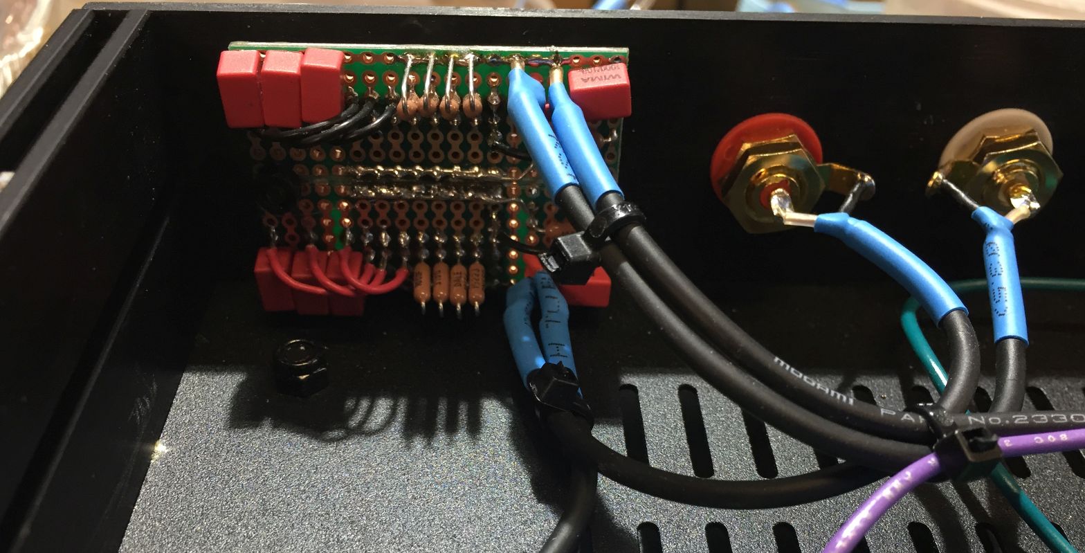

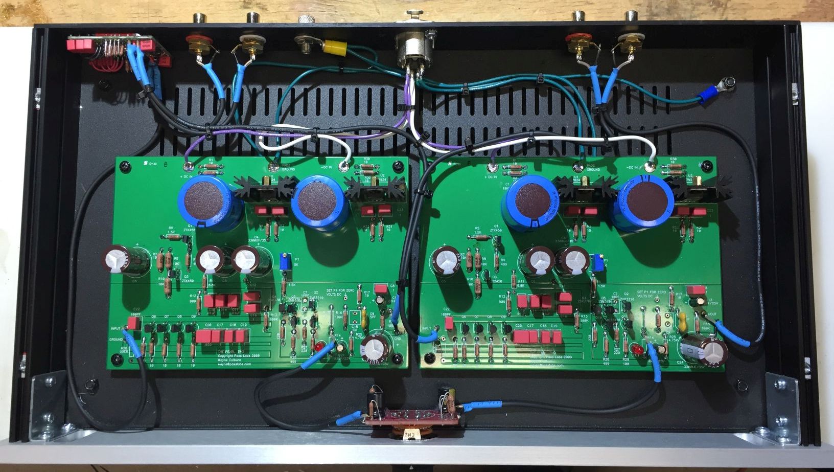

Pearl 2 build with adjustable input loading and gain
My Pearl 2 is done and sounds great! Vinyl has never sounded this good to me. No problems with either the added rear panel DIP switches for input loading or the front panel 3 position gain switch.
Upon initial testing, ultrasonic oscillation was observed on the scope, severe enough to cause motorboating in the right channel at the highest gain setting. Per suggested forum posts, capacitor C7 was removed from the circuit in both channels and this resolved the oscillation issue.
The adjustable front panel gain switch, SWB, is a 4-pole 3-position switch that connects at the R14 position on the main PCB. It includes a constant 2K ohm load on the switch output to allow the break-before-make switch to be operated under load without removing all resistance from the R14 position in the circuit. Per suggested forum posts, the ground side of the R14 circuit has been AC coupled using a 100uF 63V Nichicon audio grade electrolytic cap.
With input loading switches at their default termination settings (47K/100pF) and no turntable connection, no hum or buzz was observed in the loudspeaker system at gain levels 48dB and 55dB, even with the RIAA unit placed directly on top of the PSU. At the highest gain level, 65dB, an extremely low level hum was present that reduced a bit when properly allowing good space between the PSU and the RIAA chassis. It completely disappeared when any of the resistive input load switches were engaged.
The quiet might be those steel chassis covers and some extra gounding I did to the RIAA chassis. I added a ground lug to the bottom panel. I did take care to remove some anodizing from the rear, sides and front panel joining surfaces to allow ground continuity to every part of the chassis except the top cover. I may go back and do that one as well. The bared mating surfaces were lightly coated with Cramolyn Red before assembly to help prevent oxidization. One of the DeoxIT products would probably do the same job.

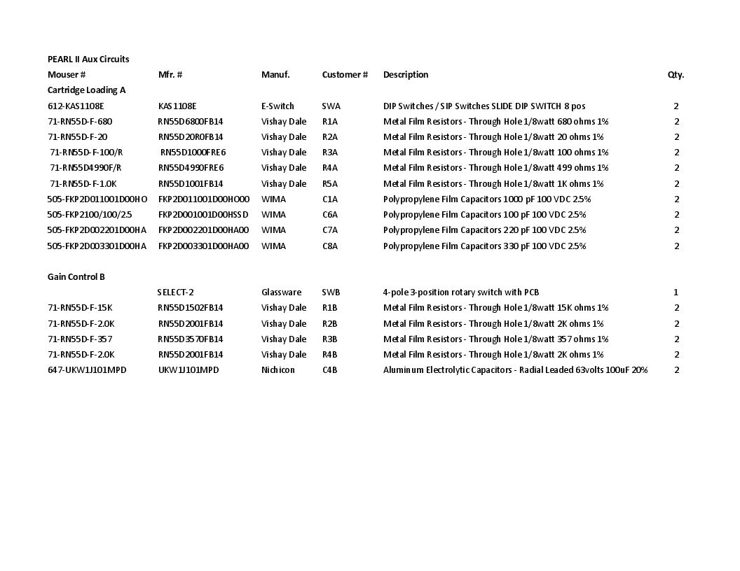

I'v included parts lists and schematics for my mods in case anyone wants to give them a try.

Very nice! I added the same switching options to mine, although I didn't add the resistor to keep R14 from going open while switching. What's the reason for the PS mods?
Wow that looks incredible. I’m super jealous.

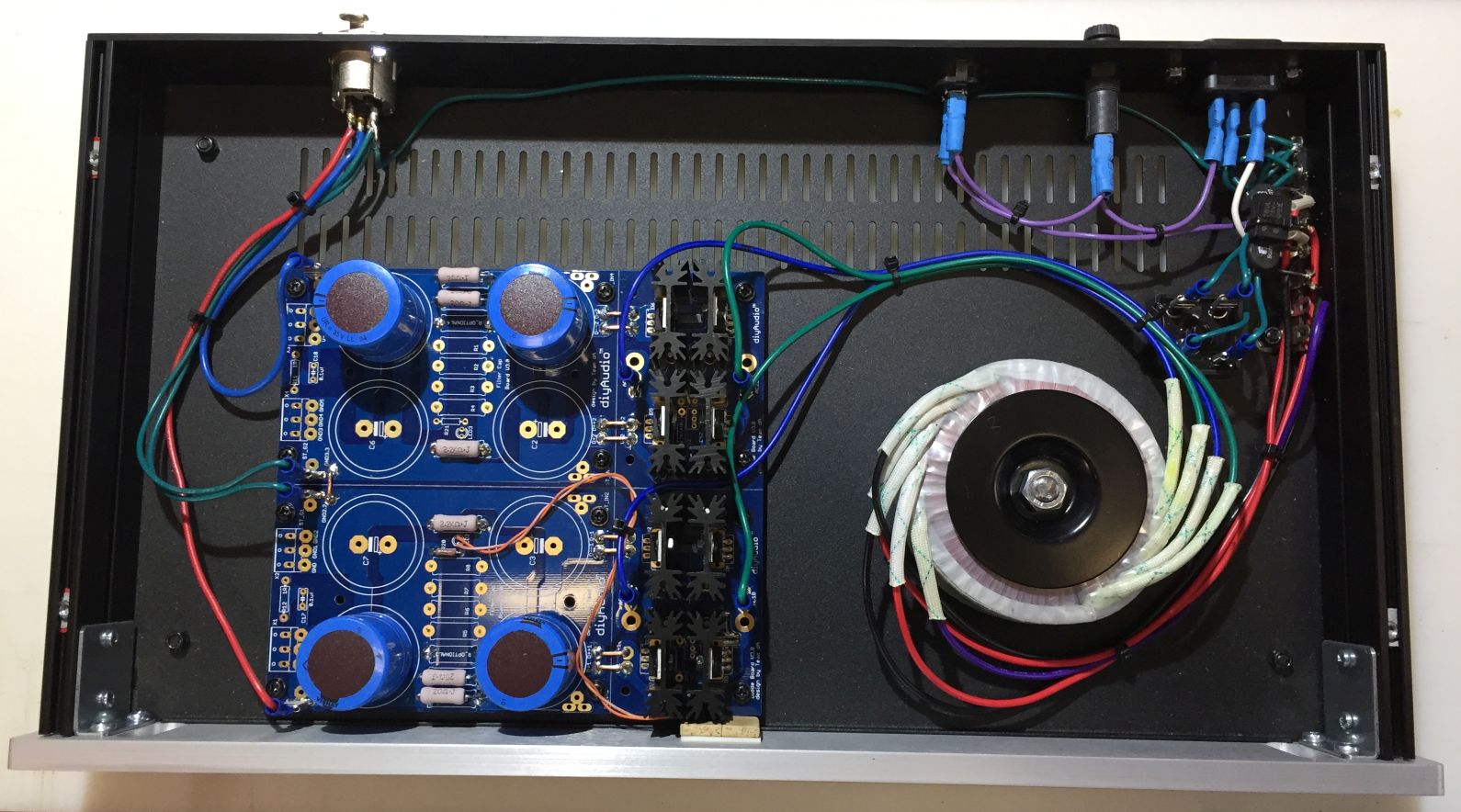

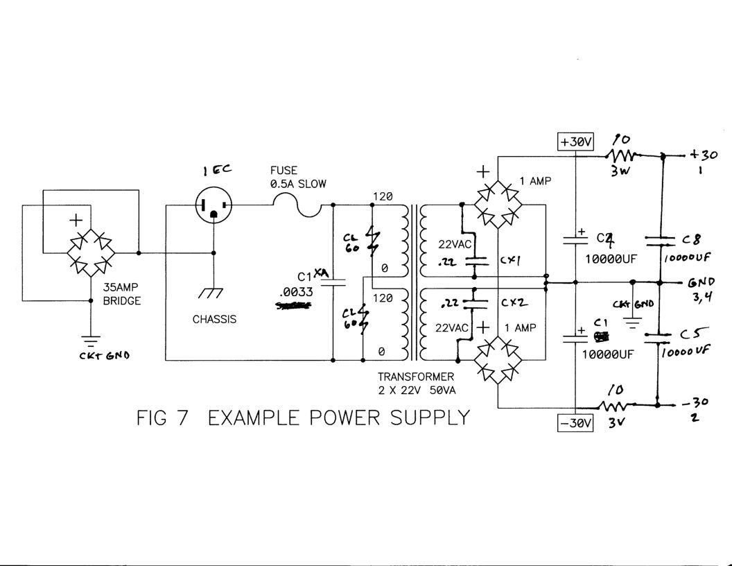

6L6 showed MUR diodes, 0.22 snubbers and CRC filtering in his primary supply design at the beginning of this forum. He also recommended replacing my original 0.47X4 (0.12R) between caps with 10 to 20 ohms between caps. I chose 20X2 (10R).
The idea is that a quieter primary supply would yield a super quiet supply downstream of the regulators on the main PCB. Given that I am accommodating a low output MC cart with a 10dB higher gain option that is at the limit of Mr. Colburn's recommendations, it seemed like a good idea.
Most often snubbers are a solution looking for a problem. If there is no ringing there is no necessity.
While the LMxxx regulators are not the quietest, i could not see any noise using them or powering the Pearl with a Jung SR.

I have R14 selectable between 300, 600, and 1K ohm and it seems to accommodate pretty much any MM or MC cartridge. I actually have to turn the gain to the middle or lower setting with a LOMC going straight into an O2 phono preamp so as not to overload it.

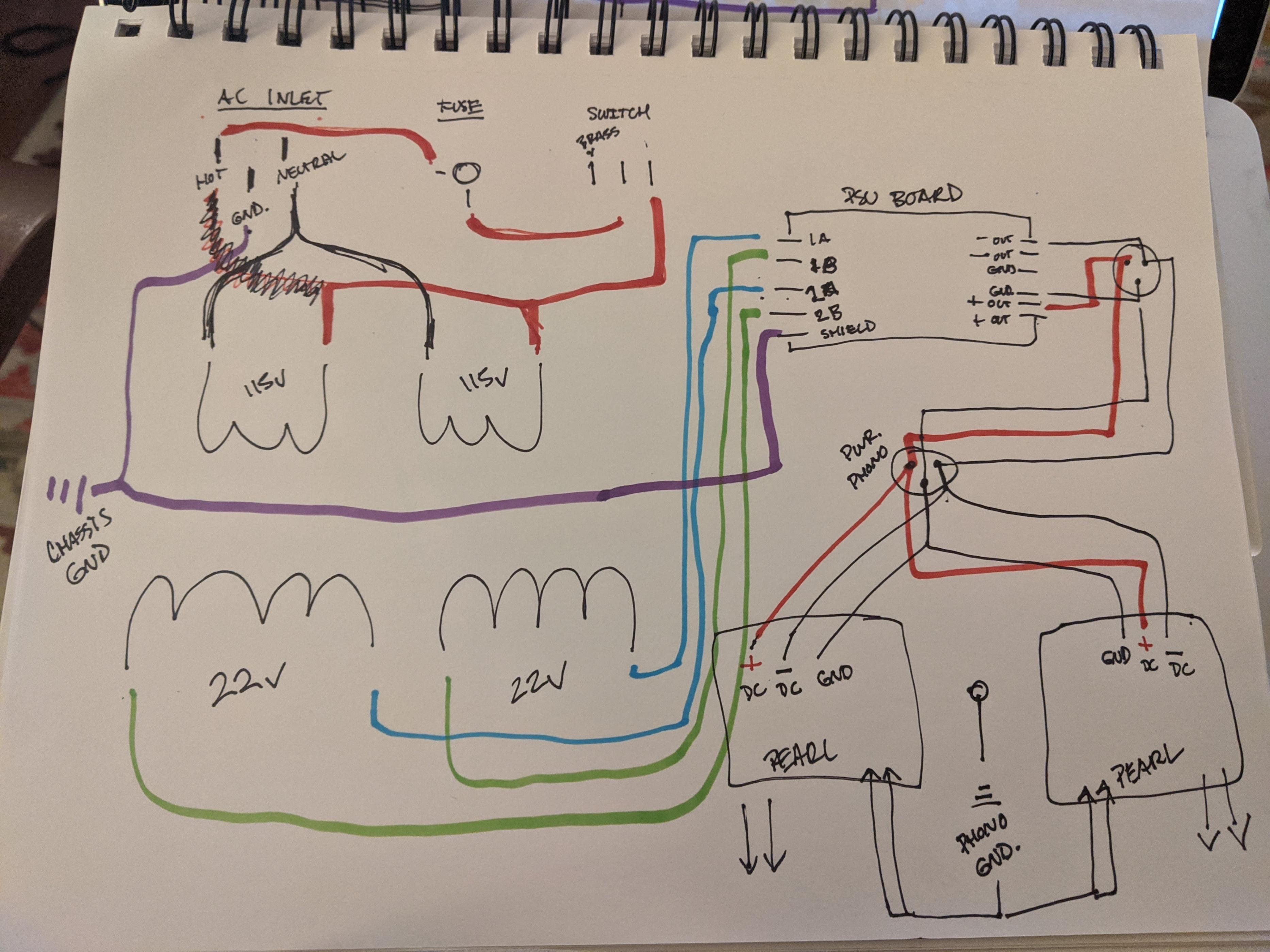

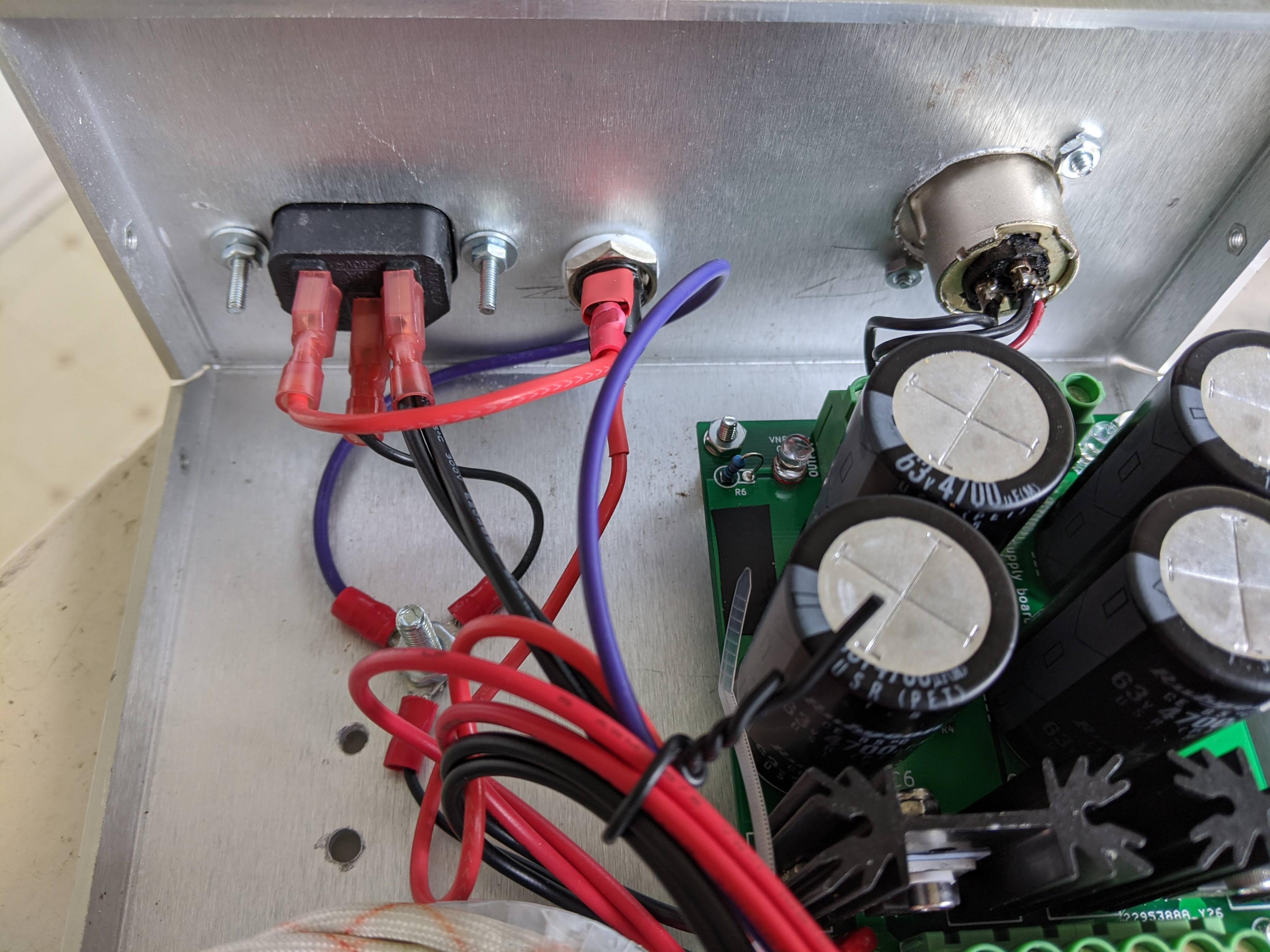

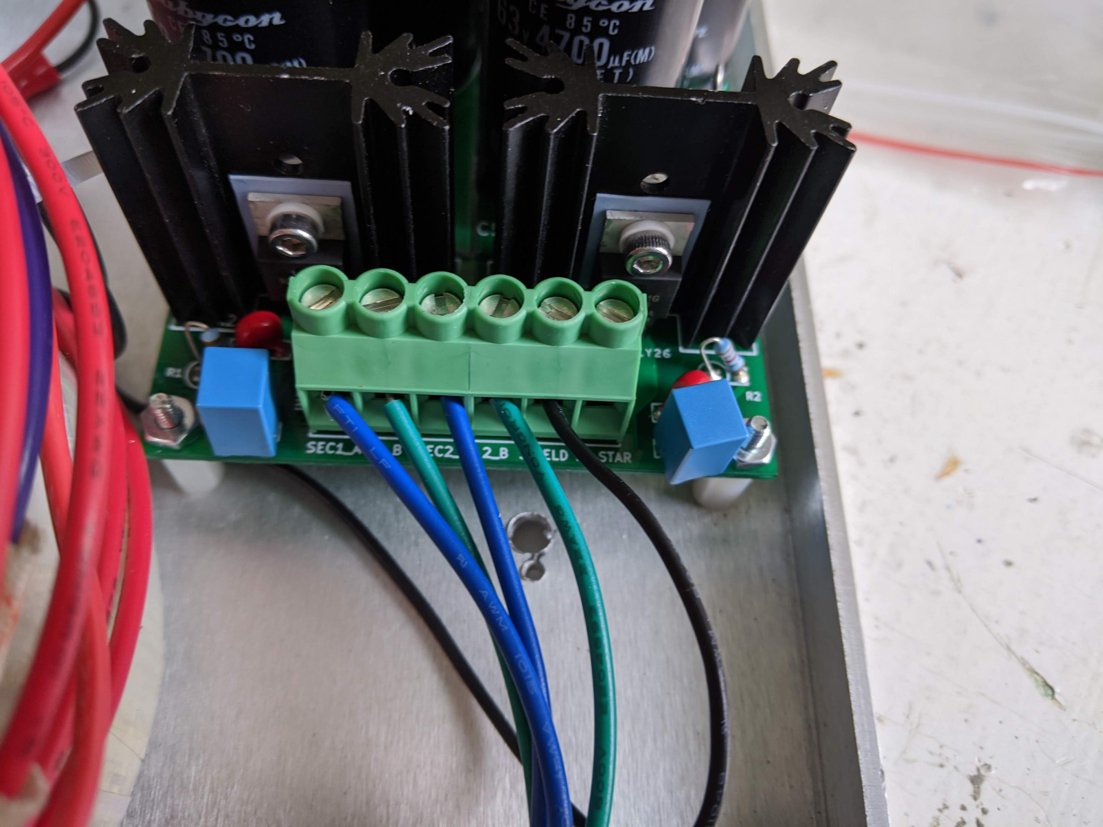

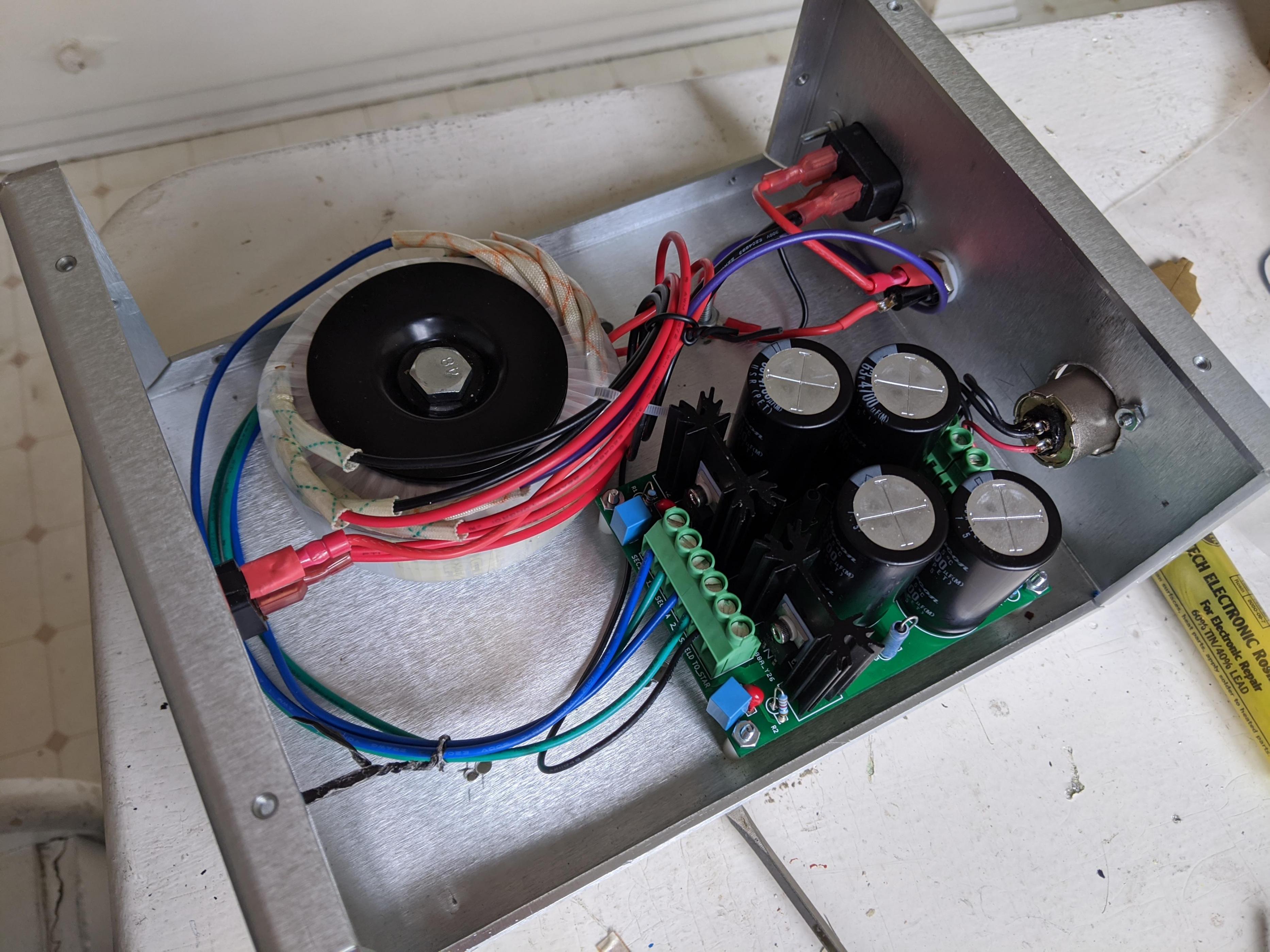

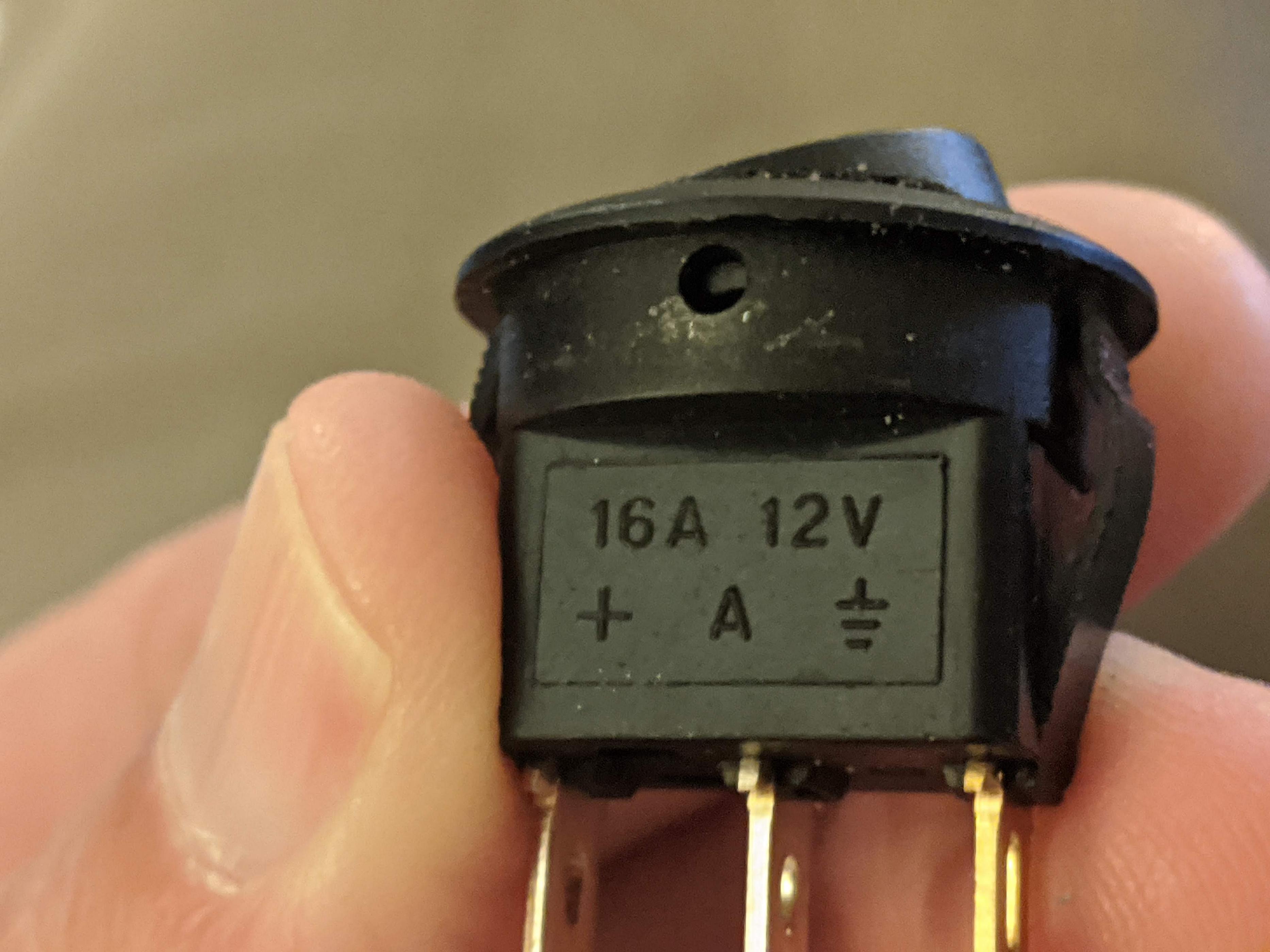

Finished wiring my power supply and upon turn on I blew the .5a fuse? Any ideas? Here's some pics of the build attached below.
