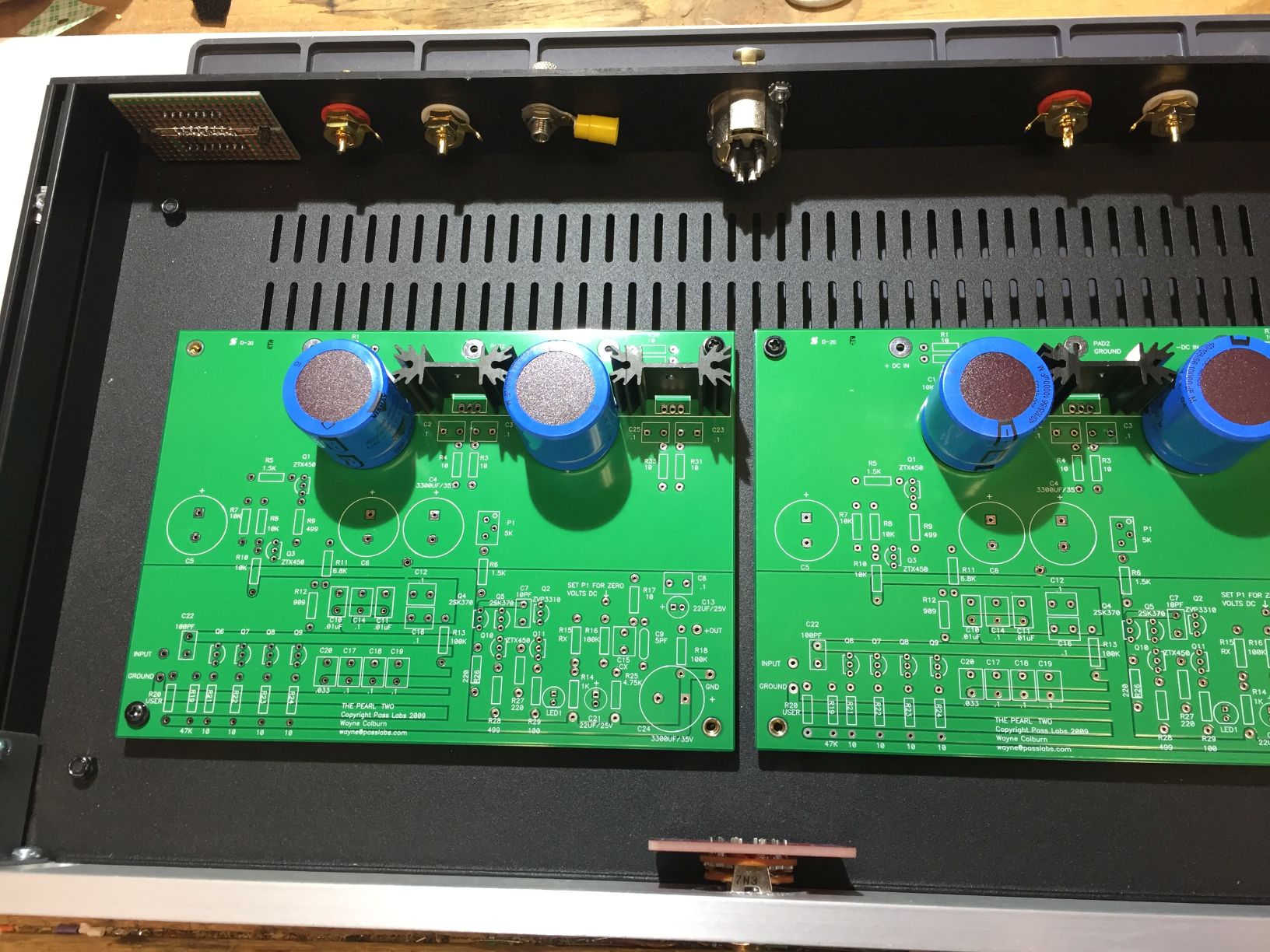

Slimline 1U with front plate printed to order to match the ACA font and central positioning.
The problem with it is the height restricts your choice of caps quite a bit. However a 5mm standoff placed between top or bottom covers and the chassis is just enough to bring top or bottom lid flush with the front face and give you the height needed to open up your options on caps.

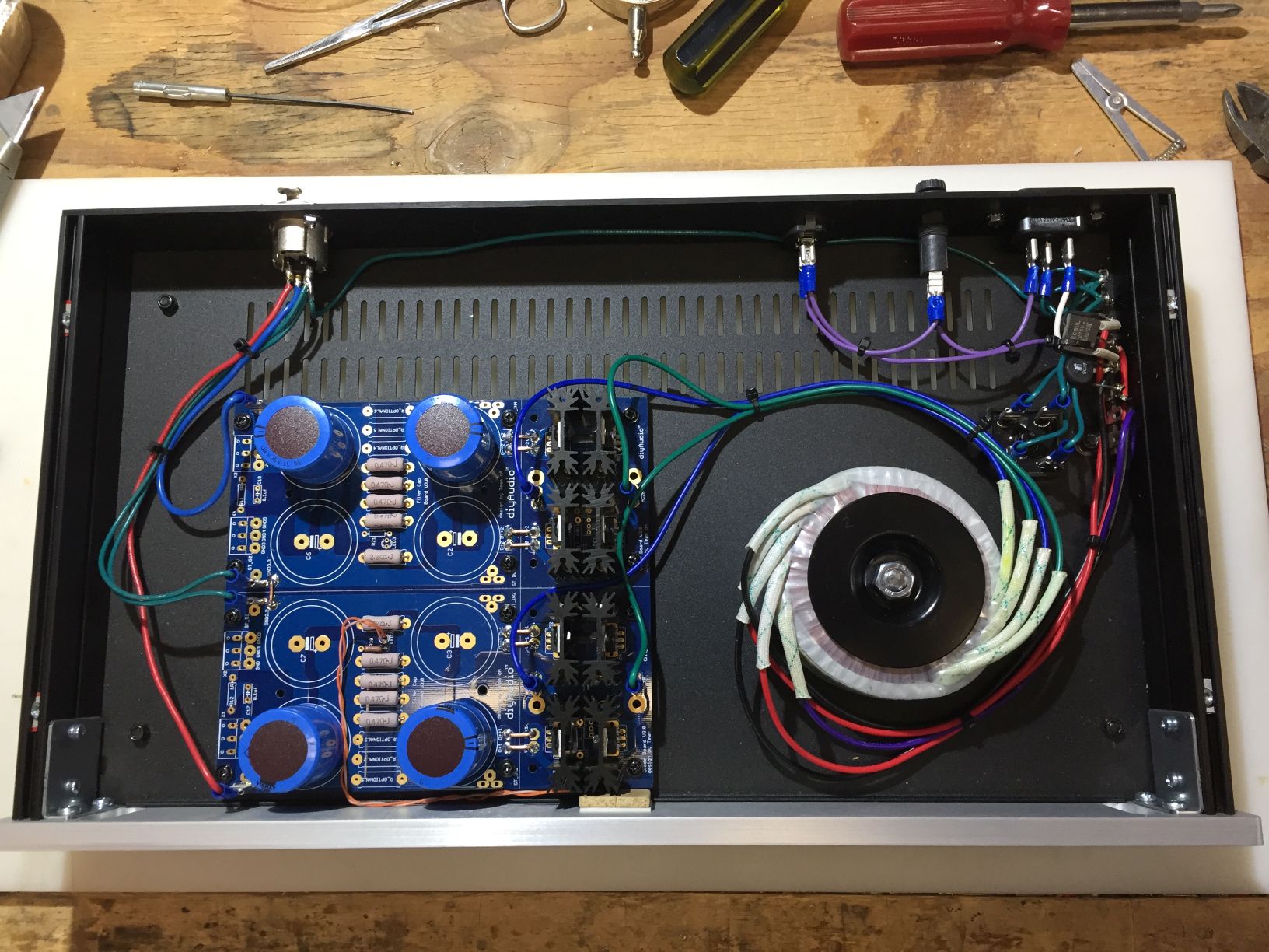

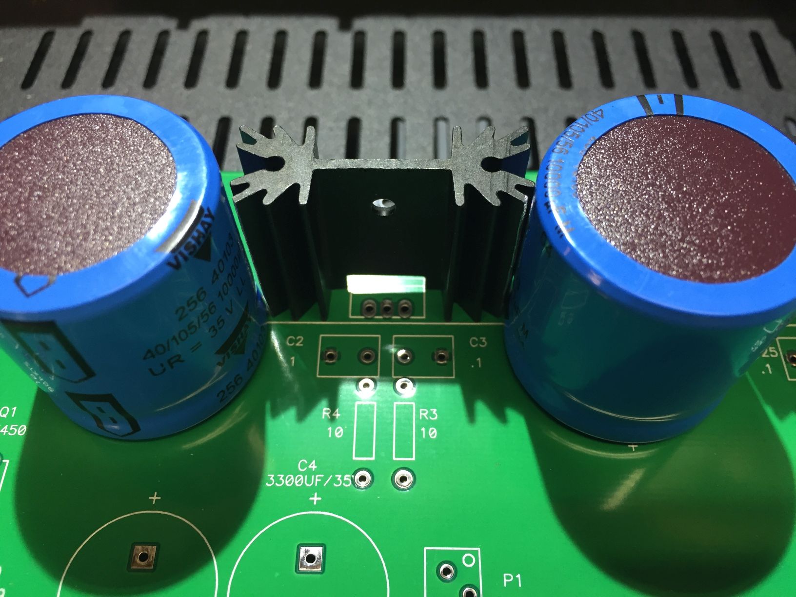

My build in progress uses two DIY store slimline 1RU chassis. I trimed the 25.4mm H regulator heat sinks just a wee bit on a bench grinder and used 30mm diameter supply caps. PCB standoffs are 4mm. Caps are Vishay 30X30 10000 MFD 35V
https://www.mouser.com/ProductDetail/594-MAL225640103E3
The 3300 MFD electrolytics are Nichicon audio grade UKW rated at 25 VDC to keep the height within limits. They are all in the circuit after the 24V regulators.
https://www.mouser.com/ProductDetail/647-UKW1E332MHD
Front panel has a 3-position gain switch using a Glass Audio Select-2.

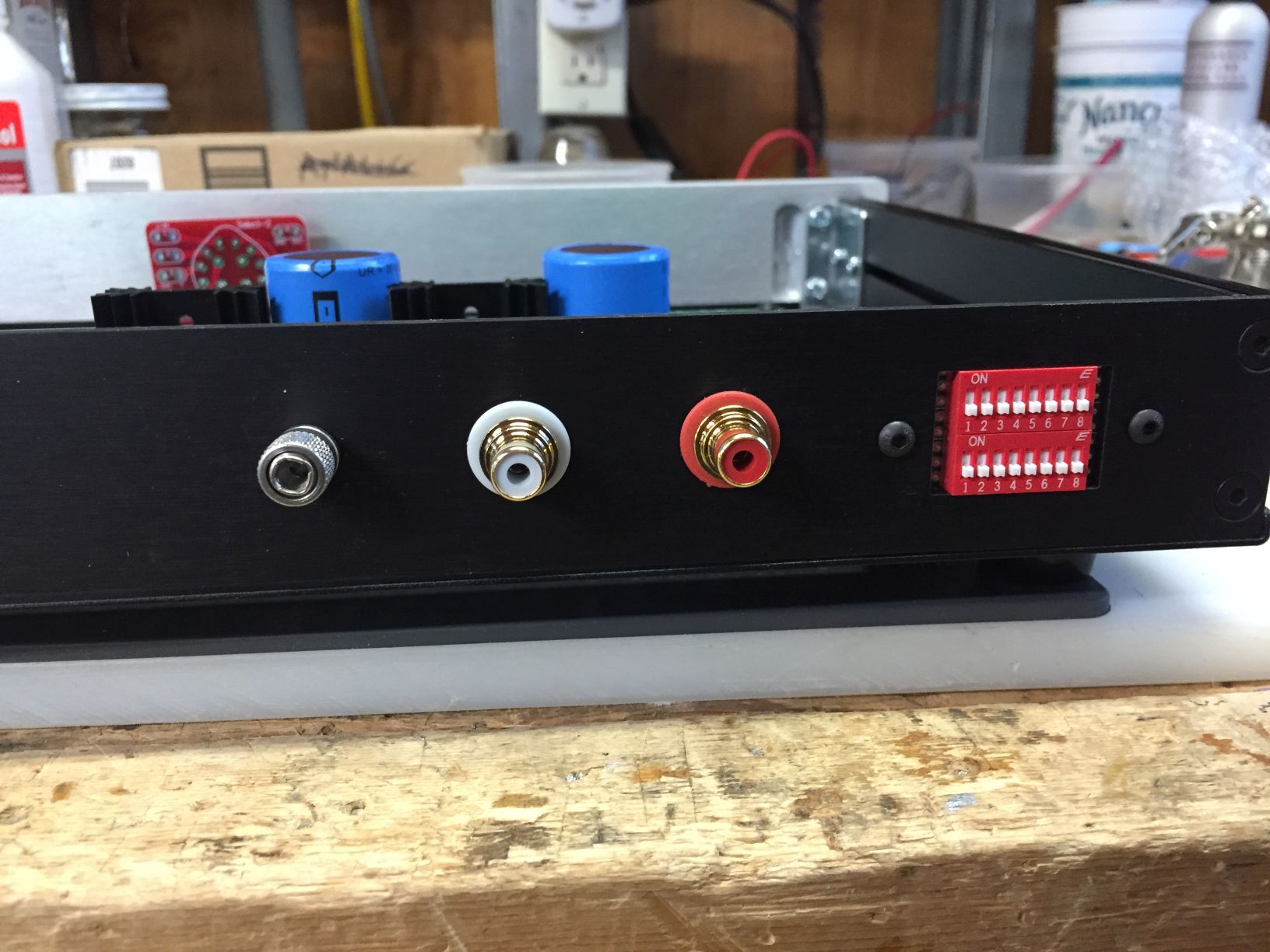

The preamp chassis was ordered with the rear panel IEC cutout to accommodate two 8-position DIP switches for cartridge loading. Perfect fit (vertically) no filing required!
DIY PSU board has the CX snubber caps and 25.4mm H heat sinks on the diodes, just because they were only 97 cents each (!) and they look cool
https://www.mouser.com/ProductDetail/532-513002B25G
And yes, that is a 50 watt Antek AS-0522 transformer, which will fit with both rubber washers in place.

As long as you're on the line, any advantages/disadvantages to using a CL60 as a chassis ground breaker instead of the bridge rectifier? I used the bridge but I am just curious. I did add some CL60s in series with the transformer primaries to reduce PS turn on current surge when charging up the 20,000 MFD per rail caps (40,000 MFD per rail if you include the main circuit boards). Wanted to keep the slo-blo fuse at 500 mA and so far, so good.

Have not stuffed the DIP switch cart loading board yet but it is next to the input jacks to keep runs minimal.
Ground post (anodizing has been removed at the mounting hole) will connect to the PCB ground planes per your previous drawing.
Interconnect cable for the XLR4 power jacks is Canare 4S8 star quad with four 16 ga conductors, wired with red plus 30V, white minus 30V and the two (lt. red and lt. wht.) "negative" conductors carrying power supply ground.
The Canare is very tight in the Neutrik shell, I had to leave out the internal strain relief. If I did not care about the style and look of the connector, I would use Neutrik NL4 speakons next time. Big & ugly but easy to wire.
Front panel Glassware Select-2 is a 4-pole 3 position switch which will allow direct insertion of 3 different values at the R14 position. I'm going to start with 1200, 1000 and 300 ohms for MM, MI and MC carts, respectively.
