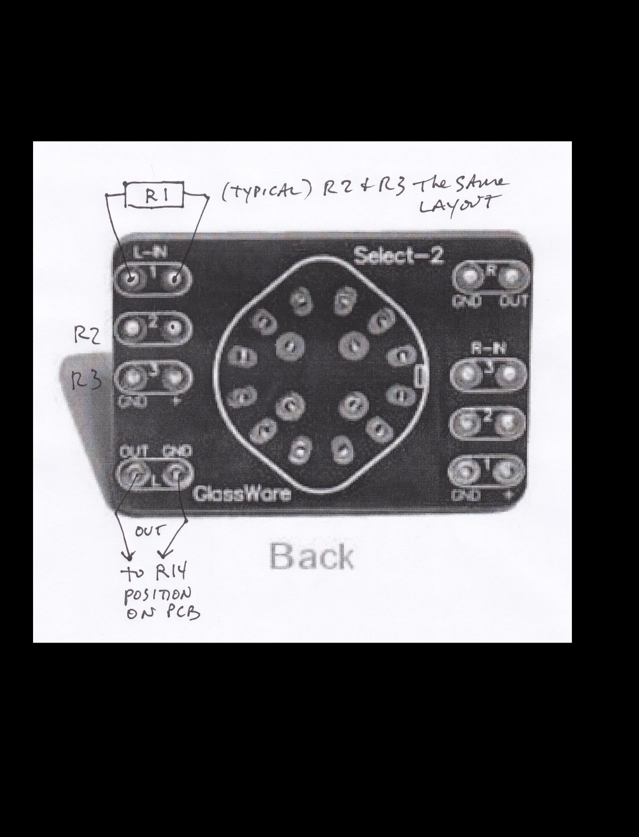

Could you post a good picture of the selector switch once you have it all wired up?
It's quite simple but perhaps a bit counter-intuitive. Select-2 is a 4 pole device. None of the grounds are common. Resistors go across the inputs (+ to gnd) and switch output (+ and gnd) goes to R14. See attached.
Since it is a "break-before-make" switch, it might be best to power the Pearl 2 down before switching gains. You definitely want to turn down the input to the down stream preamp/amp before switching gain.
Perhaps someone could weigh in on whether a momentary open at R14 under load might damage any of the Pearl's components. An alternative would be to leave some resistance on the board at the R14 location and just add resistors in parallel.
One more thing about the Select-2. I had to mill out the back side of the 10mm front panel about 6mm using a forstner bit in a drill press fitted with a drill press vise. Yhe entire body of the switch goes down into the panel.

I'm also going to calculate parallel resistances for R14 so there is never less than 2000 ohms at the R14 position during the switch contact "break" while operating my gain control. Seems the safest thing to do.
Thanks for the explanation on the Select 2. I have it in my preamp and stared at it forever and never figured out I could use it like that. I will definitely be upgrading my Pearl 2 and add some gain options and cap selection but I want to make sure I get it working first.

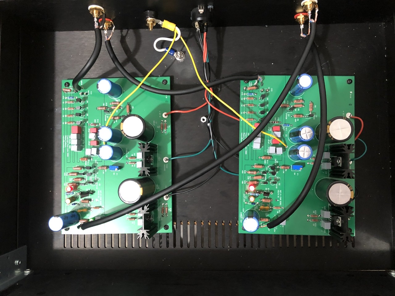

Made some progress this weekend and got the phono boards fired up. So far so good as the measurements all check out. The DC offset wanders a bit, like + - 10mv and stays a bit steadier after it warms ups.
I have it set up for a Hana SL MC cart that I don’t have yet so I can’t totally figure out if it’s working properly but I plugged it into my current TT and there were no alarming buzzes or noise To be concerned about. My current TT is notoriously noisy already, which is why I’m getting a new one, but it is surprisingly much quieter through the Pearl.
Hopefully I’ll have the rest of the pieces this week.
My case is unnecessarily large which bothers me but oh well.

Looking good so far. Which case did you go with?

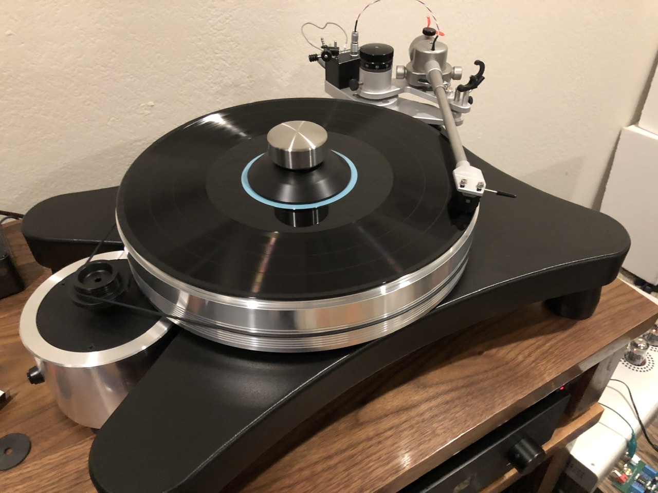

New turntable porn. It’s a VPI Prime Scout with a bunch of upgrades like a different tone arm and platter. Hana SL cartridge.
I always wondered what all the fuss about vinyl was but now that I have some proper equipment and some good pressings, I get it.
