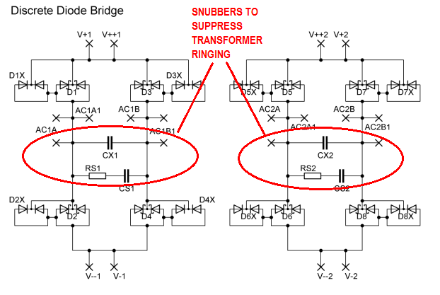

Snubber is 0.22uF. You could also put about 5 ohm in series with that cap, that will help snub better.

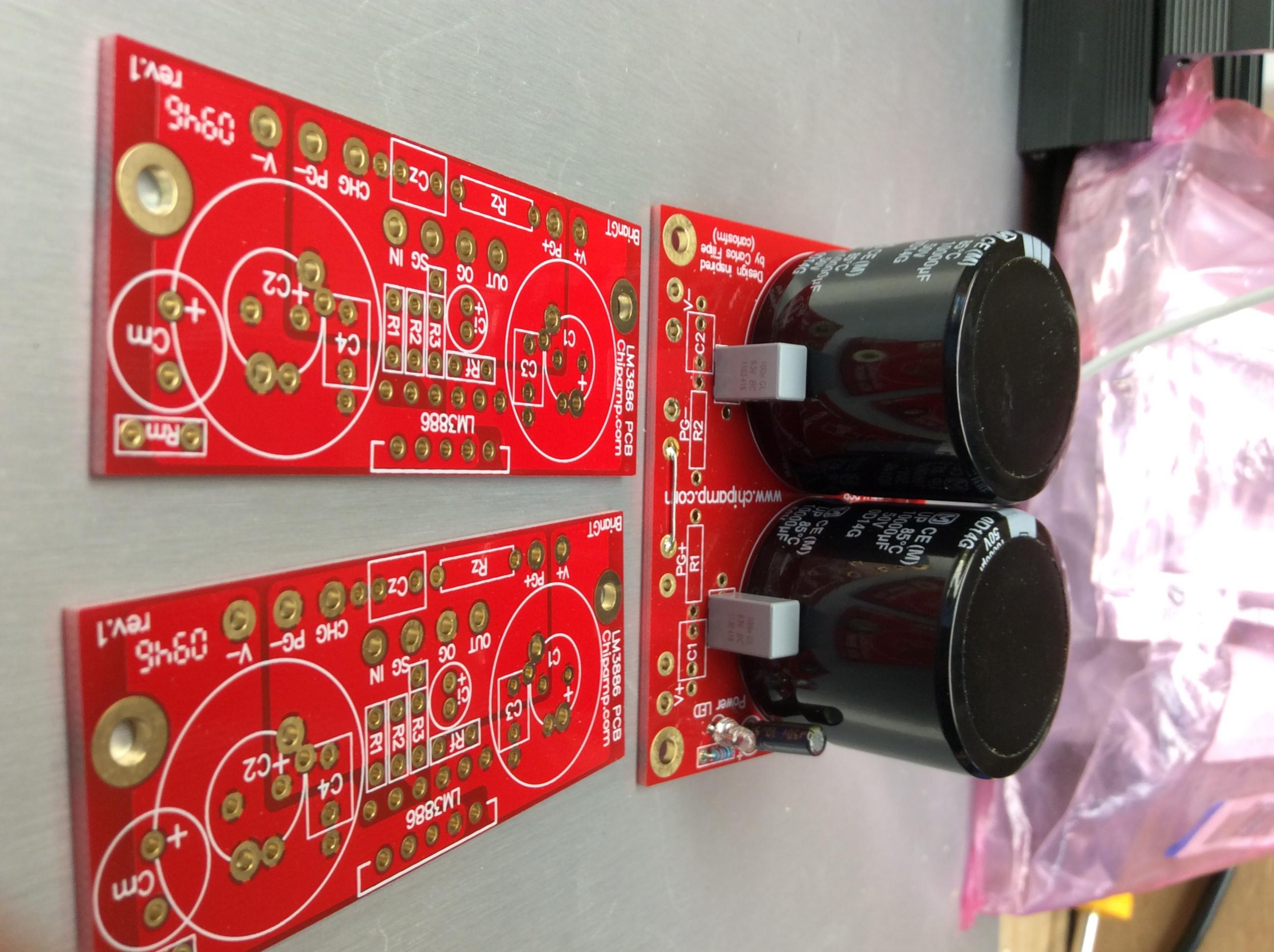

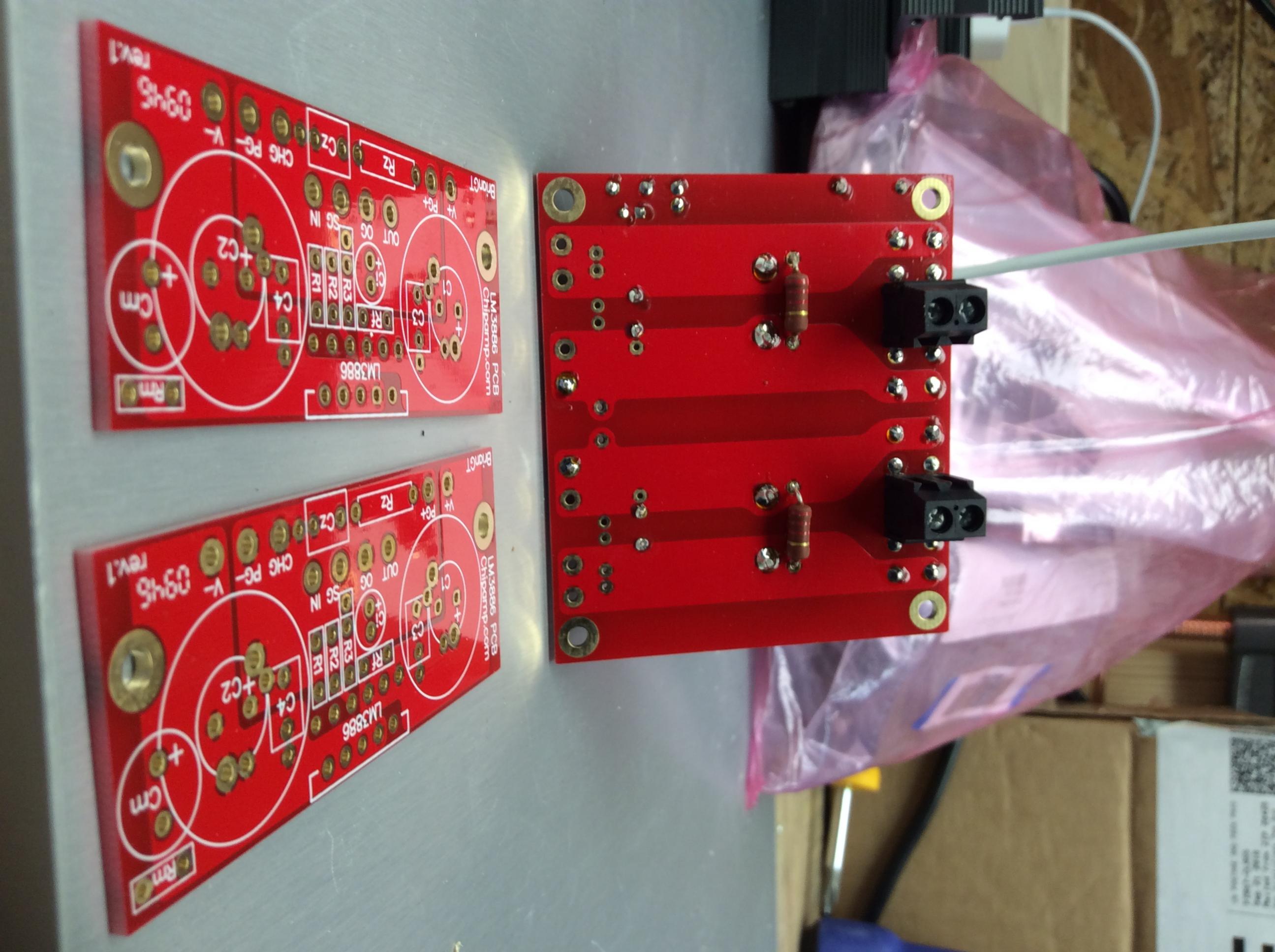

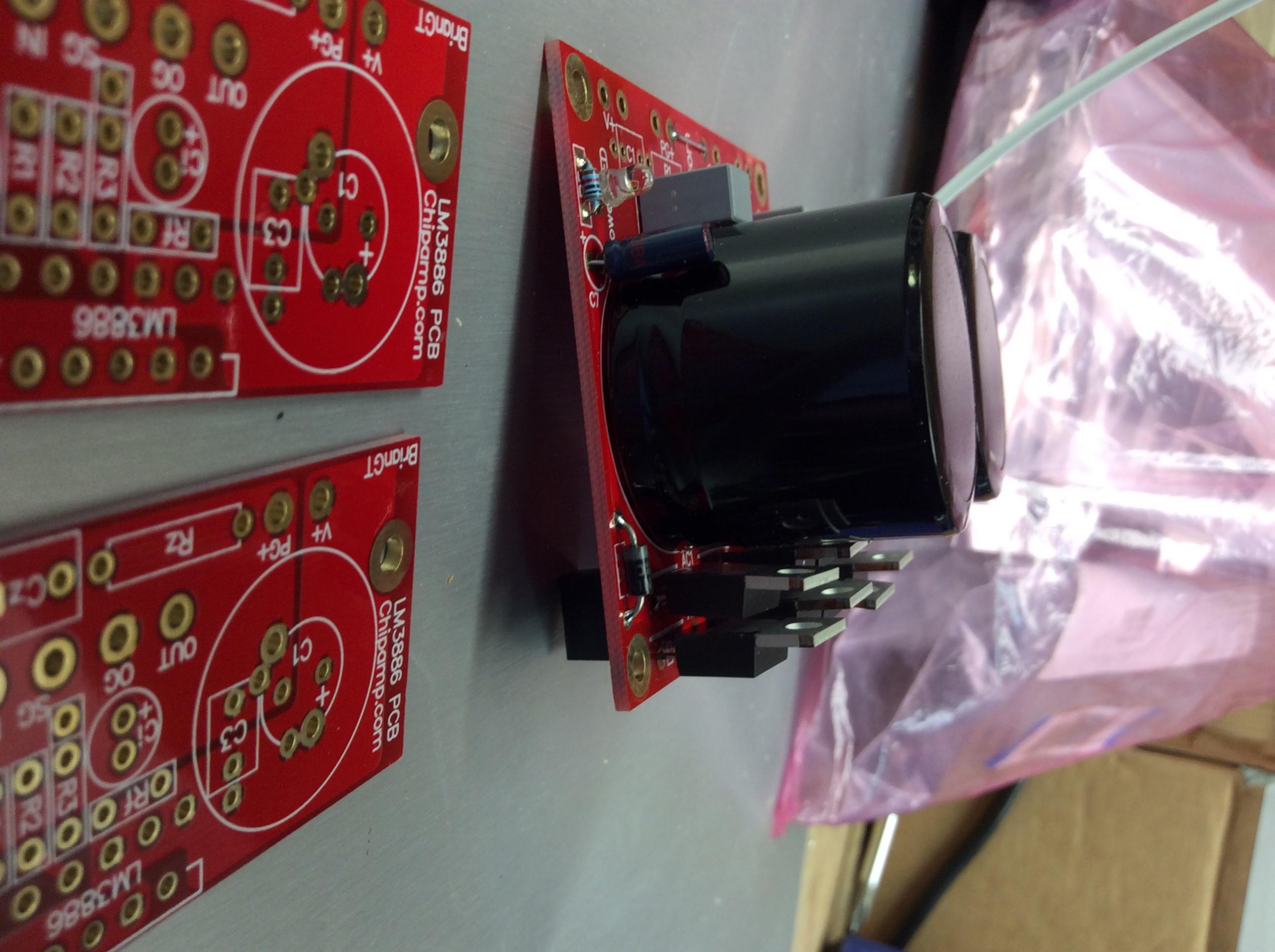

I have the Chipamp as we purchased them around the same time sooo many years ago.
I am out in my shop looking everything over and it appears to me I will only be using the small power PCB and not the other 2 boards that came with the kit. It also appears I may need to install a few more parts on it.
I am going to grab a few pictures in a second and get them attached so you folks can see what I am referring to.
I apologize the pictures are rotated.
Forgot to mention I already have the jumper in like russellc has.

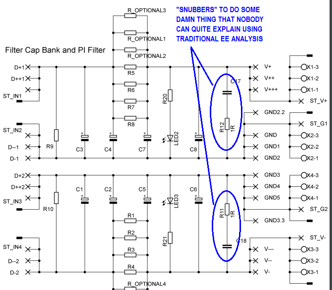

Leave R1 R2 C1 C2 open on your PSU.

What is the voltage and current rating for the snubbers?

Leave the snubbers out of the power supply. I’ve tried with and without...sounds better without.

Depends upon the leakage inductance of the transformer you're using, the judgment isn't generic.
Jack the diyAudio Universal Power Supply Board has two different ckts in two different places, and calls them both "snubbers".
In my opinion it's wise to install the red ones and omit the blue ones.
edit- I suspect the blue ones are there because one or more diyAudio members requested them ... and the board isn't universal unless it does everything that anybody ever proposed. So they're on the board, which gives you the builder the choice to populate them or not, at your discretion.
