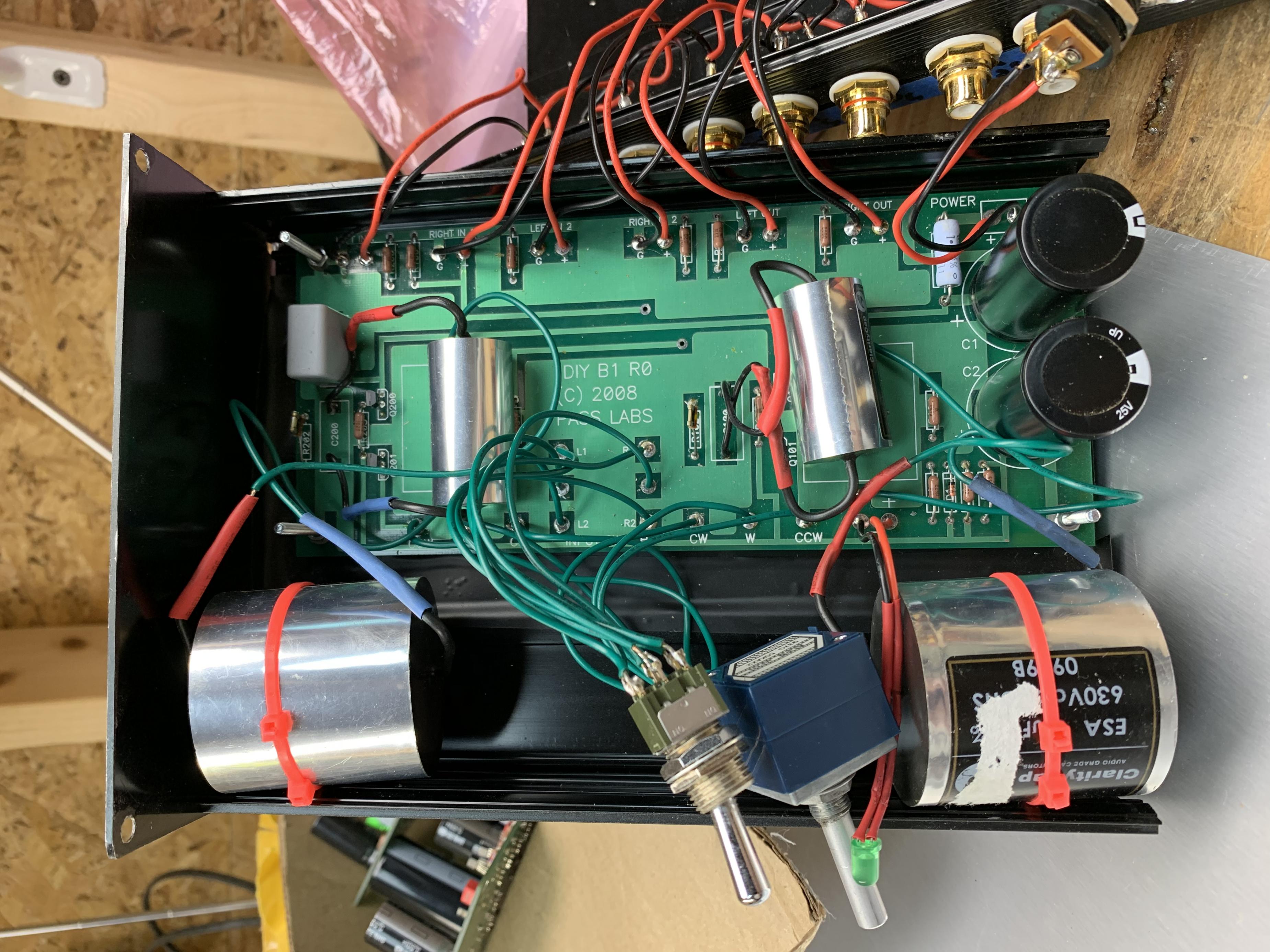

Well OK than, after only about 8 years or so it is time to get my Pearl 2 up and running.
Years ago I had the boards pretty much stuffed with the necessary components.
My plan is to house the Pearl 2 and B1 preamp (which has already been built and used) in the same enclosure with a Bill Thompson PCB to control motor speed.
So I am just looking for any changes/addition to the parts for either the Pearl boards or the Chipamp power supply.
From what I have read so far is:
C15 - Leave out ( I put a jumper in by mistake)
R15 - Jumper
C22 - Leave Out, no jumper
R20 - Leave out, no jumper
C7 - Can cause issues. Wayne after the Pearl 2 article was published recommends leaving out.
-Also the snubbers in the first post. It appears they are .22 something as I could not make out if they are micro, pico etc. I also have to really read a bit more to figure out where they are going.
-I also noticed on a picture that RussellC posted that a jumper wire was placed on the Chipamp board so I am assuming that will be needed.
- So with the Chipamp I purchased years ago which is the same as I think a lot of folks are using, the LM3886 power supply, but my question is, are the little boards that came with used at all?
My plan with this is to be able to run my TT through this and also a CD player. So with that config I believe the TT will come through the B1 - Pearl and the CD just through the B1 and out.
So are there any other components for the Pearl or Chipamp boards that I need and what is the value of the snubbers?

Snubber is 0.22uF. You could also put about 5 ohm in series with that cap, that will help snub better.
Russel used the chimp board to great effect, if I recall, so configure like his. (Can you say what post # the photo was in?)
What chipamp "little boards" are you referring to?
