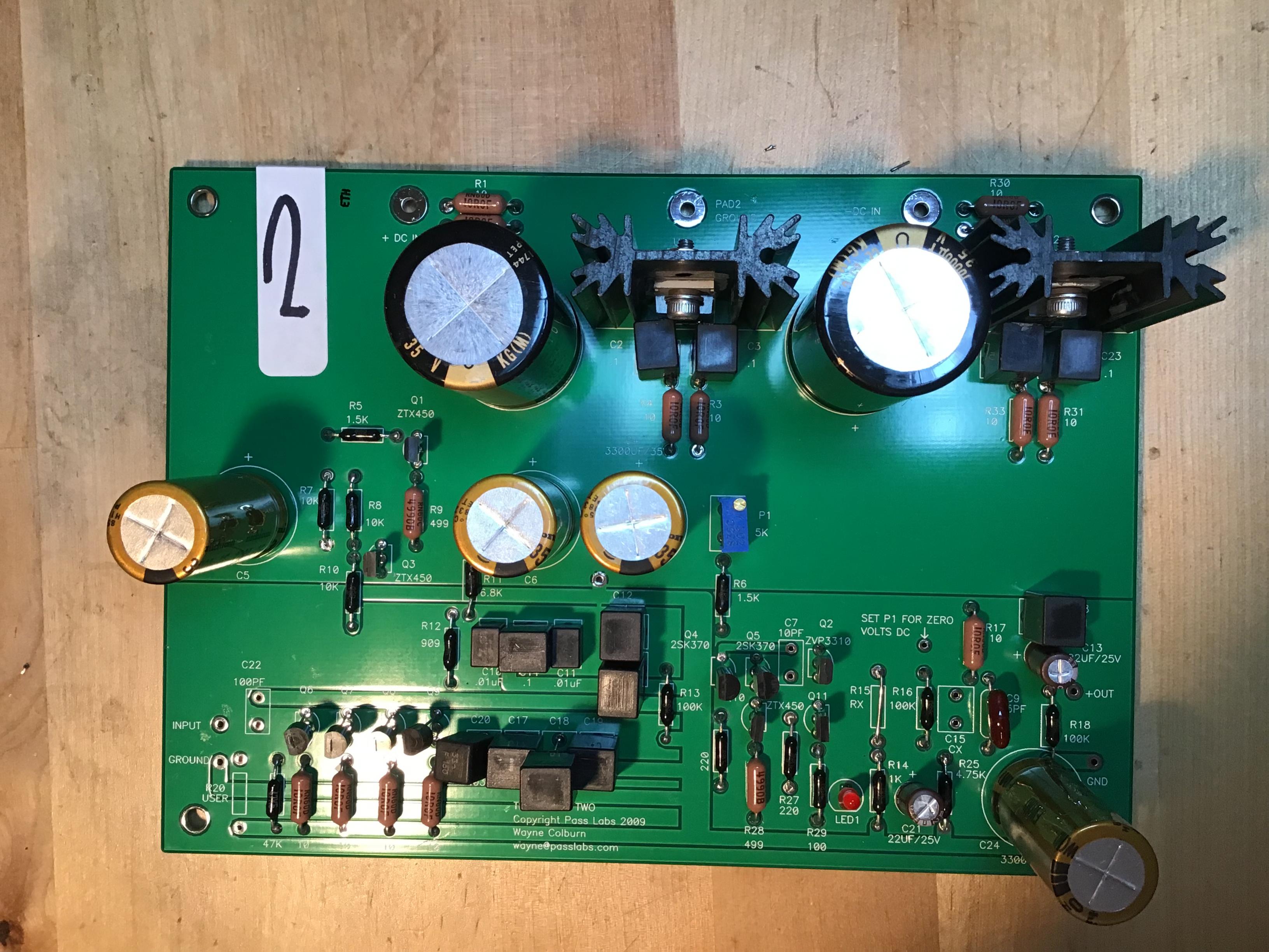

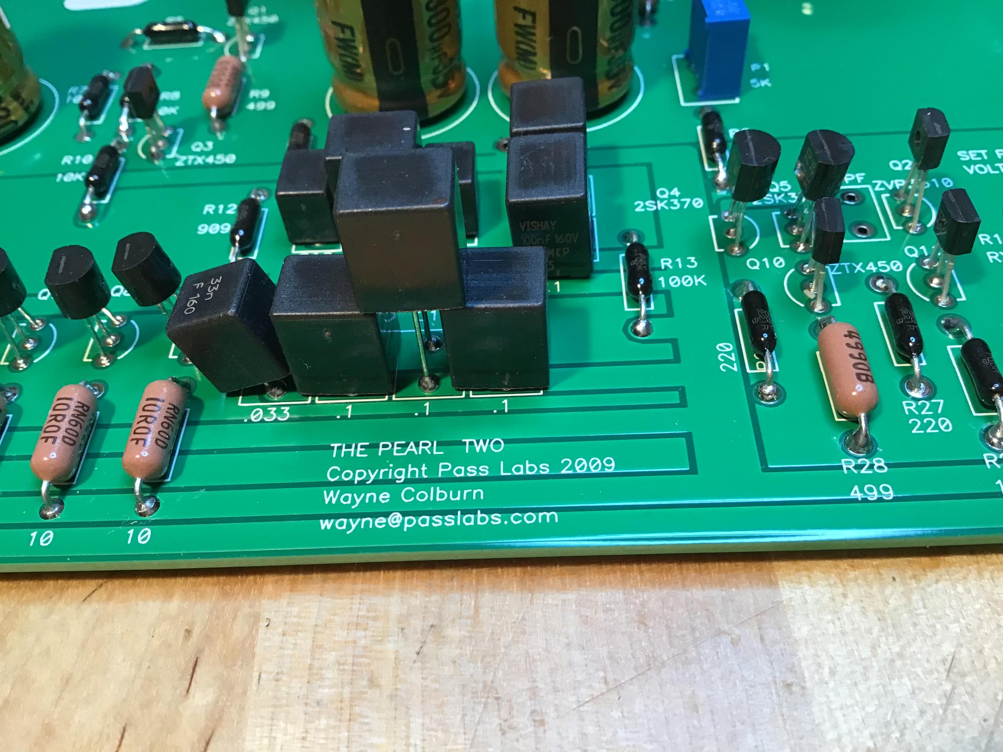

My second Pearl 2 build is nearing completion. I built the first set with the parts as recommended by the manual and ended up giving it to a friend. I built the next set using a “Formula 1” philosophy. All resistors except the 10Ω and 499Ω are 0.1% and the film capacitors are MKP 1837, which were a tight fit. The power supply has enough capacitance for a reasonably sized power amp, because, why not?
All four boards were completed without blowing a single ZVP device.
Here’s one of the boards and the capacitors trying to squeeze in:
Very nice, which make/series of resistors did you use? Also wondering why you were blowing transistors?
The ZVP3310 in the output circuit is extremely static sensitive, about half of the builders have lost one durning normal careful assembly.
I'm on that list. 🙂
I'm on that list. 🙂
McQuade, the ZVP MOSFETs used in Pearl2 have a reputation for poor ESD tolerance among diyAudio builders. Many many people have observed this and reported it on the site. When you stuff and solder them, don't be shocked if they're dead before you ever power up the board. Standard practice is to buy 3X as many as you need for the Pearl2 board(s) you're building, just so you will have enough spares to replace the dead ones again and again, until the board stops failing and starts working.
Black resistors are 1/4W 0.1% Welwyn Components / TT Electronics RC55 series brown are Dale RN60. To be homest, I got the black ones because they look really nice, look at Mouser part 66-RC55LF-D-1.0K as a random sample..
The transistor point was a cheap bragging opportunity, sorry. Having read this thread before the first build I was expecting to blow at least half of the ZVP devices as many people seemed to do due to its high static sensitivity. I was really surprised that I didn’t.
It's a common enough occurrence that you are allowed to brag a little if you didn't have any issues... 😀 😀 😀
