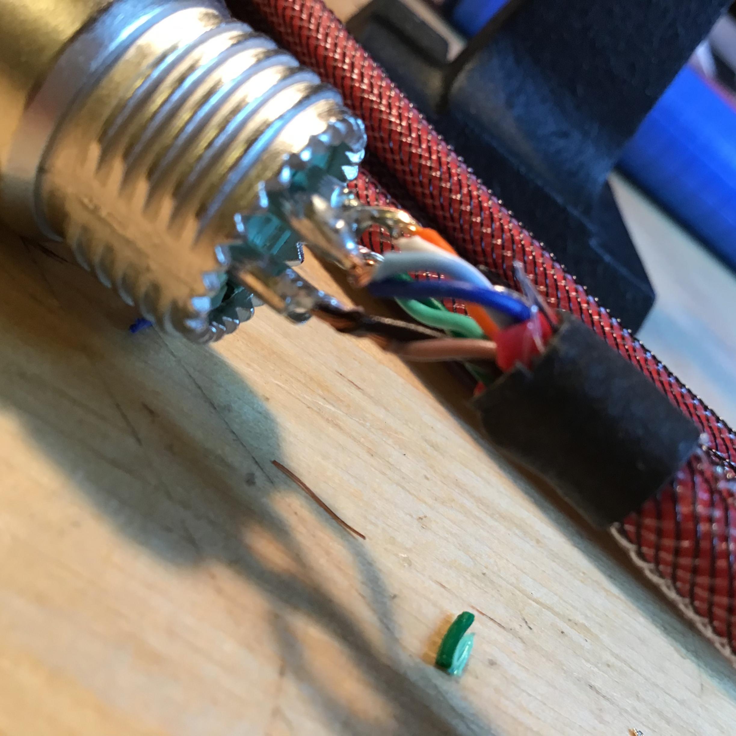

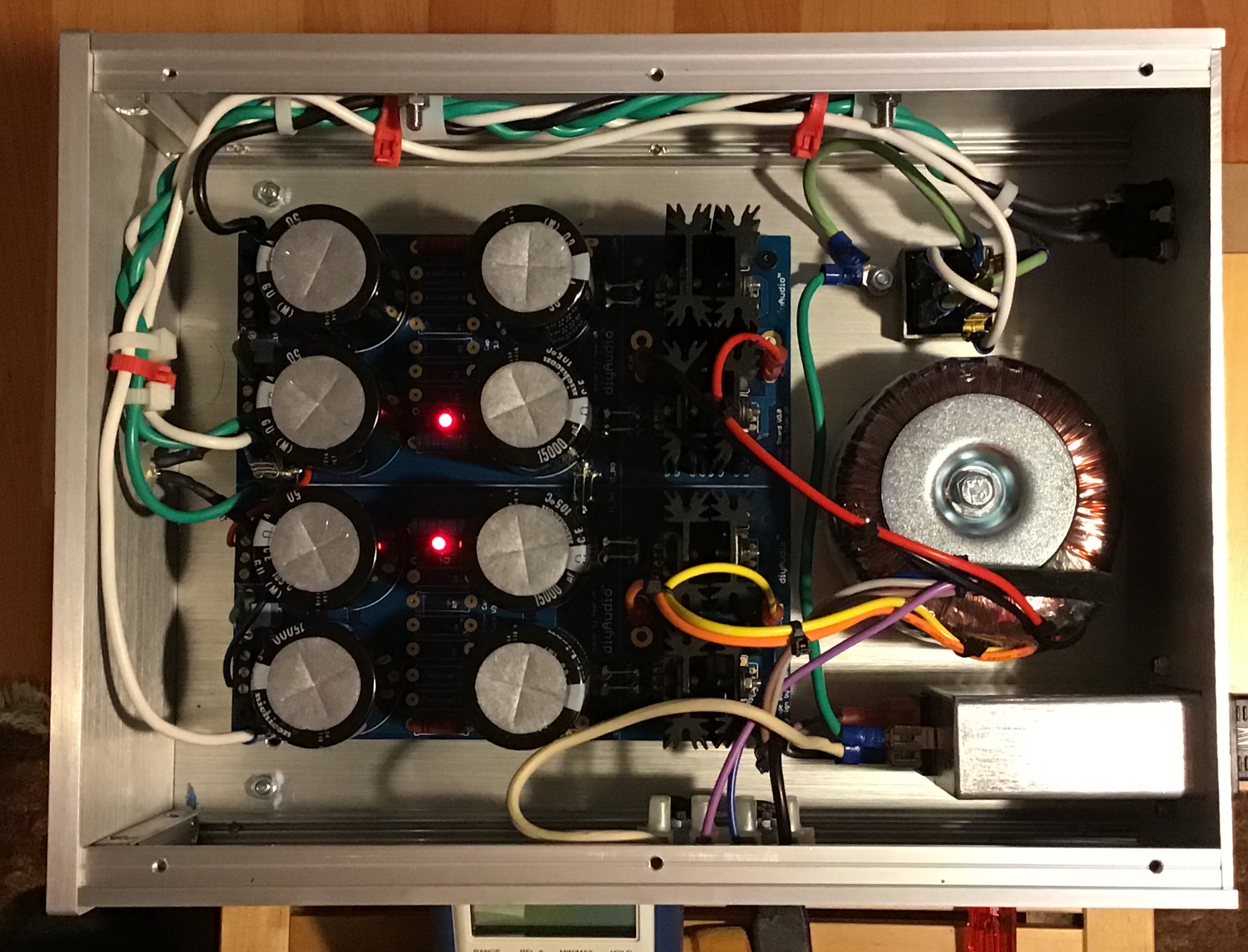

Since we are discussing power supplies, I have just completed mine. It uses the universal power supply PCB and then I went over the top with it, mostly because I had the capacitors from project that never materialized. The case is from ebay, and the seller cut the power inlet opening according to the data sheet, which really was my biggest concern about building this. I tried to locate the transformer in the l/r center of the enclosure to avoid surprises when lifting it.
The umbilical cord connector is a four conductor XLR using a CAT 5 cable, building the cord was one of the more frustrating parts of this project.
That looks great and was exactly what I was shooting for. Could I ask what Ebay vendor you got your case from? Looks perfect for the power supply.
The vendor is along1986090. The case is “Cello amplifier case” or something similar. It has “Cello” written on the face plate, but that's easily removed with a rug and some alcohol. I found the space a little constrained, if I’d do it again I’d get a slightly larger enclosure.
