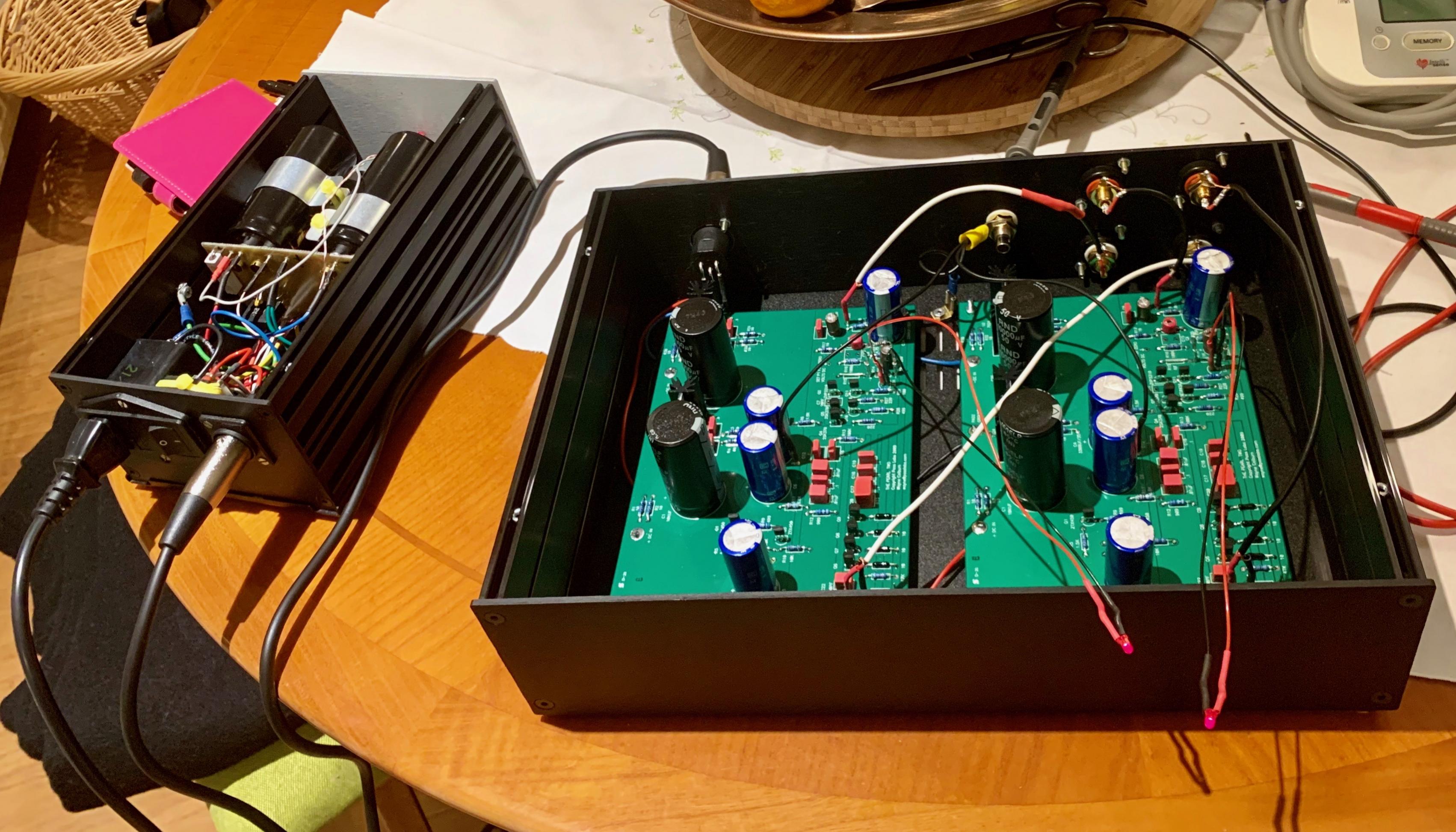

I want to thank everybody for the knowledge and tips/trics concerning building a Pearl 2.
I've built mine this month, and surprise, surprise.... it is dead quiet and worked straight out of the box! (great thanks to 6L6 for his great grounding scheme)
Now I do have some questions which I hope some of you might help me with.
Setting the DC offset is pretty hard to do, I've read that in the forums.
For me the voltage swings somewhere between -4mv and +4mv (with the lid open) I can't seem to get it to 0 exactly... (but just looking at my DMM it without it being connected to the pearl 2, it doesn't stay exactly on 0mv as well....).
Is the swing in voltage normal?

+ and - 4mv is excellent, mine tends to drift a bit. Loading a Quintet Black at 47K is your problem, it's supposed to be at around 20-50 ohms! No wonder it's rolled off.
Maybe you can put sockets in the R20 position so you can try
different loading resistor values?

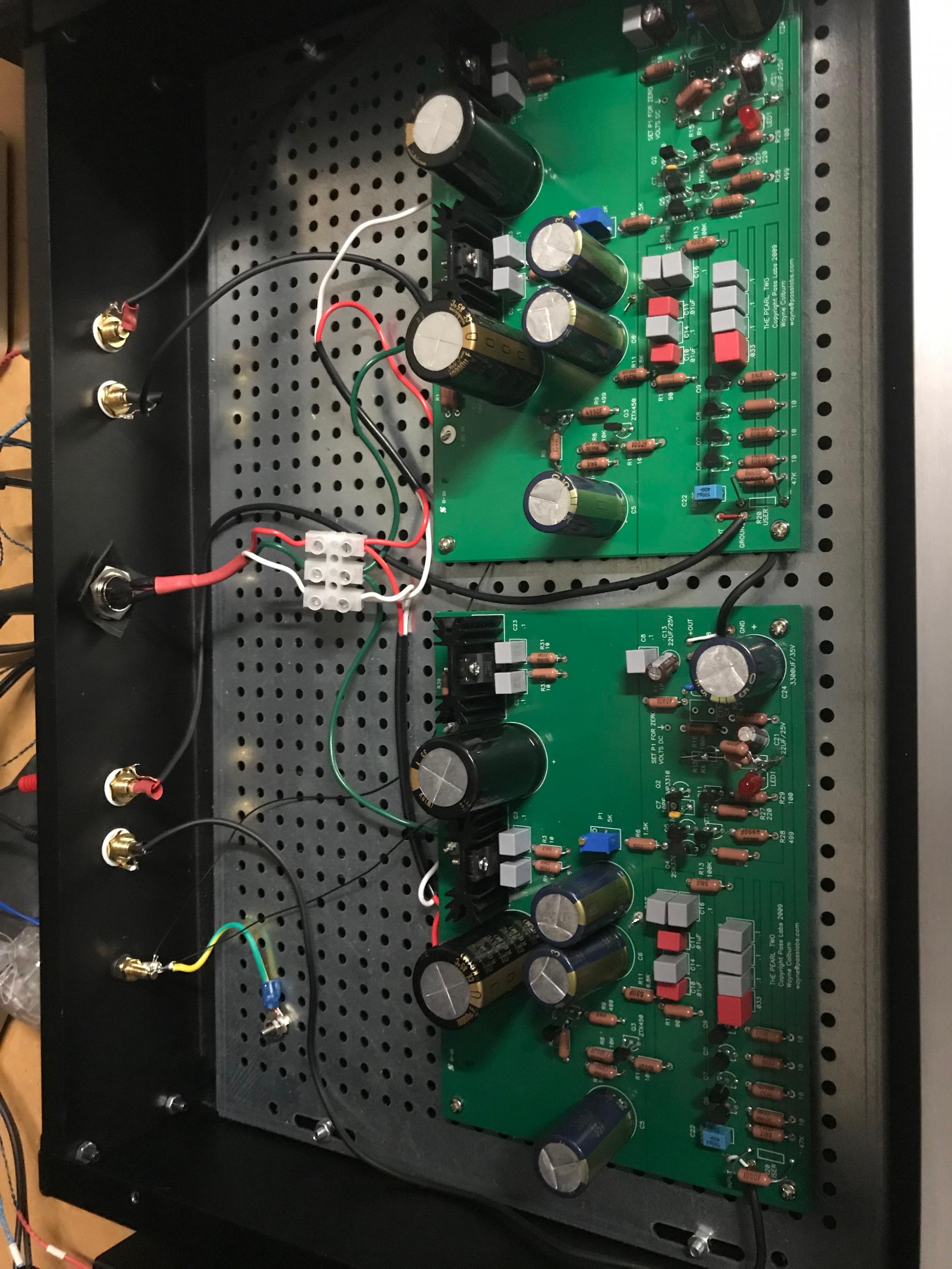

Robert, Andrew,
Your builds are looking really nice, well done! It's always great to see people having successful projects. It sounds like your grounding is quiet, so the big fight is over! Hooray!
If I may suggest a few things for lowest noise and best performance;
1) Rotate the PCBs 90deg (Andrew) and 180deg (Robert) and get the input stage close(r) to the RCA plugs. Short input leads, long output leads are quieter.
2)Run all wires as close to the chassis as possible. Remember that there is a lid to the chassis, you can run the power up and across the top and then down to the power inputs. (you don't have to, just remember there is more than one way to route things)
3) Run the center ground wires (the lone black one near the small electrolytics) under the PCB
4)The LEDs are not lights, they are a bias voltage reference for the output stage, having them on fly leads will only pick up noise.
5) When possible, attempt to have power and signal wires cross at 90deg angles.
6) Phonostages, being the most gain in a single box in the entire chain, AND having an intrinsic noise penalty due to the cartridge/input stage interface that you can't do anything about, neatness really counts in wiring. As short as comfortable, run tight to the chassis, bundled together when appropriate. Zip-ties are your friend. The Pearl can have incredibly good SNR, it's absolutely worth the effort. 😀

Thanks a lot for the replies!
Will try different resistor values asap.
6L6 I will make the modifications... (can't believe it will be even more quiet then it already is)
btw. It already is a lot more quiet then the Lehmann. The Lehmann has a lot more hiss. The Pearl 2 has some hiss if I turn the volume waaaaaaaaaaaaaay up. (I wouldn't want to listen at those volumes anyway as it might bring the whole house down)
