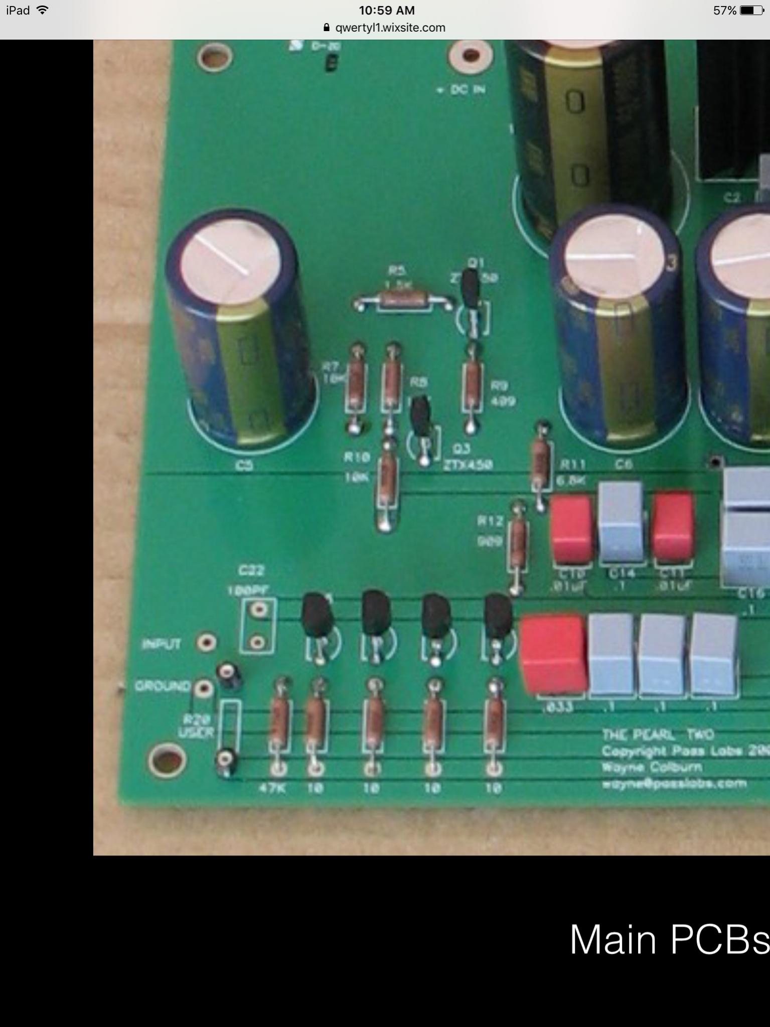

Looking through photos of the pearl 2 build I came across these terminals on R20 and was wondering if someone could tell what they are called, and if they could be used for trying different resistor values without having to solder the resistors to the board. Thanks
Andrew
